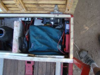

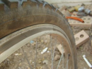

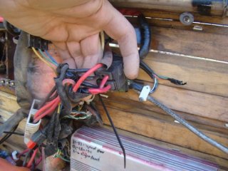

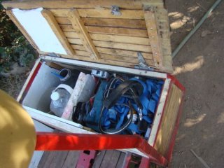

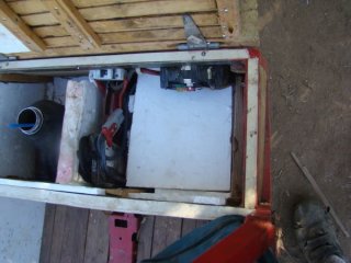

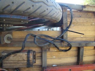

EDIT: (November 2018): Built the wooden cargo pod enclosure that's been "planned" for quite a long time now.
