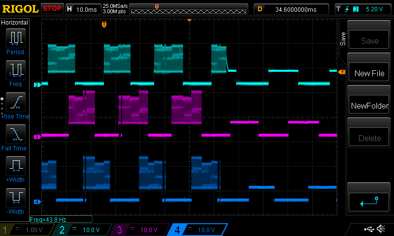

The left half of the screen is when the motor is being driven and the pwm waveform is being picked up by the hall wires and superimposed while the halls are pulled high. The right side is after releasing the throttle and the motor coasts to a stop.
Much cleaner after adding an rc filter. According to the asi software this retarded the hall signal by about 2 electrical degrees when spinning at top speed. The motor ran a bit smoother and did not trigger hall faults in the controller. But it is still a bit rough. Possibly from the funkiness from the hall on the blue trace. I might try carefully resoldering the broken leg of the original hall and installing it. At least the halls are super easy to access.
i had the same problem with the halls on a cyclone 3000w motor. but i saw those 'false' triggers as on the blue plot on the last picture on all hall signals and on each low-high and high-low transition.
what i think happens is that the halls triggers also on the metal of the rotor lamination between the magnets. but didn't investigate further for now. i might look at this more in the future.

Wow, that's an amazing amount of noise. But most of it is above the logic threshold level so may not necessarily cause a problem. Most controllers have a RC filter on the hall signal inputs. If the halls are toggling more than once per cycle, this will definitely cause issues. The alignment of the sensors vs. the magnets can sometimes cause unwanted triggering. There are different sensor sensitivities available too. You might want ones that take a higher flux to operate.
I replaced the genuine honeywell hall that was giving the false triggers with the original. It sounds a bit better but still a bit rough. Not sure why selecting "hall start sensorless run" in the asi software makes no difference.
I tried on a vesc and it seemed to be fine. Still rough on halls at high speeds in foc but not surprising that positional accuracy with interpolated halls is not quite good enough.
More importantly it runs fine at high speed with halls in 6 step mode. Now to sell the motor :)
