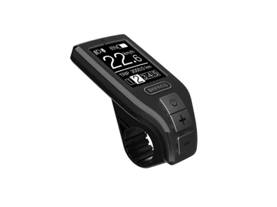

Anyone have the skinny on compatible M600 displays? My impression from reading the Luna support thread for the X1 is the DP C240 was the only compatible display.
https://electricbike.com/forum/forum/kn ... o-fs-ebike
Display is a special display that works only with this bike, no other display will work for it. It uses CAN communication so it will not work with any BBSxx / Ultra series display.
However, I've seen an alternate display on alibaba referred to as DPC-23 or DP 230.CAN:
Also, FLX has a larger color display (appears to be a DPC-18 variant with CAN communication) referred to as "G3 Special Edition Display" but specs say it's only compatible with their special edition bikes.
https://flx.bike/products/lcd-display-dz-multi
There are also specific versions of the DPC240 tied to serial number and/or class. Seems like display compatibility is tied to firmware? I suppose it's also possible the display feeds the controller some pre-programmed settings like max speed?
