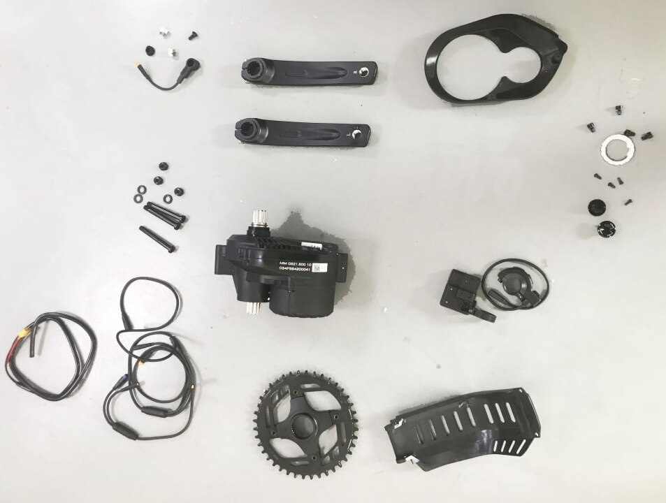

Since the chainring is connected to the motor and not the crank itself like with non-electric ISIS cranks what other spider options are out there?
The standard Bafang spider allows for a 53mm chainline according to the specifications PDF, if you flip the chainring you should land at 58(-ish) mm if drawing is to scale. The fat bike spider for the Ultra may fit and will probably yield a 75mm chainline so my question is how to get to a 65mm chainline with the G521?

Shown here is my spider and sprocket on the M600. Not sure if this helps but the center of the green oval on the photo attached shows the land on the spider that will not be making contact with the sproket if you move the sproket outbound to the other side of the spider. If the sprocket was moved outbound so its on the outside of the spider instead of the inside it may only change the chain line by a little less than 3/16". If the land in the spider extrution is not touching the sprocket it may not be the end of the world (might but not sure) but this drive is a 4 hole pattern. Also one option may be to stick spacers and longer bolts between the sprocket and the spider kind of like the old school front multi ring crank sets. Hope this helps........wayne
spider and sprocket.jpg (55.66 KiB) Viewed 3689 times
Thank you for taking the time to take a photo go your bike, Wayne!
Yep, 3/16" is pretty much what I guessed as well by measuring the PDF on my screen (hence my assumption of getting to 58mm based on the 53mm stated in the PDF). It didn't occur the me that by flipping the ring you loose contact with the "land" as you showed in your photo, so yeah that might be an issue, especially with the forces generated by a motor. Can anyone comment on if the "land" is an integral part of the structural connection between the spider and the BCD chainring (which are standard bike parts)?
Those forces are also is why also why I would be hesitant to put a very long (7-8mm more) spacer/bolt combo onto the spider because I am afraid the sheer forces would be too much four the four tiny (8mm?) bolts.
What bold circle diameter does your chainring have? It looks like 104mm but I could be wrong.
This is the spider for the Ultra motor, here one can see the the spider for the Bafang Max (predecessor of M600), it looks like they spider has the same mount as the Ultra.
Can you confirm yours has the same mount, and can you or anyone else tell me if this proprietary or a standard item that might be found somewhere else?
By the way, the Q-factor of the motor with the standard cranks is 177mm according to this (German link!). There also are a few renderings of the battery system they sell with the motor.

Yes ElTopo the Bold CD is 104mm. And yes I feel the land on spider touches the sprocket. I did not take it all apart but sliding in a piece of .005" mylar I felt resistance between the sprocket and the land. Pretty sure two two surfaces touch. Hope this helps.Also not sure if you have the option of going with some kind of an IGH as some manufactures have offset rear cogs that can be flipped to change up your chain line. I know on my Sturmey Archer 3 speed for my fat tire bike I was able to improve chain line by flipping rear cog. There is also a new IGH maker out there https://kindernay.com/products/, unique to this IGH is the ability to switch the hub itself into extra laced shells so you can have one hub that services many wheel sets. ......wayne

I am still trying to find out how one could get a 65mm chainline with the G521, (instead the 75mm chainline you get with Bafang's fat bike spider from the G510 - assuming it fits onto the G521) can anyone shed some light onto this?

On another note, it may be that there are different versions of wiring for these motors. Can anyone comment on where the following might go?
* Does the display go to Port 1?
* Does the throttle go on the ebrake wiring harness?
* Does the ebrake wiring harness go to Port 2?
* Does the speed sensor go to Port 3?
Any help would be appreciated, don't want to go live till I've confirmed, the connectors are specific, but some common (display and throttle).
Note: the ebrake connections are the round 3-prong common to Bafang so you can swap out the supplied brake levers with integrated sensors to the more common magnetic versions that plug into Bafang for better brakes.
