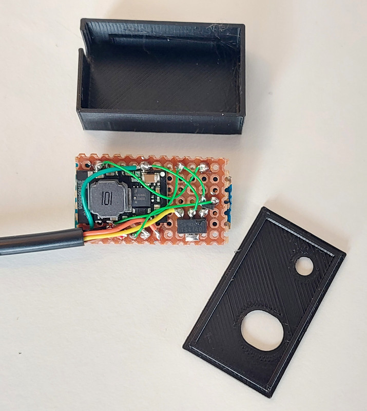

Hello.
In my spare time I made a few corrections in mine board (v2.1) and a new "adaptive" PCB for nRF.
maybe someone will come in handy. :]
More on wiki: https://github.com/woojak/TSDZ2-Interna ... Board/wiki
I still have a question about nRF programming.
is the given programming sequence is good?
1. STLink - TSDZ2_wireless-bootloader_with_sd-v0.9.0.hex
2.nRF Connect - TSDZ2_wireless-bootloader_ota_update-v0.9.0.zip
3.nRF Connect - TSDZ2_wireless_ota_update-v0.7.0.zip
question 2: nRF will show up in bt devices if is not connected to TSDZ2?
follows this procedure and after uploading, the device does not show up in the BT list or in the list in the APP; /
greetings
TSDZ2 Internal Wireles Board - Github repo. and Wiki for TSDZ2 EBike wireless controller project.
