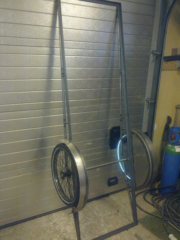

I have a few mods planned for the cargobike this year, and the trike will be retiered and hopefully replaced with a similar winterquad. I am expecting a buildthread for that late summer/early autumn.
The changes I will try on the cargobike are related to the wire steering. I will try larger endwheels to see how much that improves the overall steeringfeel.
Personally I am happy with it and close to 3000km riding gets you used to it i guess, but people that test it says that it is slightly odd at first.
Some of it comes down to the far back ridingposition and the long wheelbase, but also the slight flex in the system plays a role.
With larger endwheels any unwanted movements in the frame/supports/wire have lower impact.
I am shooting for doubling the effective torquearm from the turningaxle.
The idea is to try to 3dprint the endwheels out of nylon.
The worst part is that this mod will need a new front cowl, and possibly changing the first wireguiderollers under the cowl.

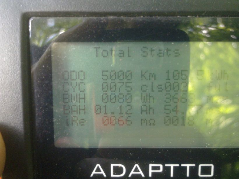

Maybe two weeks ago, I decided to mount the PAS sensor I had removed back last year when I realized the adaptto brake signal didnt have prio over the PAS.
That was fixed in later firmwares, so I decided it was time to mount the PAS and upgrade firmware. The reflash went well, but since then I have had stange problems with the controller hesitating at higher throttle input.
Have had a bunch of ideas on what the problem could be, and it has been frustrating to suddenly have a much less functional bike.
Howerver the break came yesterday when I probably found the entirety of the problem. It lies within the new adaptto firmware + my magura throttle.
At higher throttle values, the controller sometimes loses the thottlesignal briefly. It could not be seen when calibrating throttle limits, but could be seen when doing a twist calibration.
The values start from 0 and then go up as the throttle is turned. At anything around or above 3000, the signal flickered to 0.
This is most likely the problem with the hesitations I have had at higher throttle inputs. Apperently, the newer firmwares needs a resistor to cause a small current draw over the throttle, moreso than the older firmwares.
Because I did not install any resistor when I built the bike, and it worked perfectly with the magura 5k pot throttle up until the firmware upgrade.
As soon as I have a resistor in place, things will likely be back to normal.
Bike is up to 4400kms now, the rear wheel has been working well after retightening of the spokes. No clicketyclick sounds with wheel rotation.

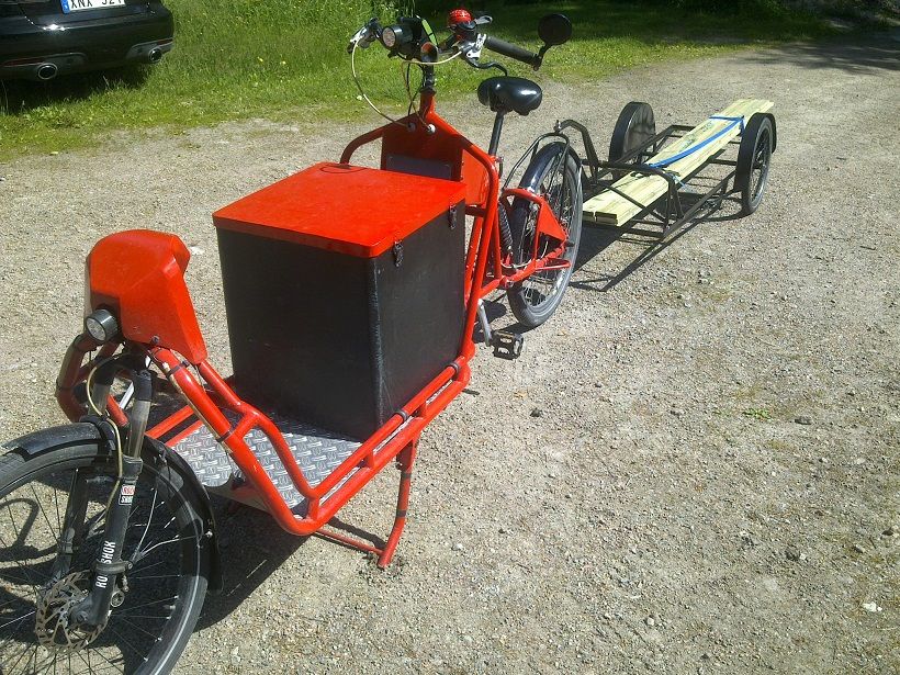

I am building a simple unsuspended multipurpose trailer for the cargobike.
The wheels (20" 48spoke) are salvaged from my upright tilttrike. The wheels sit on 20mm axle steel welded into a 25x3mm pipe as "rear axle".
The cargoarea will be made of pressure treated planks, and measures 2m x 0,6m.
Total width is around 0,75m, which is pretty common among commercial pull trailers.
Now and then I go and buy steel or aluminum piping. Unless I bring the big cartrailer I cant get the uncut 6m lengths home.
Getting the trailer involves some driving back and forth, so most often I ask them to cut them in 3, and I just take the material in my car.
Have occatianally taken some 2m material on the side of the cargobike aswell, but it involves padding and alot of strapping.
With this biketrailer I will be able to fetch pipes that are only cut once, to 3m.
Ontop of that, it will be easy to move bulky items shorter distances.
I will not be transporting very heavy loads on the trailer, as it has no brakesystem.
Its almost always a question about the stuff being too big, rather than too heavy.
The trailer will probably not be used super often, but will be good to have when the occation arises.
I plan to make the pulling mechanism foldable backwards, so that I can put the trailer standing against a wall in the bicycle storage where I live.

Today was a milestone in terms of distance travelled! 5000km of riding.
Also a pic from last week when i fetched the pressure treated wood for the trailer. with the trailer :)
Since then I have fetched aluminum piping aswell.
I am not 100% happy with how the biketrailer handles. Sure it is very direction stable, but the attachmentpoint moves backwards and forwards when the rear wheel works its suspension.
I would say the angle from the rear swing pivot point to the trailer connection is maybe 40 degrees from the horizontal.
You can feel the struggle in the whole structure when the bike forces the trailer to make fast acceleration/decellerations when going over bumps. On flat roads its very smooth.
I was debating where to attach the trailer for a long time, and considered the saddle bar but went with this anyway to keep it more simple,
and avoid having to make a big arch of the trailerarm to counteract wheel movement and trailer to bike angle.
It is not bad enough to affect the usability much, but I have to drive with more sense and planning, and not just bumrush speedbumps etc.
Maybe ill further modify this build for the better, but its not the highest priority as the basic function now exist.
