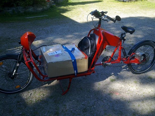

Sorry I forgot to mention in my previous post that the bike looks great. I wish I had the skills to copy a lot of what you did.
One thing I haven't seen mentioned is your terrain. I've never been to Sweden, but it seems like flat roads would be hard to find, or do they follow the topography and are curvy to keep the elevation near constant? Changing elevation is a big hit to wh/km.
If you can get the info for inclusion in Miles' motor comparison spreadsheet for the 120 Pro, then we can determine your optimum gearing. Does your system get speed from the controller or a hall signal, or from a sensor on the wheel? If you can get it without the chain on that would be perfect. The needed info is:
1. No load current at 2 different rpm. If you make one of them the rpm of your typical cruising speed, that will make things event easier to analyse.
2. Actual Kv. I know they say it's 45rpm/volt, but actual is better because it gives you actual torque per amp.
3. Phase-to-phase resistance of the motor. Simply put a low constant current through one phase and out another, and measure the voltage drop. It's too low to measure with a common multimeter. eg My version 1.0 Revolt 120 is 27mOhms. It seems like I remember that they fit more copper on the Pro, so yours may be even lower.
This info is more important for the 120, because the larger stator and thicker laminations make the iron core losses a key component of the analysis, since you're running at so much greater than hubmotor rpm.
John

As of now I use the motors signals for speed in the adaptto, so speedreading with just motor spinning is available.
Noload at the 2 different rpms should also be easy to get. Dont have a rpm measure tool, but could easily buy one or figure the rpm from the adaptto.
Do I get the KV just by going full throttle and then divide with the voltage, (with field weakening set to 0) or is it more to it?
How would you suggest the current through a phase measurement? I dont have access to a variable powersource.
Should it be measured from where the controller is connected? Thats also ~1metre of 8gauge wire to the motor, one way.

Wheazel wrote:As of now I use the motors signals for speed in the adaptto, so speedreading with just motor spinning is available. Noload at the 2 different rpms should also be easy to get. Dont have a rpm measure tool, but could easily buy one or figure the rpm from the adaptto.
Perfect, just use the speed from the Adaptto to calculate rpm, and measure the current. If you do 2 extra no load current measurements with the chain attached, then I think you can get to a breakout of the windage of your wheel from the chain and bearing losses.
Wheazel wrote:Do I get the KV just by going full throttle and then divide with the voltage, (with field weakening set to 0) or is it more to it?
Yes, that's it.
Wheazel wrote:How would you suggest the current through a phase measurement? I dont have access to a variable powersource. Should it be measured from where the controller is connected? Thats also ~1metre of 8gauge wire to the motor, one way.
I use a battery and a light bulb that's of similar wattage as the battery voltage to get close to an amp of current. If you disconnect your motor from the controller to be safe there's no kind of loop, then you could use your main pack and a 75W lightbulb as the resistor, which will give you a nice stable current. Here are instructions I copied from someone:

Thank you kindly! I will see what I can come up with. Hard to come by lightbulbs these days, as they are banned, but there will probably be one laying around somewhere.

Did the easy tests until I have sorted the equipment to test phase resistance.
It was hard to get a reading from the adaptto display for current consumption, so I went 5minutes with speedlimit at my regular cruisingspeed. ~41km/h
Consumption 0,28Ah. Should be 0,28*12 for a consumption of ~3,36A
Next I did the wot, but didnt want to go as long and heat up the motor, so I went 2minutes. Consumption 0,20Ah. Should be 0,20*30 for a pretty dead on 6A wot noload.
The display shows ~80km/h at full throttle noload with a batteryvoltage of ~67V (This is also hard to get a good reading from as it tends to jump) and a speedratio of 61,6mm/pole.
Maybe I have to splice the connections and get a multimeter in there aswell for more accurate data. Tried changing the update interval for the screen, but it doesnt seem to filter anything.
I dont get this tho, as I am thinking speed should equal the rpm*ratio, and the rpm should be the speed/ratio.
If I have 1333,33m/min noload speed(80km/h)
61,6mm/pole and 12poles = 739,2mm/revolution
Doesnt get this to add up. This gives 1803 something rpm, indicating a too low kv. (27)
If we instead divide 1333,33 with the ratio 0,0616 we get 21645 electropoles per minute.
But what to do with these other than tie it towards the number of poles to get rpm.
Maybe I am wrong in how the controller counts poles or how many poles the controller see?
Also worth noting is that I had to reduce the Ind timing parameter for the no chain noload test as motor rpm kept pulsing.
Built up, and then lost some rpm. And went on like that, guessing it was a 5second cycle, and the cycle got faster and bigger rpm pulse span with higher ind timing (600-700range).
At value 336 if i recall, it kept calm at a constant rpm. I have had this value close to 600 as the effect isnt there with the small load from the chain and wheel.
Dont know what to draw from this either.
Wheazel   10 kW
Posts: 967
Joined: Nov 02 2010 2:30pm
Location: Sundsvall, Sweden
Re: Cargobike project. Very long john from chromo tubing
Post by Wheazel » Aug 07 2015 10:54am
Did another rpm test. Took a piece of plastic from a icecreambox and held it towards the endbell of the motor at wot.
Got a 628hz tone, which indicates 3140rpm (12spokes), and a kV somewhere around 46-48 depending on exact voltage.

It sounds like maybe you are getting to wheel rpm and just need to multiply by the gear reduction to get to motor rpm.
Nice job going for the sonic based measurement, since it looks like that nailed it.

Great build looks so sturdy and strong yet has nice lines. Solid craftsmanship bro.
Wheazel wrote:Hey, thanks for the inputs! I am actually using turnbuckles for the steering already, but will improve the way I bind the wire to the turnbuckles.
(Right now I have it welded directly to the turnbuckle) This makes me abit hesitant to tense the wire anymore, even if the guidsystem would handle it.
I am getting new turnbuckles tomorrow and will incorporate them with some proper wirelocks.
The reason for the 3mm wire, is to be able to increase tension without damaging the plastic guidewheels.
If you got thinner wires you could jazz up the wires where they meet the guiding system so they don't tear it up. You could possible use parachute chord, or even cable isolator sleeving around the part of the cable that goes around the pulley with max/min turn. Also try using shoot chord itself as steering cable, it might work well as it does not stretch - or so I've been told.
A front fork like this at the angle I have choosen, is not self centering at low speed. It wants to tip to the sides, and there is a small force required to steer from one side to the other and pass the straight position,
since you are basically lifting the front end of the bike slightly.
But it could, at least more or less self centering. You could use steering damper, spring load mechanism or even a gyro over the front wheel that start/stops automatically from take off to whatever speed you find makes the ride stable. Or just make the gyro spin at all time, that should improve stability during speed as well. Even with heavy load of cargo.

My bak fiets steering plan is to try the push/pull steering cables for jet skis. One would work since they're sturdy enough for 50mph watercraft, but since pavement is so much harder than liquid water and I'd have human cargo in the box, I'd go with dual cables if only for the peace of mind.

Already tested that during this build. It is crap, has too much slack. Probably spent 15hours fiddling/trying with it and then scrapping the idea.
Anything that is trailing, is much more forgiving than something thats leading when it comes to steering. See earlier posts about cablesteering if you are going to attempt it. Will save you troubles. :)

Been busy riding my bike lately, and I like it! So comfortable and practical.
Have clocked 750kms this past month!
Also got maildelivery of an Eaton supply from Allex. Should trivialize charging even more.
Had my first flat. Something punctured through the big bens puncture guard.
Fetched this package from the dhl office.
Will be intresting to compare with the numbers I have gotten with the revolt.
I need to find time to fabricate a new swing for the new motor, unsure when I can.
Lately I have been doing some hilly riding and more city and urban environments.
This means alittle lower speed in general and I am happy to see 21-22wh/km even with alot of hills.
For the general contryside commute at ~41-43km/h I see 24-26wh/km depending on wind etc.
Also started a cargobox that covers approx half the cargoarea. Big enough for the majority of grocerys etc.
Will be isolated as its made of ground isolation foam, will be epoxy and fiberglass covered on the outside and have a lockable plate top.
Perfect for multi stop errands/shopping.
