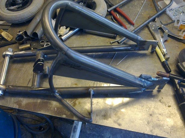

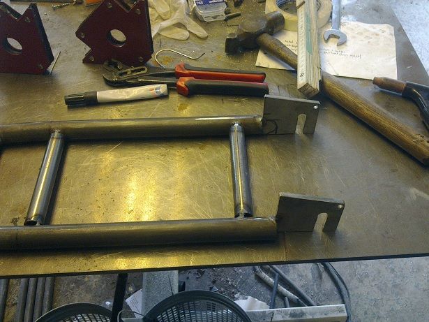

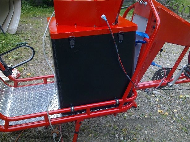

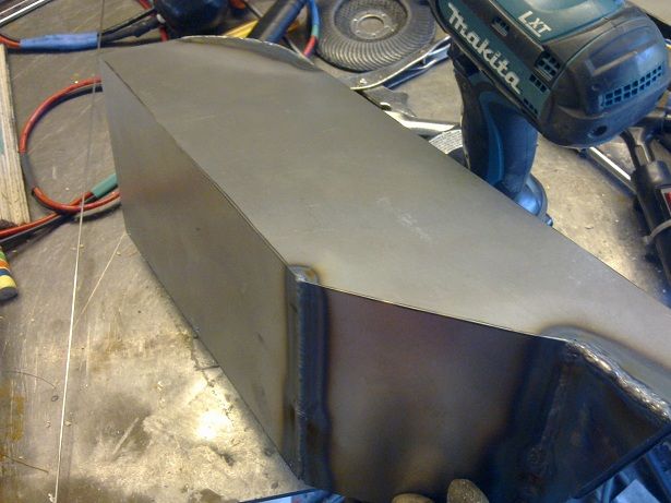

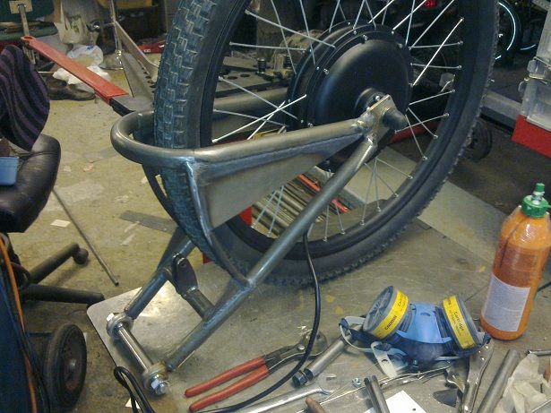

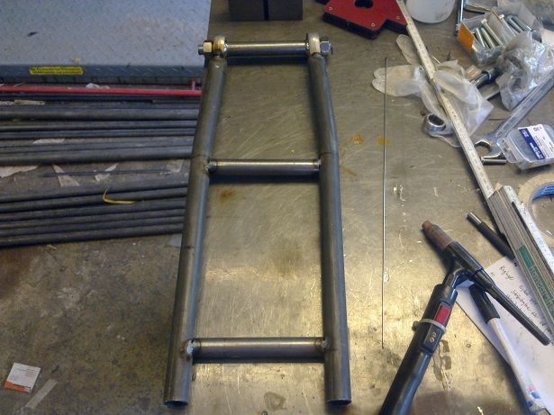

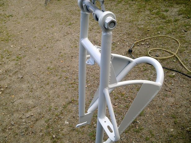

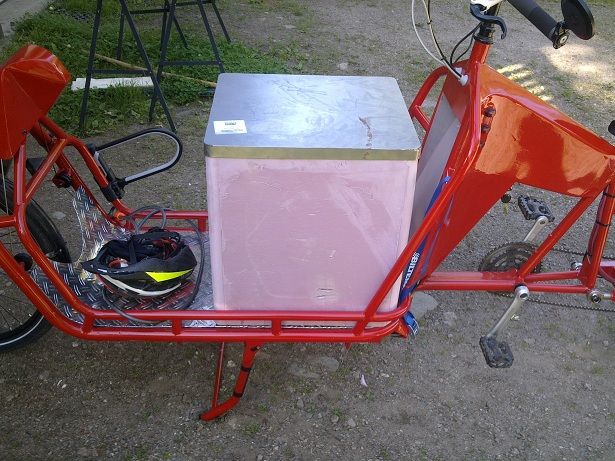

Tomorrow is paintday for the new hubmotor swingarm, the hatch on the cargobox and the eaton chargers "sheetmetal box" ive made.

Ok so I have started tuning the adaptto for the leafmotor. The top noload speed is pretty much dead on 1km/h per volt. Tested with a drained chargestate to 65km/h at roughly 65V. Went through an autodetect and used those settings.
Did feel that the motor wasn't doing its job properly so I started to do testruns with different settings. Turned out the settings were quite off.
They are better now, but not dialed in yet. Only changed angle correction so far. The conditions were not great for testruns as it was windy and after about the first 10runs the wind started to increase, making it hard to draw conclusions. I did however improve the angle correction setting enough so I was comfortable riding the bike the 23km commute.
I will post all the data when I have dialed in the angle correction and the ind timing. All the testing is done by going with a 48km/h limit (means it will reach 44-45 on a straight, dunno why the adaptto works like this but its apperently normal) and no pedaling, static bodyposition. Full throttle and landmarks where to release throttle, break and turn. Have done about fifteen 2,5km round so far. This is the same procedure I used with the revolt.
The 23km commute today was in pretty windy conditions (strong sidewind and alittle headwind). Average speed in the 37-38km/h range and just under 22wh/km consumed. This already indicates a big gain in range, will see what further tests yield, and how the motor handles some cargo and hills.

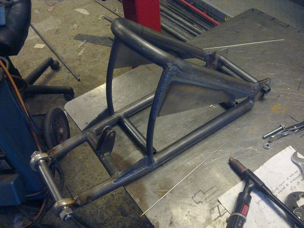

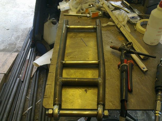

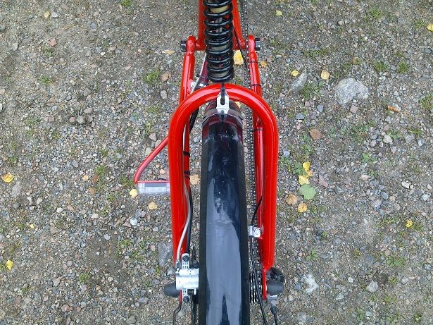

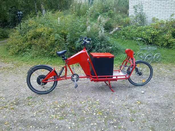

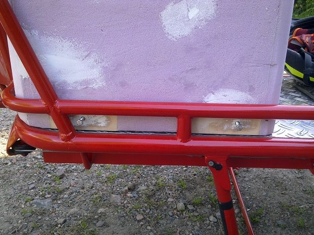

And here are the pics of the progress.
The cargobox is a really nice addition for transporting groceries and stuff that don't want to stay put.

All good things comes to an end, at least for this year.
I decided to not ride the bike during winter and put it away today after several weeks of very mild autumn weather. The adaptto said roughly 2820km travelled total since the bike was built.
Cant complain about much. Reliable and comfotable.
I am still not done with the video I took. Am a total noob in that department, but will get it up sooner or later.
The trike feels very odd after all this time on the cargobike, but I figure it is the best choice as it will be much safer when the black ice arrives.
