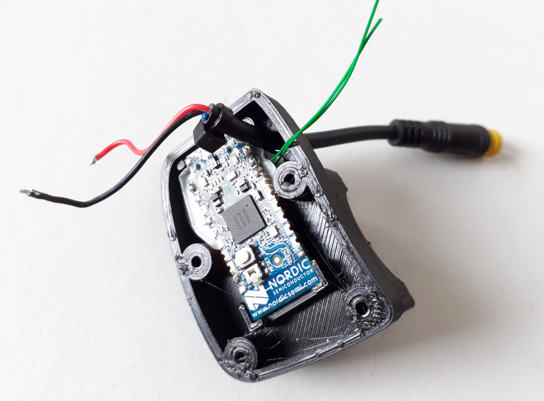

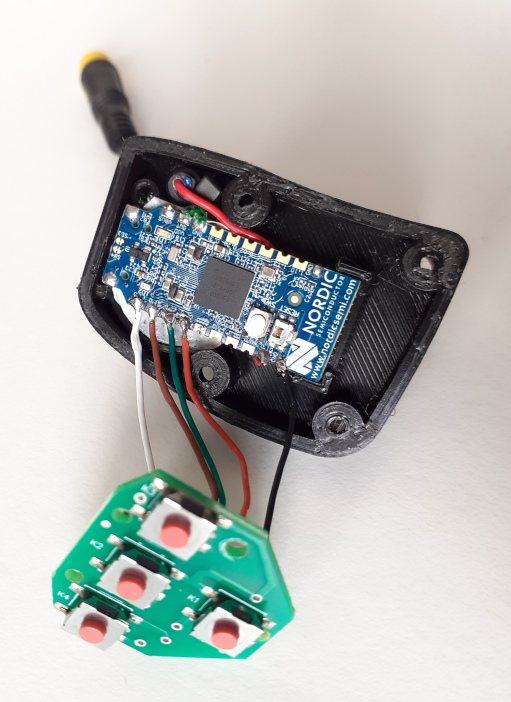

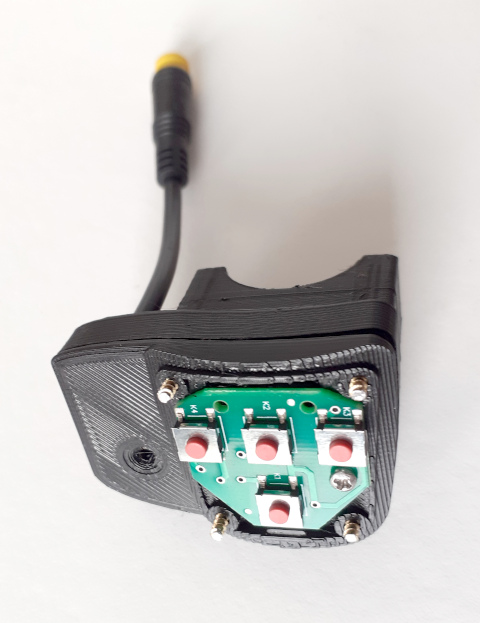

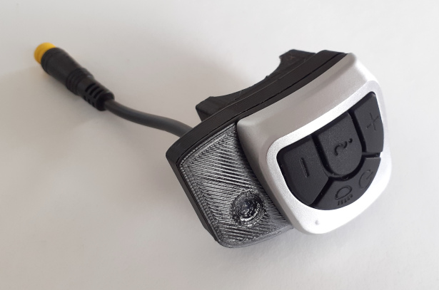

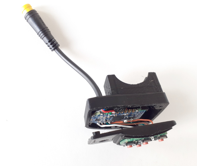

Post by casainho » Mar 04 2021 10:20am
I just finished my TSDZ2 wireless remote with connection to brake sensors -- I am very proud of final result :-)
Here my TSDZ2 wireless remote, with a short cable (to connect to the brake sensors) with yellow Higo connector that is water prof:
And now installed on my EBike:
So the idea is to reuse the VLCD5 remote that is not needed anymore after installing our OpenSource firmware. The case was 3D printed with black PLA plastic and I used transparent silicone to make the wireless remote fully water prof. There is one CRC2032 battery that will work for at least 2 years and a small wireless board.
Board in place with battery under it (green wires). I blocked the brake wire with a small zip tie, so it will be hard to pull it to much up to damage:
All wires soldered - the green board is the original from VLCD5 remote:
Just enough space for the wires:
Done!! Added a bit of transparent silicone on the LED hole to make it water prof:
