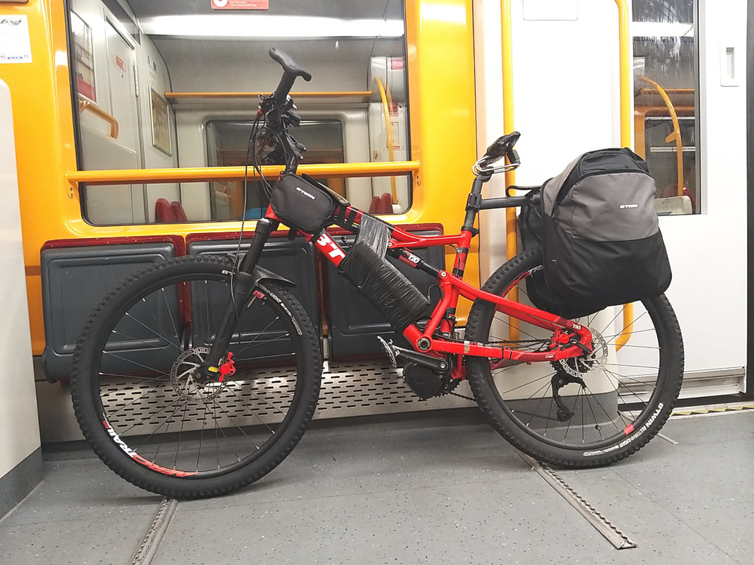

I haven't been able to really test it yet but hope it will serve me well. How are the bikes in your family doing? Are you satisfied? It seems the price and quality are very decent.
Mostly our rides around and I decided to go full suspension for us to have most comfortable riding possible.
And sometimes I do some MTB events on the mountains.

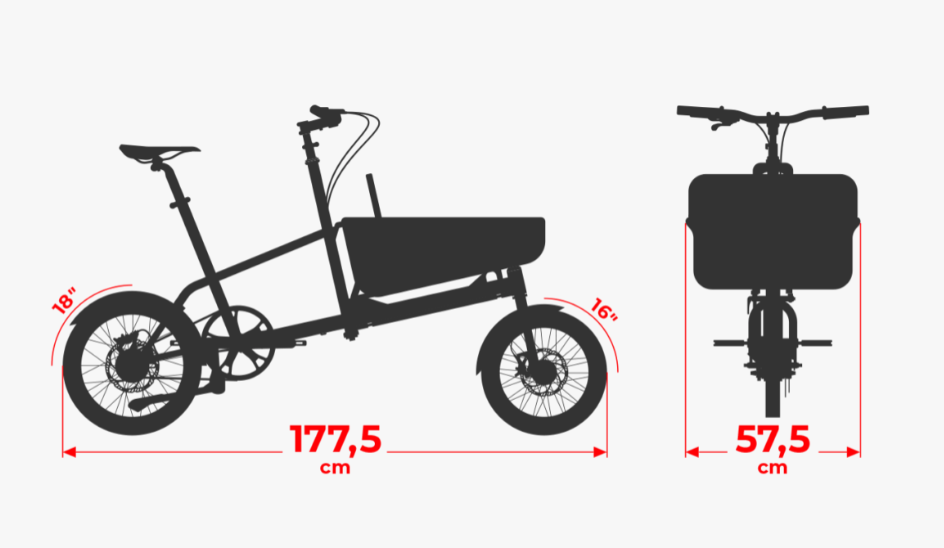

My next EBike to install TSDZ2 will be this mini cargo bike, that has the size of a regular bicycle and so I will be able to put on my car hitch rack: https://yoonitbikes.com/
Should cost over 3.200€ including the delivery BUT I have locally an old experienced manual bicycle frame manufacturer that will make the same bicycle for me but with some adjustments like using regular chain and regular gears and not that internal geared hub, including make sure that TSDZ2 will be installed on that frame, for around 2.000€.
And by the way, that bicycle has original electric motor version, that increases the costs +1.900€!! And am being looking at other cargo bikes and the price difference to be electric is around 1.800€ to 2.200€!! -- so I get a TSDZ2 and battery for 600€, huge savings!!
