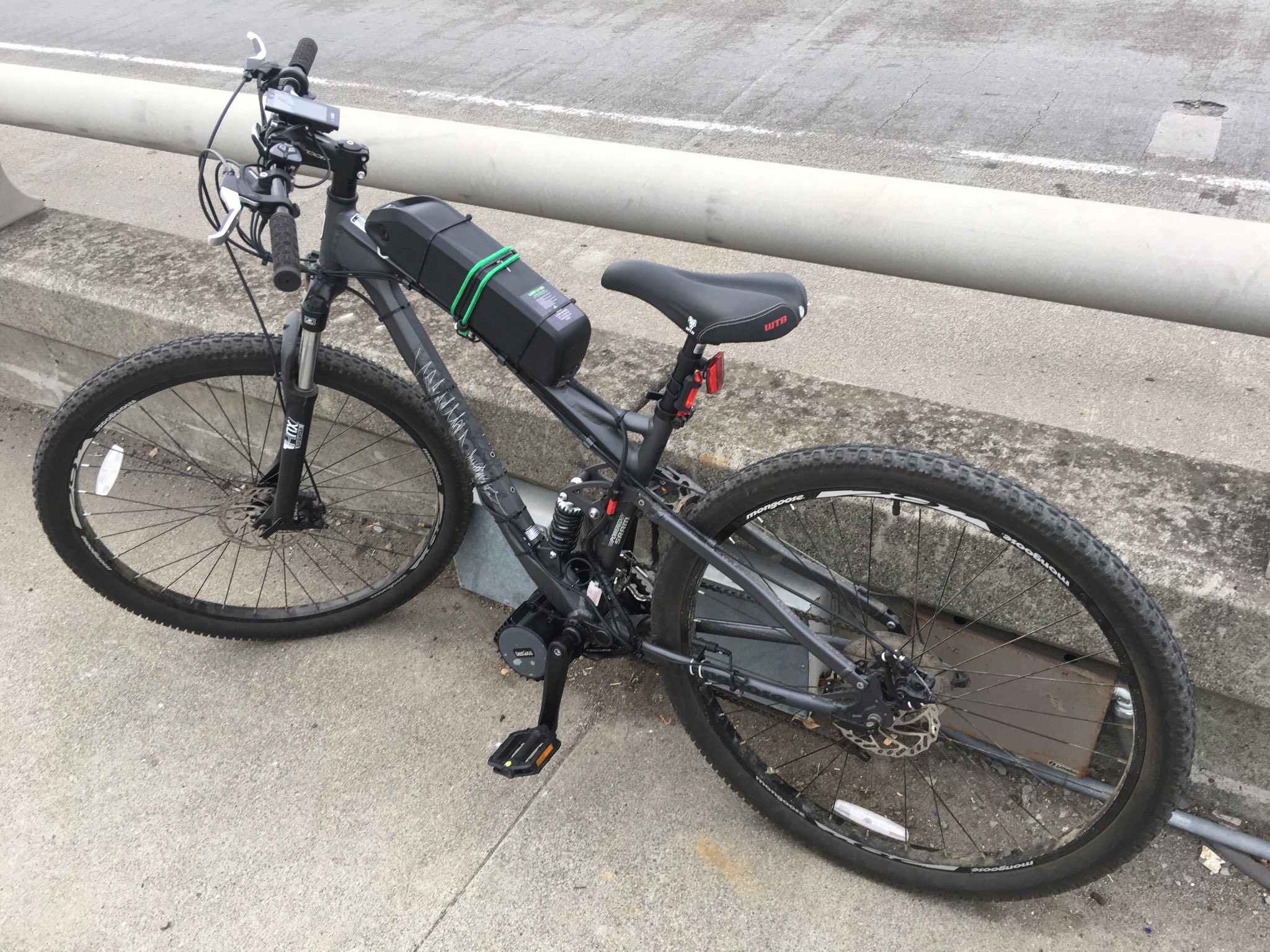

Hi All,
Wanted to gets some helpful feedback on my XR-Pro build. Suggesting a different frame or bike is not helpful so please do not reply if its off topic.
I'd like to purchase everything from a single vendor. I'm open to building my own battery etc.
I"m willing to spend up to $1,500 on the motor, battery and accessory's.
I'm thinking of a bafang mid drive kit from Luna Cycles:
https://lunacycle.com/mid-drive-kits/
I like the look of the BBSHD or maybe the Ultra.

Getting ready to order. I think im going to just go with the BBDHD and build my own batter. Thanks for any suggestions.

Post by captaingeek » Dec 25 2017 10:50pm
Bikes up and running and having a blast!!

Battery won’t fit in frame and be removable. Could probably be semi permanently mounted in there which I considered. Even if you remove the spring in order to remove the batt you still won’t have enough room. Range isn’t that great but probably about 25 miles with pedal assist.
Already have a couple of hundred miles on it and still a lot of fun. Max speed without pedaling is about 25mph. Easy to do 30 with pedaling. No problem climbing.
Removing the stock crank set is a bish. I pretty much stripped out one side. Make sure u have a good removal tool the one that can’t with the Luna tool set is sheet.
