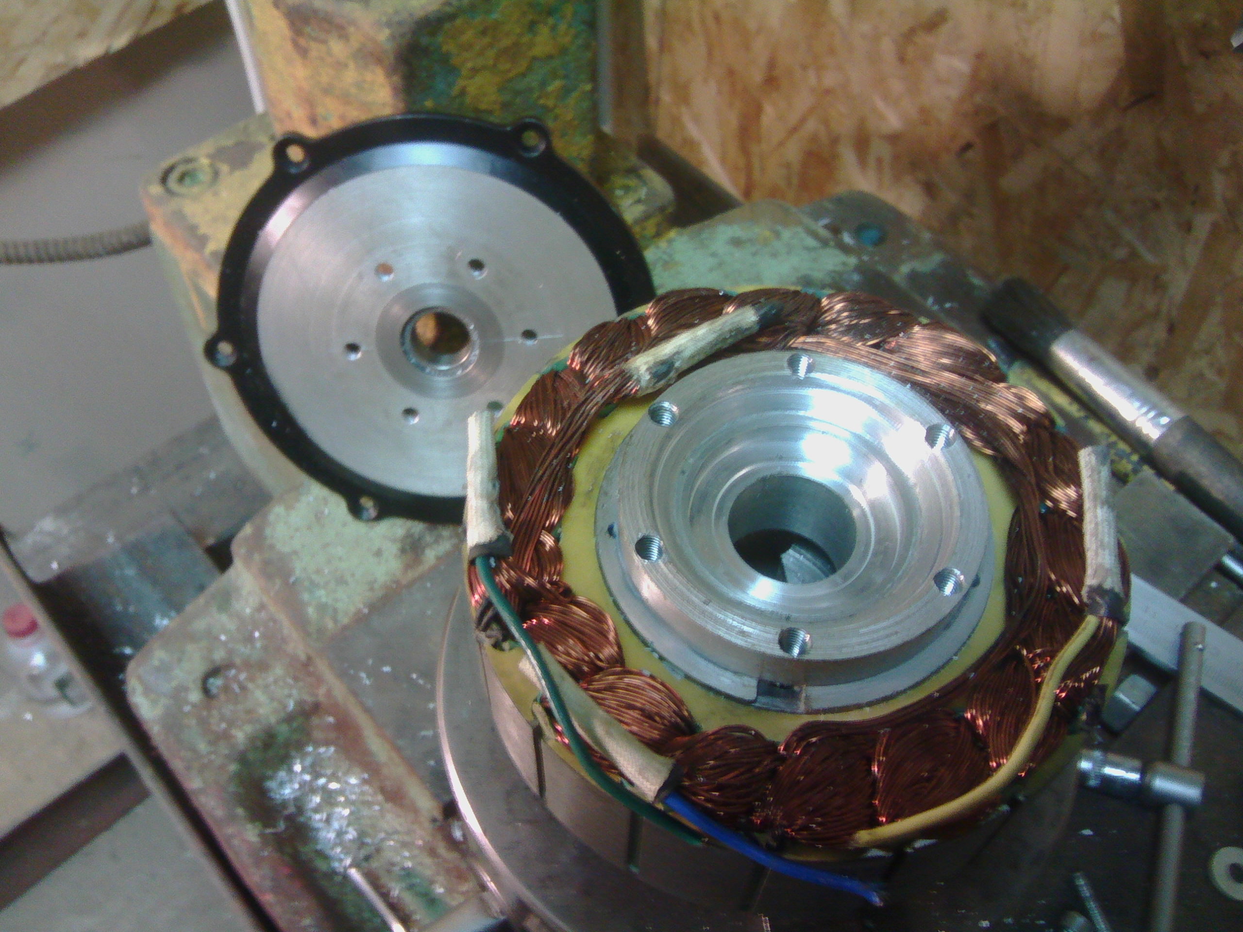

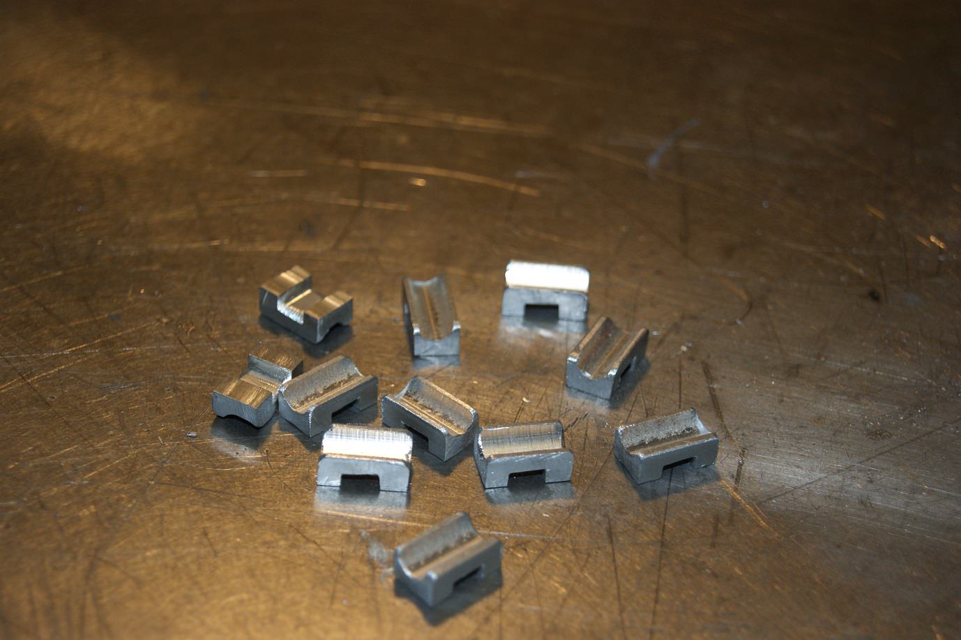

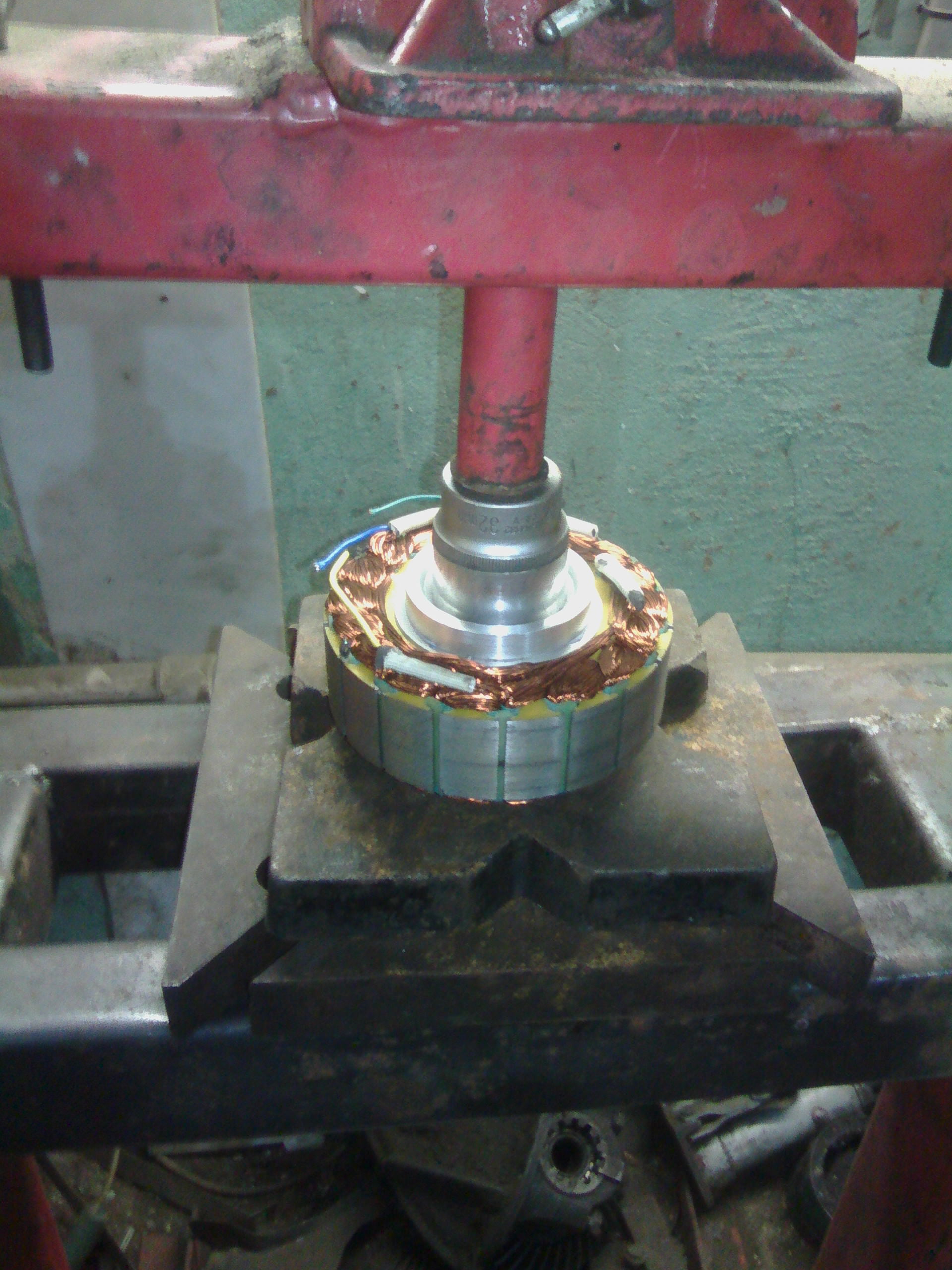

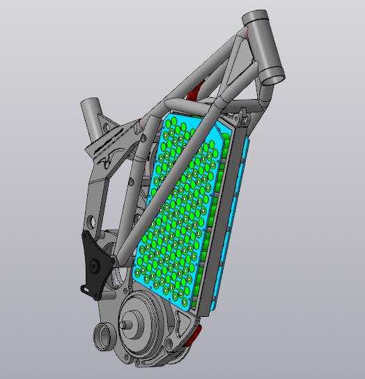

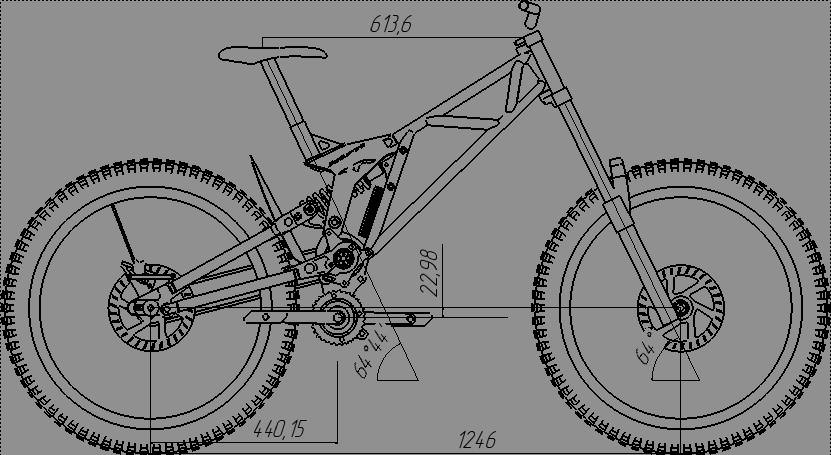

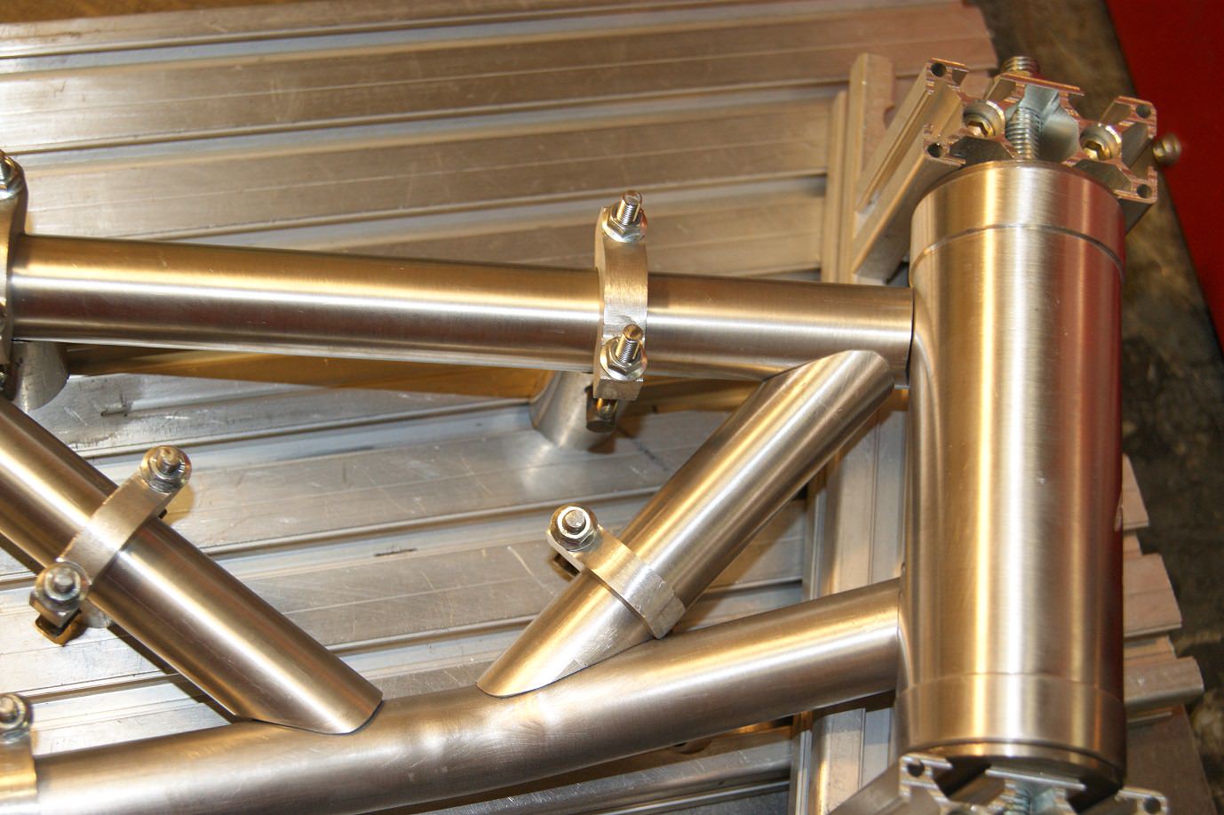

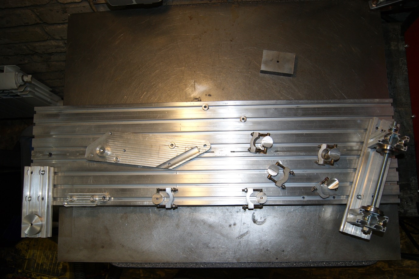

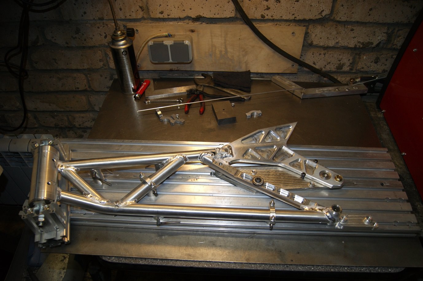

Greetings to all! This is my first topic on this forum. If the text seems strange, the culprit Google translator :) So there will be little text, and many pictures!
http://www.electricbike.com/mutant-e-from-russia/ These are my past projects, thanks to SPINNINGMAGNETS for drawing attention.
I want to make a balanced enduro bike, light enough, with a good suspension, quick-release battery and gearbox. Purpose: active movement along reliefs, with a power reserve of 2-3 hours.
Well, a few pictures of the process ...

Cyclone 3 kW with plastic gear reducer is much wider than my version. For me it is important, I want to have a bicycle and not a motorcycle. The planned nominal of 2 kW. I think the case will dissipate the allocated heat without problems, the whole frame is the radiator. You can remove more power from this motor, but if you notice, Alfine 8 will be installed in the axis of the pendulum, and the drive to the wheel will go through it. The trail does not need a speed of more than 50 km / h, but you need a moment at low speeds.

do you have more data about anti rise,anti squad,pedal kickback,leverage ratio and curve force?

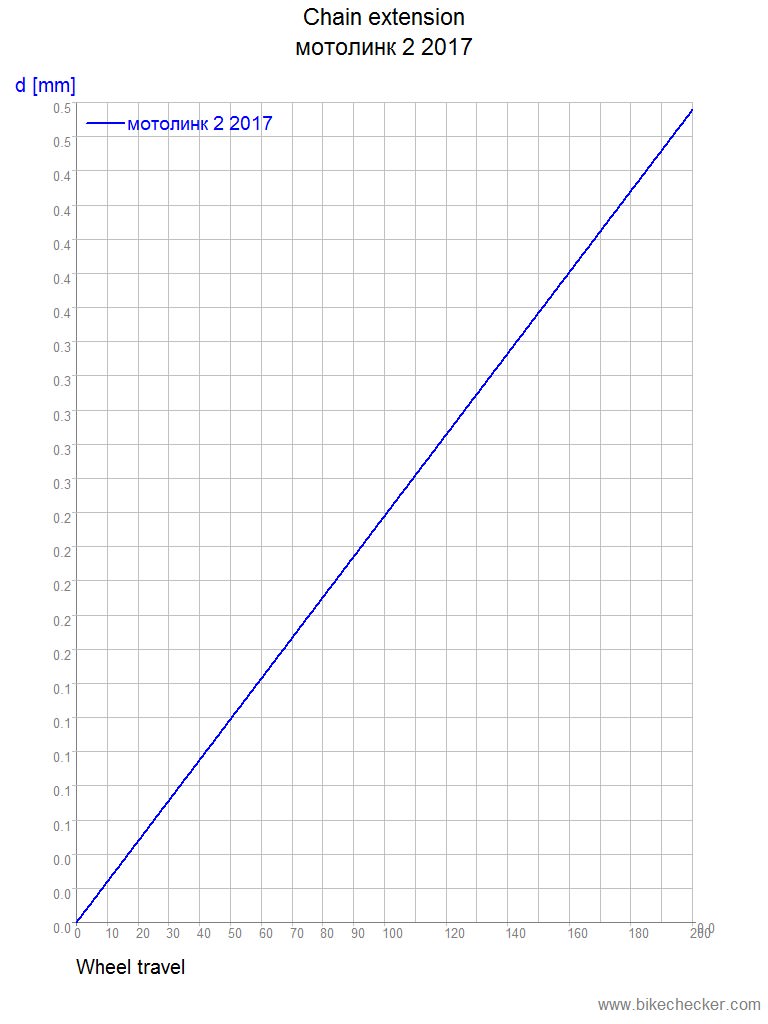

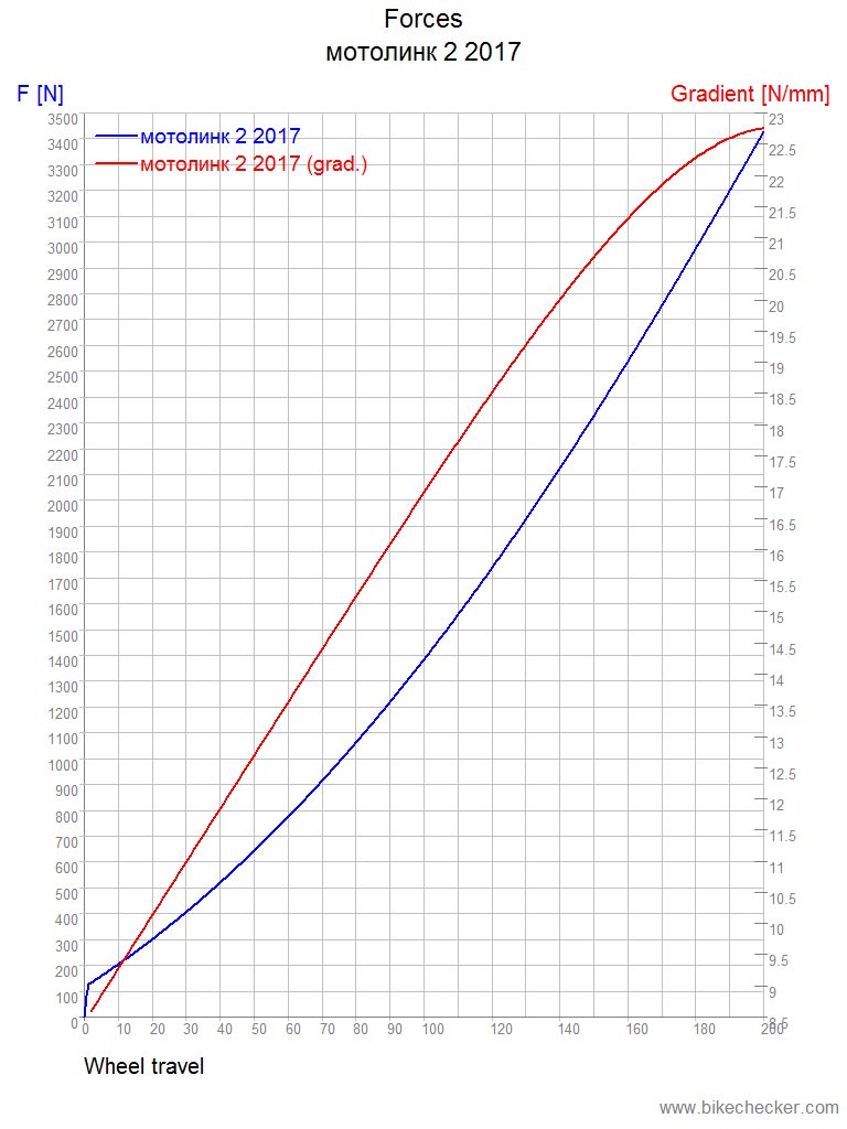

ltu wrote:
Aug 21 2018 11:16am
hello ferum
good job
[+] linkage
It should be borne in mind that in the program, the axis of the pendulum is a carriage, in reality the carriage is lower, and there is a reduction between these axes. In general, I did not sink very deeply, there is a lot of space limitation due to the battery and the motor. If something you tell me. I will be grateful!

hello ferum
i dont speak english very well. i dont understand your question.
i only can help you to suggest you some trick,it cant help you can you suggest me why not:
1-wider width axle(157mm) some link (https://www.bikeradar.com/mtb/gear/arti ... -mtb-axle- standard-what-it-is-and-where-it-is-going-51686/) and (https://www.bikeradar.com/mtb/gear/arti ... ard-51565/)
2-place link to the frame to the axle(blue line),like trek (ABB sistem)or devinci,and place brake mount here(red circle)to reduce antirise,and no need the chain tension.
let me know it it can help you

Post by ferum » Aug 30 2018 2:18am
Hello Ity! Thanks for the advice. On the rear hub, 150 mm width between the drops. That's enough for me.
On the second point, if you place the brake caliper on the swingarm, there will be a suspension lock when braking. There is a flaw with the chain line, but it's not so big.
It is seen that the overall elongation of the chain is 1.22mm, if it is critical, I will put the tensioner.
A long base and a low bottom bracket, this is what I now want.
https://www.mbr.co.uk/news/size-matters ... all-321374
