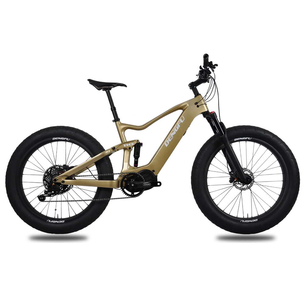

Re: Wayne’s Dengfu Carbon Fibre FS 27.5” with Bafang M600 (throttle also)
Post by waynebergman » Mar 29 2020 7:01pm
HI Gizzygone, I have a fat tire bike and its fun. Was a novilty riding in the snow and open desert but in reality the 27.5 x 2.8 tires on my Dengfu is such a better choice in every way unless you are plowing throw super deep snow and if that is the case you may need a peppier motor than the M600 platform. In my links of other bikes owned in the signature you can see the details on my fat tire should you be intersted. You may have more experience than myself with fatties and know exactly what you need and want but my advise - is forget the fattie and just go with the X1 from Luna. The fatties are cool but heavy and kind of a specality item really only shinning on sand and snow and for me its not worth it. My Dungfu can do it all and actually better unless I am in 1 foot of snow and how often does that really happen. I have come full circle on the hardtail fatty and now back to a 2.8" x 27.5 full suspension at 50lbs so feeling like I have arrived at a good place. For what its worth Gizzygone, think er over before pulling the switch.... :).

Post by speedmd » Mar 29 2020 8:37pm
Nice Bike Wayne. Would love to have one. To me it looks like the Luna X1 is a Dengfu like yours. The new fatty is a bit different. When I was there, they were talking about this new setup that was going to possibly take fat, 29 or 27.5 wheels. Shops like them just are not setup to take care of one off orders. Very difficult as they are swamped with larger qty repeat orders and fill in with these small orders as time allows. For folks needing some hand holding, seemed to me that once the customer is demanding more attention than they can handle, they stop trying to sell to them as they know it will be a time vampire.

Post by waynebergman » Mar 29 2020 8:43pm
HI speedmd, the fatty you have shown looks nice but the steer tube angle looks a bit slack in relation to seat tube angle. To me the 9000 watts or so from the M600 drive is just is not enough to push a fatty around for what it i ment to do. If one just has to have a fatty then go for it I guess (I know when I was in the hunt I had to have so I know the feeling :) , but my experience says forget the fatty especially equiped with an M600 drive.
A fat bike has to have some pep or else be super light in my opinion not to mention you end up with crap forks on a fatty unless you are willing to spend a bundle atleast that was the case a few years back.

Post by Gizzygone » Mar 29 2020 9:26pm
That’s the dengfu I was considering: I believe it comes with the ultra motor, though, not the 600.
