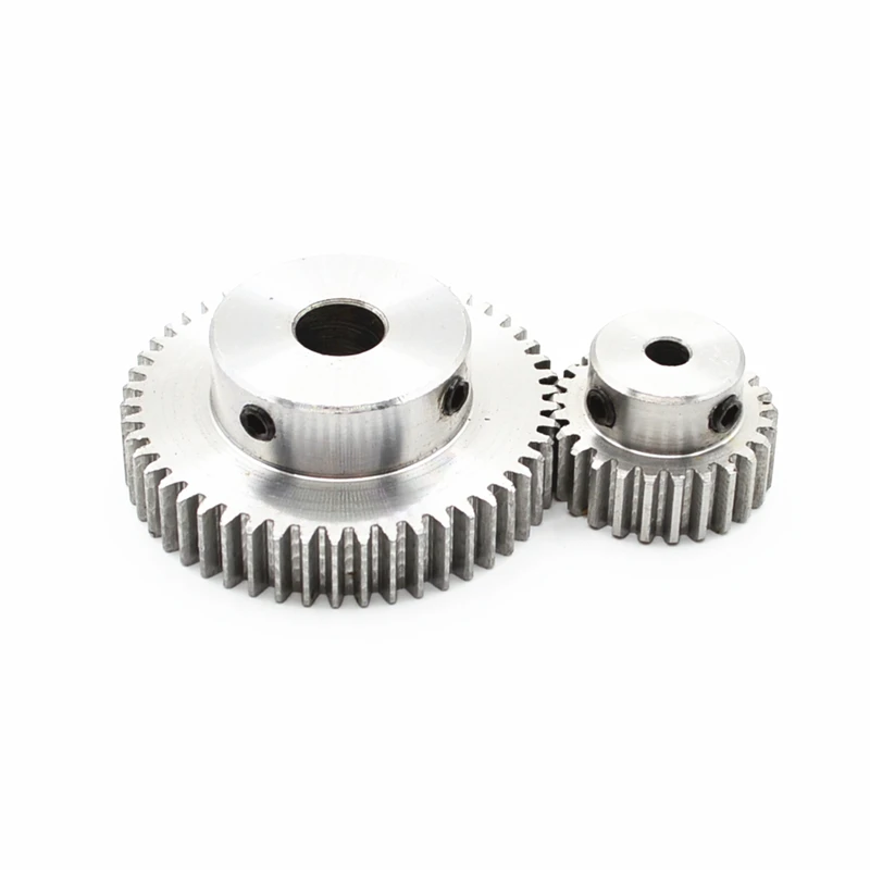

I have an ideea which you also had in the past. But it seems feasible to me now. What if i put another alu plate in front of the motor plate and mount 2 spur gears for a primary reduction of 3:1 (45t-15t), will a mod 1 spur gear survive ? (let's forget the freewheel for now)
These are Mod1 spur gears for cheap:
https://www.aliexpress.com/item/3294654 ... 521905ebf5
If not, wil Mod 1.5 do it ? (or Mod 2)

I think you'll need to run those in some sort of oil bath/enclosure. Since they are metal and straight cut you'd be getting a lot of noise.
I'd look at either a belt, another chain primary or preferably a helical planetary. All of which kind of fall outside the scope of this project.

You're right that gears needs lubrication and probably belt would be the most simple solution.
I was struggling to find a planetary gearbox for rc motors, do you have any example?
