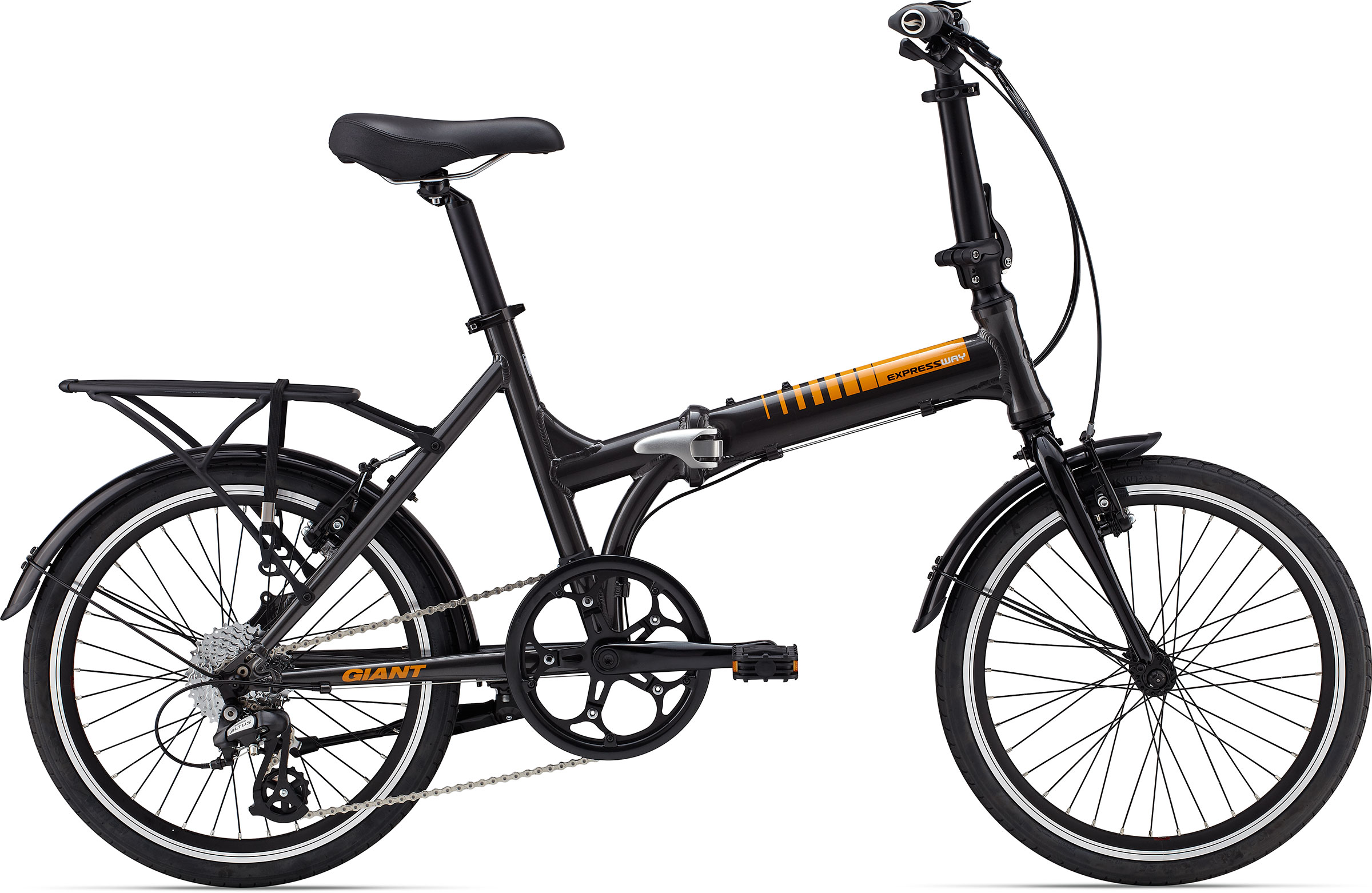

I think I want to build my own DIY bike. For the price/quality it doesn't seem like you can come close any other way. But, I want to do it kinda cheap like(1-1.2k usd) and I'm also in love with the folding bike concept.
The basics of what I'm looking for are a solid frame and an upgrade path. I'm kind of a fatty at the 240lb mark so frame is important.
I don't care about being a speed demon but going 25mph is nice through the residential zones. I'll probably be doing short 2 mile stints but having the ability to go 20 miles once in awhile is a good mark.
Sooo down the rabbit hole I've found https://www.rakuten.com/shop/cyclingdea ... igQAvD_BwE a HASA folding bike which seems like it has a solid frame with disc brake mounts. I do want disc brakes because I think stopping is just as important as going and also want to upgrade to hydraulic in future. It looks like Dahon is the default but I'm not rollin in that type of money. The only other brand I came across from HASA was Camp in that price range?
I've also found http://recycles-ebike.com/48v-tsdz-kits ... brake.html TSDZ2 for the mid drive. It looks like there is a site or 2 to get these pretty cheap. It just seems like a good option for cheap. I'm ok with a bafang at a good price too but it seems these kits average cheaper.
The battery seems to be the biggest hole. It looks like you can buy some cheap stuff from china all day but it's a gamble and a half. It kinda looks like you get what you pay for in this realm. So is EM3ev the best option here? I think I need a 48v at least 10ah pack. Looking for quality for cheap. I think I'm pretty much going to strap the battery to the rear rack.
The future upgrades I'm looking to are hydraulic brakes, sturmey archer 3 speed and fattier tires.
Seems like the deeper I go the more questions pop up. In the end I just want a cheapish folding E-bike. Not a speed demon but something reliable. I'm always function over form so tell me if I'm way off in what I've somewhat narrowed down to now.
I'm open to any suggestions and any trusted site links.

25 mph is very speed demon territory on a folding bike with a heavy rider. Even with a 52T front gear on the TSDZ2, you don't have the gearing to spin the pedals at that speed, so it will be all throttle. At 240 pounds, you're right at the weight limit claim for most folders. The 20" wheels are not forgiving either. You will probably want to go up to 2" wide tires for more cushioning. I don't know that mechanical disks are much better than a good V-brake, but they make wider tires easier to fit.
Some of the folding steerer tubes seem pretty strong. Some look pretty flimsy. Consider that a regular bike has a quill or threadless stem clamp with a short and solid steerer. Folders put something that is 16-24" long that has a hinge in it. Cheap ones are going to flex. I don't worry about the frame hinge failing, but think that a cheapo steerer could snap if one pulled back on the bars hard to jump a curb. Don't jump curbs.
I am in the rabbit club with two light weight folder conversions. I used Downtube folders. My wife uses an 8FS, with full suspension, but she is only 130 pounds and it's a nice ride for her. Mine is a Nova. I am 200 pounds. Both use small hub motors. On 36V, they only pull 500W max and top out around 18-20 mph. I have gone 48V and seen 22 mph on mine. Where do you put a big battery on a folder? It's hard. I run small battery packs like a 36V 10S3P (30 cells) and pairing up two 36B 10S2P (20 cells each). They're good for 30+ miles at pedal assisted 14 mph. And we rarely fold them. The first time I folded mine, I found I didn't put enough slack in my wires. Pulled out all the connectors.

A folding bike isn't a good option for riding. It's not designed for that. It's designed to fit in places a proper bike can't. If you're not below average height and weight, a folding bike is not usually even a safe option. If you don't believe me that they suck, please go to a well-stocked bike shop and ride a folding bike back-to-back with normal bikes in your size. Wishful thinking will not be enough to maintain the illusion that folding bikes are satisfactory. They are something you use because you're in a situation where you can't use a real bike.
At your weight, I think the Swift Folder is the only small-wheeled folding bike I'd trust to hold up. It's still handicapped compared to a normal bike. Remember that normal bikes are normal because they've been vetted and refined for over 150 years, and what's traditional is actually what's been found to work best over that time.
Disc brakes aren't a good match for small wheels. They are designed to work with larger wheels, and they become too abrupt and grabby when used with small wheels. Combined with the short wheelbase and awkward frame angles of a folding bike, this is a recipe for unnecessary crashing. The included disc brakes on the Rakuten bike you linked to are almost certainly weak and crappy, which under the circumstances might be considered a safety feature.
Brake rotors and hydraulic hoses are much more likely to be damaged when they're on small-wheeled bikes and those that fold. Rim brakes, drum brakes, and coaster brakes tend to develop minor, easily fixable problems. Discs and hydraulics tend to develop problems that totally disable the brakes (like a fluid leak or a pulled-out hose) or make the bike unridable (like a badly bent rotor).
If you're only comfortable spending sub-$400 on a bike for conversion, it had better be a real bike (not a folder) and ideally it should be a used bike. Cheap new bikes under $400 are doing all they can to cope with ordinary human power and speeds. Cheap folding bikes under $400 aren't even capable of dealing with human power for very many miles. If you want a new and cheap bike, suitable for electric conversion, look for a sturdy 26" wheeled bike with one-speed gearing and V-brakes. That's the most robust and effective setup you can get for cheap.
Here's an example of a bike you can get for $300 new, that won't crap out quickly when you add a heavyweight rider plus electric motor power. If you're tall, even the tallest size available won't be a good fit, though:
http://www.bikesdirect.com/products/gra ... lt-bmx.htm
If you want to "upgrade" to an internal gear hub later, don't start with a bike that has vertical dropout slots and a derailleur. It's difficult to reconcile such a bike with the need to take up slack in a single speed chain, while leaving room for the gearhub's clickbox.
TSDZ2 is far from proven, and it looks like a much better bet for lightweight riders and modest power outputs than for luxury-sized American adults and USA legal maximum e-bike power levels. It will eat up a disproportionate amount of your modest budget compared to a cheap hub motor. It's better, I think, to get a cheap and simple hub motor kit and spend more of the budget on a better bike and battery. If you must have a mid drive, the Bafang BBS02 looks less problematic (though comparably expensive).

I thought about doing something like that, before scrapping the idea. A few considerations for you to think about.
1. If you're upgrade path include fatter tires, then you need to make the decision up front, on what frames with support that.
2. Based on what you want, you may want to consider a hub motor, and a hub motor in a small wheel can have plenty of torque to propel a heavier load.
3. Finding places to hang all of the ebike stuff on a small folding frame will be a challenge, so that's something to consider in the frame design.

Lets start with the good. EM3ev is a great company to deal with. you're right about the 48v 10Ah battery, if you keep speeds in the 15mph range. Building your own bike is more rewarding, and you can build a better bike for your money. 1.2K is a good working budget, and you should be able to reach your goals with ease.
Folders are useful. I have one and it certainly fills a need that none of my other ebikes do. That said, it's easily the least comfortable, least fun to ride ebike I have.
Most folders are rated to take between 210 and 220lbs. Cheap ones rarely publish weight limits, but don't expect them to be more. You're likely going to be exceeding the weight limit of that bike. remember, you need to account for another 20 to 30 pounds worth of motor, controller, battery, racks, mounts, etc.
25mph on a folder is not an experience I want to repeat often. With a short wheelbase, a frame design that leaves it too flexible, and weight poorly distributed over the wheels, the bike will try to dump you off at every opportunity. 15mph is about the max reasonable speed on a cheap folder. Even at 15mph, stopping is sketchy. the wheelbase is too short and the weight is too high, so any panic braking will try to flip the bike over the front wheel.
As Chalo mentioned, that's not a good frame for a 3 speed, or for any IGH. You need horizontal dropouts so that you can properly tension the chain. the vertical dropouts of that frame won't work. If you choose that bike, leave it a 7 speed.
The motor you picked is known for being much weaker and problematic compared to the Bafang BBS02. Saving money by getting something that will break isn't saving money. If you don't have many steep hills, you might consider a 500w geared hub motor. that will knock hundreds off your build cost, and increase your reliability.
Disk brakes are nice on large wheels and fast bikes. they are actually often worse on slow bikes and small wheels. Consider that your wheel IS a disk. Disks on folders are prone to getting bent, so limit how useful a folding bike frame can be. Hydraulic brakes add more complications with leaks, kinked fluid lines during folding, air bubbles getting in the line when the reservoir is inverted, etc. All things being equal, I'd rather have a rim brake on a folder, and so I do.
It's not all bad news. Folding ebikes have their place, and are much better than not being able to carry your ebike with you. I really do enjoy taking mine on trips. But if you don't need it to fold, a conventional bike would be much much better for building an ebike.

Seems like the more I learn and dive....the more I go back and forth :(
Ha ha ha! That's the pitfall of today's "overchoice" marketplace. Too many options leaves you feeling overwhelmed and depressed! It's like standing in front of the dressing aisle at the grocery store, how the f********** are you supposed to pick one and feel good about it?
For bike selection I wanted to toss a suggestion in the ring: a Giant Expressway or Expressway 2, used. This is a great little folding bike I use as my regular bike. I'm over 270lbs and I've ridden it for many years without a single issue outside regular maintenance. It's got a very solid frame and rides nicely. The fork is chromoly too, so you should be safe putting a low-wattage hub motor in it (I would NOT put more than 500w into a folder... they aren't made for those kind of stresses at all).
You don't get disc brakes with it, but if you're only looking for something to do short jaunts on, and fun rides, V-brakes will suffice. You may have to do brake maintenance more often, but once you get decent at it the task is not much of a challenge.
For motor, if you're not wanting to dig into installing a bafang (I don't know that this is any more difficult than a hub motor), then a small diameter geared hubmotor up front might be your best option. You could also do a rear one. HillTopper makes an excellent little kit that doesn't even have a throttle, just a push-button. There are several good geared motors on the market... and this would be excellent if you have hills to deal with too.
A kit like this might do nicely: https://www.amazon.com/AW-Electric-Bicy ... pons&psc=1
Anyways, I hope you find the right fit. I wouldn't worry about all the "why do you need a folding bike" questions, it's a waste of time to answer them all. There's lots of reasons someone might want one, and I don't feel it's helpful to go visiting the intentions of someone asking for help. If he or she has their heart set on a folding bike, just accept it and help said person build the safest, funnest ebike their budget will allow. It's a hobby, not a courtroom.
