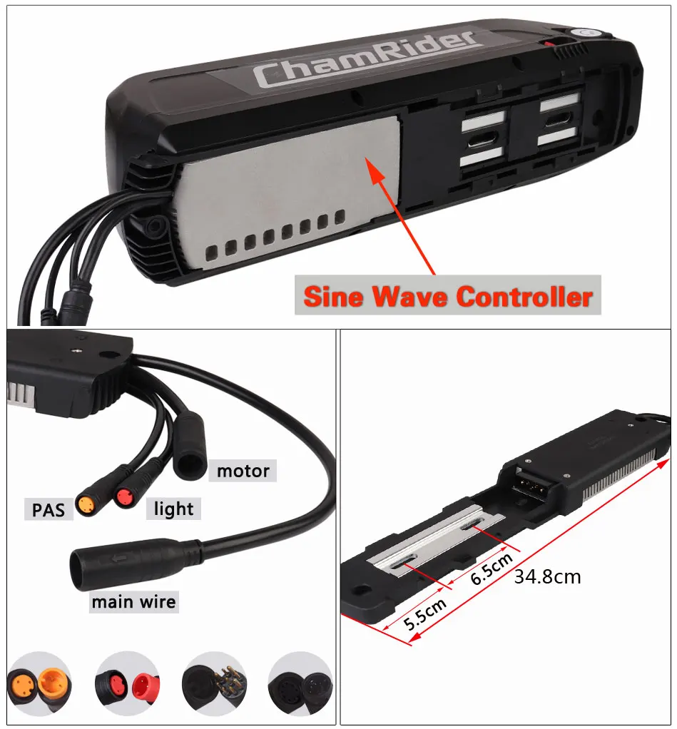

Thanks for your tips, 1000W 48V seems better option for me. 500W 48V kit has controller integrated to battery and it was waterproof so it was tempting. I'm planning to ride bike year around even during winter when it snows How water resistant that 1000W kit is? Any recommendations what kind of controller bag/case should I get so it's rainproof? Controller dimensions are in inches 6.77x3.23x1.65 and in cm 17,2x8,2x4,2 (LxWxH)
Also my bike is this https://whitebikes.com/ax-290-ff-20/b/2461/ and it has Shimano CS-HG31-8, 11-34T cassette. So I was wondering do I go with default set or do I need to get freehub(cassette) version?
E: noticed that I might have freehub(casette) so I can't get that 1000W option then because it doesn't have casette version.

Re waterproofing, one trick I like to use is mount that controller close to the back of the seat. All your plugs tuck under the seat, and your ass hangs out enough to keep the controller dry while you are moving. bag the seat to park in the rain.
More expensive kits are out there, with much better waterproofing than that cheap one. Starting with a better sealed controller box, and waterproof higo type plugs.

Controller has this light connector, what kind of light goes with it? Tried to look some ebike lights and didn't find anything with connector like in the controller.

That connector is called a higo, usually nothing ordered from china is standardised and waterproof connectors cost money so I would be very surprised if a light did have higo.
