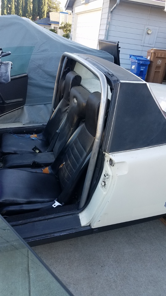

Rollbar. Very important that you remember it has to be attached to something underneath that doesn't give way. For a space frame you have SCCA regulation 1 5/8" last time I looked for the outside diameter, .95" thickness tube. That would run under the driver then an upright is attached for your roll bar. great for 100 mil an hour flips, but not perfect.
From my childhood, I vaguely remember they thought the rear upright of the old Porsche 914 would be plenty safe for club racing, leading to the painful discovery it wasn't. Did it hold up in freeway accidents? I don't know, but then the normal car roof doesn't survive without a roll cage inside. You only need good enough for maybe 25mph, right?
I think the cage will probably have to wrap around outside. A diagonal on each side protects from getting t-boned. That first one only needs to cross members underneath joining it, right?

Dauntless wrote:
Nov 12 2020 4:35pm
Thank you for your input Dauntless, as you stated I am not planing racing with it, I will be only doing some in town commuting and I plant to limit it around 45-50Km/h (+-30mph). I was not planing using any kid of roll bar. But the idea of adding one wrapping outside can be very good if at the end the self support structure is not strong enough. Thank you.
