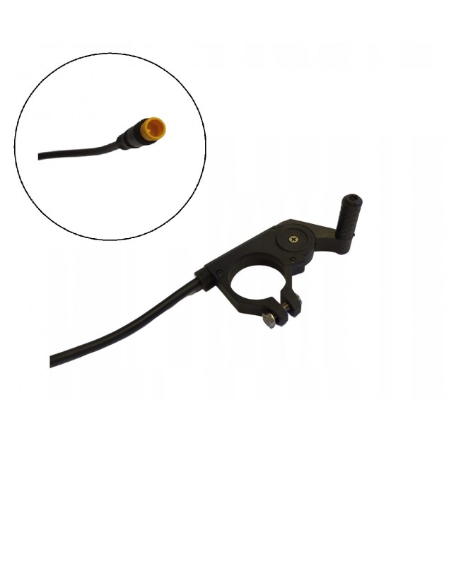

This is not at all what you asked for but I would be remiss if I did not mention that these trigger throttles are my favorite ebike throttle of all time. (Thumb throttles make my hand and wrist cramp and cause me to have a mediocre at best grip on the bars, fwiw)
https://e-bikestuff.com/en/throttles/93-trigger-throttle-black-rapid-kt-bolt.html
(Note: the power and signal wires are inverted, on the model I happened to purchase anyway. Easily overcome, and the other models they offer may not have this particular drawback. Worth mentioning however.)

That trigger unit is interesting.
I really like them, and they tuck nicely behind the brake lever which protects it from impact. Practically speaking the brake lever would need to snap off for the throttle to be damaged under most circumstances I can think of. Great grip on the bars, great modulation, even has a rotating rubber bit that spins as you squeeze it so your finger is always on axis. Best I've ever had and now my new standard.

Does anyone else think that the trigger throttle posted by HK12K appears kind of fragile? I think the Bafang trigger throttles that are "push to the side"...al la ATV style...are also quite fragile. Maybe the best protected thumb throttle is the common, universal, Bafang, thumb throttle that is "push forward". It tucks up pretty tight if crashing and hitting things on a trail are of any concern. For most ebikers, I guess, any throttle that works and fits one's preference is fine. If you have to be concerned about off road damage, the compact universal thumb throttle and the half-grip twist throttles probably offer the best protections.
It looks to me like it would tuck up sheltered underneath the brake lever. That doesn't make it rugged, but it does limit the need for it to be rugged.
I have seen the paddles break off Wuxing 130X throttles before. It's not a common problem, but it seems at least as likely as breaking a twist throttle. (Which I did just the other day, and replaced it with a Wuxing 130X).
