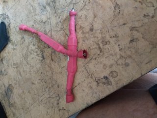

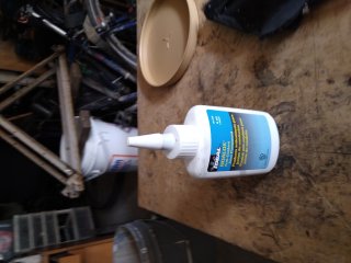

Hi guys
I just got my Anderson connectos and housings ready but didnt put any lubrication on the actual metal terminals
They spark every time i connect to my controller causing pitting and damage to them. Now they are almost impossible to connect together.
These are SB50A. Should i be putting conductive lubrication on these right from the start? Which type is recommend since i read the it should be conductive grease.
Thanks!

Scrape the rough stuff off the tips. The tips are meant to be sacrificial. The real connections happens further up, at full engagement, after the tips have sparked.
You would use non-conductive dielectric grease to prevent corrosion and seal the connector. Putting a conductive substance on it would be a good way of creating a short.

I use Penetrox conductive grease, specifically made for this. Penetrox makes a long line of conductive greases for copper/aluminum, copper / copper, or other exotic metal connections to enhance conductivity. Trusted for decades by electricians.
penetrox penetrox penetrox.

Use a conductive grease.. not a non conductive one. I have heard trouble conducting reports of people using dielectric grease here on Sur Ron batteries. Dielectric literally means " does not conduct".." insulating" . Penetrox specifically makes a few that are made for copper /copper conductors.
But each time i connect, it sparks and causes the tips to become rough :(
999zip999 said:
No more spark. No problem add are incline pre-resistor. What voltage are you running ? I would replace connector or find a nail file yes a wooden one so you can cut to fit and when worn just cut back for new surface .
I am using 117V pack when fully charged...28s.
I think if i file the rough surface it will just happen again without a resistor. What resistor are you using?

Yes looks like i will need a precharge resistor. It sparks every time i connect.
My max. voltage is 117 or so fully charged. Is there a resistor you can recommend? Thx!

I was going to use Noalox for a battery build is it good for this ?
Here's pic of my pre resistor. For 72v.

Ok use the Noalox on the plug for my 3 meanwells and it didn't pop as 1 sec earlier. So put it on my 60xt and no pop. Now going to grease up the 5.5mm to xt90s connectors
Ok plugged the 3 meanwells into the wall again and a little pop. I read up on it and it is conducted Oh no magic

Hi...are you using 2 preresistors? I thought you only need 1 on the Positive leads?
