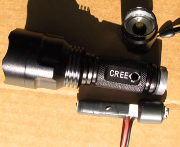

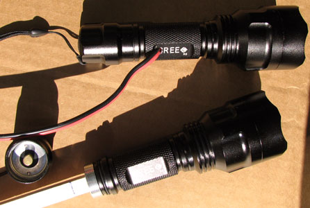

I bought Qty-3 of the UniqueFire X8 Cree XP-G R5 300L HP-LED Flashlights from DinoDirect for just over $100. It comes fully assembled sans battery and charger. Workmanship on the flashlight was very good and without obvious flaws.
In the image below – the reflector in the upper-right was the only item that DealExtreme shipped to me: It wouldn’t fit the UniqueFire light nor could be adapted. You can wager DealExtreme will not be receiving a Hexmas card from me. :P
To convert the flashlight from AAA battery to electric, I took a length of square balsa rod which was purchased from a hobby store, removed the end-cap of the flashlight, inserted the wood all the way into the battery tube, marked the end, and then cut off the rest. The image below shows a completed modification at the top, and one in progress below.
Note: Balsa is a light and very soft wood whereas Pine, Acrylic, or Nylon rod would make for stronger alternatives. Time will tell if the balsa holds up.
I used a 7/32-inch drill bit to make the hole into the side of the battery holder as indicated below. Using 18-AWG speaker wire, I crafted the pseudo-battery using the cut balsa as the placibo & where each end of the wire has a nice large blob of solder for a contact, depressing it into the soft ends. The wire is secured by a few wraps of electrical tape. Note that the Negative end is wrapped to a diameter that nearly equals the battery, and in fact is a snug fit within the holder. Some experimentation is required to produce the right fitting.

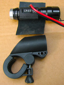

Contrary to natural thinking I reversed the mounting hardware so that it “pointed” backward on the handlebar. With the image below, “front” would be on the left. Reason being is that when the head-piece of the light is attached, the whole assembly is nearly balanced over the handlebar – which is very important considering the weakness of the attachments. I cut out a piece of neoprene to wrap around the entire battery tube; this did a much better job of creating an even fit across the length of the fixture. When this is assembled, rotate the unit so the the wires drape out the bottom directly and insert into the fixture with the clamping fastener for the light removed. This will allows the wires to slip into the slot snugly just right of the handlebar fastener. The head-piece is screwed on last.
Small notes: All the fastening hardware that came with these mounts are shite; best to replace it all with Allen-head screws to prevent tampering or dropping out due to vibration. Also the rubber provided was not large enough to enable a secure clamp therefore I built up the size around the tube by cutting two strips of neoprene rubber ~ ¾-in x 4 inch that I wrapped tightly around the handlebar and secured with electrical tape where the flashlights would eventually go.

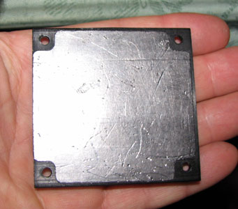

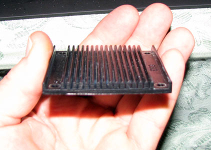

I bought the heat sink off of eBay for $1.00 each – that’s right! It cost more to ship it to me. The heat sink is really low profile – lower than I anticipated. But it’s better than a poke in the eye. It even came with mounting screws! However - without nuts… it’s kinda futile but whatever; they went into the parts bin. The holes did not match up closely with the DC-Converter and had to modify them with a drill which was cumbersome … meh; part of the job. Fasteners that work: 4-40 x ¾-inch or M3-20mm will do in conjunction with aircraft nuts and no washers. My local Ace Hardware has a better selection than the Home Despot.
The backside of the heat sink had this graphite-like slippery yet delicate material. I did not use any compound between the surfaces during the joining.
I decided to keep the default voltage at 3.3V without trimming or other adjustment, however I did add a small 470µF 35V electrolytic capacitor on the output side to assuage the ripple and buffer the load. In the image below the Secondary ON/OFF shorted to Ground for constant operation. Again 18-AWG Radio Shack speaker wire was used. The rest of the unused pins were covered by a short snippet of heat shrink tubing, and then plastered all down with electrical tape.

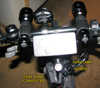

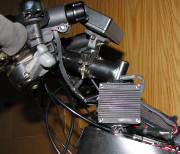

I had secured the heat sink to the Converter with zinc-plated screws. Afterwards the modified regions of the heat sink where I filed and drilled were given a quick dash of hi-temp engine paint, then cured it on top of an oil space heater. While sorting out the wiring and doodads I left the whole assembly turned on for 3 full hours. On a 40-Ah battery it registered about a 0.1 Ah drop/hour. The little heat sink was toasty enough to keep biscuits quite warm, and perhaps would make for a perfect bum-warmer if one could figure out an arrangement below the seat. However it never did get too hot to touch in a static room-temp environment – though I wouldn’t want it to get any warmer. Come summer I should source a larger heat sink. On the flip-side and to my complete surprise the Cree flashlights barely registered any warming.
The image below displays the DC-Converter mounted on the neck of the handlebar for best exposure.
Top-down view of the assembly almost directly over handlebar post. (Apologies for the glare of the CA). The heat sink is the squarish shape on the left of the post. Two toggle switches are on the right above the obscured controller. I kept the old battery-powered headlamp in the center as a backup. The flashlights can be turned-on or have their mode set individually though I prefer to have a master headlight switch (upper/closest to the CA). The lower one is the Power Switch to the DC-Converter, and is useful for arresting the 0.5W patristic drain even when there is no load.

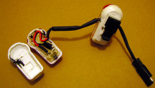

I use a pair of Planet Bike Super-Flash blinkies for tail lights when riding day or night. The 3.3V out from the Converter goes to a pair of 18-AWG Trailer Connectors: One serves the Cree flashlights, and the other connects to the Super-Flash blinkies in the rear. Modifying the blinkies was pretty straight-forward: Remove the AAA batteries, bend out the contacts, and solder the pre-tinned wire ends. I then notched the sides of the casing. As an afterthought I applied Urethane sealant to the wire and slots to repel moisture. Two views below show the completed assembly.
The blinkies are connected directly to the output of the Converter which is controlled by the Power Switch. When turned on, they are at least as bright and strong as a brand new fresh pack of batteries – and probably more so being very highly visible; an unexpected though most-welcomed benefit! :D

Second Item – Headlight Replacement
Been running the same pair of headlights for a while now: Cree UniqueFire X8. About 300-320 Lumens. They are 5-Way so it’s kind of a pain because they will change function on their own if I hit a good bump or divot.
A while back I ordered up a pair of Cree UltraFire WF-501B which claim to put out 900 Lumens. I think it was last week I took my Commuter Pack off the bike and balanced it – using these lights to pull down the high cells. And – they are definitely brighter by at least 2X over the UniqueFire. I bought them to upgrade the original pair but the parts are not exactly 1:1 compatible so I shelved them. Needing a good source for load during balance, I decided to make them ready for use and have that part documented…
Cree UniqueFire and UltraFire. The little guy puts out more than twice the power! His switch is just plain ol’ On/Off – and that’s all I want.
Beam Test: The wall is 4 feet away, and the little spot on the lower left measures 3 inches across; that's the UniqueFire. The UltraFire is the bright one in the center.
There is a subtle difference in the construction of the UltraFire: It has two spring contacts! The other only has one. In this image below I’ve already modified one unit. The body has a ¼” hole drilled into it, and I laced a foot long segment of 18-AWG speaker wire through. Instead of a battery, I’ve created a stand-in replacement that’s plug-n-play.
I could have soldered directly to the contacts, but there’s a problem with that: One spring spins, but the other is fixed, so how would you screw the end back on without twisting the wire? The stand-in keeps it clean. Let me show you how I made it.
When I did this the first time I just used blobs of solder. But I think that it didn’t make for a very good contact surface. This time I used US Dimes:
  • From Wikipedia, “With the passage of the Coinage Act of 1965, the composition of the dime changed from 90 percent silver and 10 percent copper to a clad "sandwich" of pure copper inner layer between two outer layers of cupronickel (75% copper, 25% nickel) alloy[23] giving a total composition of 91.67% Cu and 8.33% Ni. This composition was selected because it gave similar mass (now 2.268 grams instead of 2.5 grams) and electrical properties (important in vending machines)—and most importantly, because it contained no precious metal.”
We like the electrical properties better than Tin-Lead Solder. :)
In addition, the diameter of the Dime is almost exactly the same as the Battery it replaces.
The contacts were then mounted to the ends of the Balsa post and taped down – as displayed in an earlier image. Taking it one step further, I added heat shrink to the ends to create an electrical barrier on the periphery; we only want the center of the contact exposed.
Next, I pulled and tugged on the wire and brought our substitute inside the body of the flashlight. This was actually pretty tricky so I’ll tell you what I did to coax it in: Applying heat shrink to the ends was a challenge without the Dime popping out; if you make the overhang a little longer it won’t do it though. Also don’t go hog-wild and synch it down tight. We actually need to pop the Dime out to pull it back in.
In the image above the Negative Terminal is pulled in and the Positive is left out; I color-coded the Positive with a red marker to keep it straight in my head. Because of the tight fit, I flipped the Negative end sideways so there would be room for the wire as I pulled it through. Once the contact gets past the wire, we can push it in either direction and re-insert the Dime flush. The length of the post is such that it created good pressure for contact on both sides.
The rest is just a matter of screwing the ends back on, and we’re done with this assembly.
To finish the job I'll have to wait until I rework the fairing to accommodate the smaller flashlights. They get pretty dang warm during operation and I am thinking I’ll have to have a heatsink or aluminum mounting fixture to help pull that away. Anyways – I’ll get to that part soon enough.
These lights kick bootie and I can’t wait to give them a try.
More as it happens. KF
