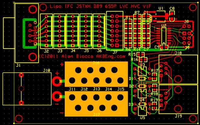

I've partially designed a number of these items, and built a couple versions of the Battery interface, so things are starting to take shape. At this time the elements of my planned eBike control system are:
1) Battery Interface (one per bank), including:
a) cell balancing parallel connectors (done)
b) balancing charger connector (6S DB9) (done)
c) charge current connector (PowerPole15) (done)
d) cell monitoring microprocessor (features below are in design version, not yet built)
e) high current paralleling
f) LVC output (to communications bus)
g) HVC output (to communications bus)
h) communications bus

Here is a version of the Battery Interface pc board.
This one is pretty much complete, but I am working on some improvements before it goes to fabrication.

Battery Interface : prototype boards are fabricated, waiting for assembly and test (fine pitch surface mount)
http://endless-sphere.com/forums/viewto ... 14&t=25706
Note that the DB9 pinout has changed slightly from the older standard. Now the two pins toward each end are parallel for better 6S charging current through that connector. The older connector had ground on both ends. Avoid mixing these. I plan to retire the old boards soon, and in any case avoid mixing them!
