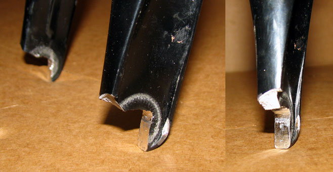

Re: Suitable Suspension Forks for 500-1000W conversion kit
Those are probably designed for weak power, still; not the hardcore folks here at ES
After breaking my suspension fork in half during a 3mph crash, and watching it flex as i hit the brakes when i had 180mm avid disc, there is no way in hell i would go with a front motor. Not for any serious kind of power use.
A suspension fork that is particularly overbuilt might survive with the right torque arms, etc. But most are designed for the lightest weight and most travel possible - 2 things that go against stiffness of a fork.
Do consider rear conversions. There are many benefits. A broken rear mount will not send you over the handlebars, it won't have traction issues, and it won't give you a funny steering feel if you have a particularly heavy front hub motor. Most hub motors also have really poor disc brake side cover machining, so that's a downside if you want to run disc brakes in the front - where they are most critical since the front brakes take more stopping power than the rear, just like a car.
i have an ezee front geared hub motor on my bike.
it has just on 1000W ( 1100W if you let it run to the full 20A limit of the controller)
i have limited mine to 15A (780W) via the CA, and it's fitted to a suntour suspension fork.
i have twin torque arms, and the proper c washers installed.
i have over 1800km on it now, and no signs of anything going wrong so far.
the hub was a perfect fit, no filing needed.
and it has a disc brake too.
i usually pedal up to a few km/h before i open the throttle, just to limit the biggest lump of torque
on the forks.
im not 100% sure what the model number of the fork is, but it was standard fitment to a 2010
Apollo trace urban hybrid bike.it has 80mm travel (i think, from memory)

Steel suspension forks? No you don't. Steel when used in suspension forks is only a sign of cut corners and shoddy quality.
Are you using a front hub motor with suspension forks? If so, don't do that. It's asking for bad trouble. It doesn't matter how thick the dropouts look. They're made of cast aluminum or magnesium and they're intolerant of being pried open the way your motor is doing.
- dogman dan 100 GW
- Posts: 36353
- Joined: May 17 2008 12:53pm
- Location: Las Cruces New Mexico USA
Broken dropouts are usually from not using proper c washers and really good torque arms on a front hub install on a suspension fork.
My best advice, is replace the bike. Get one that is more suitable for a rear motor on it, rather that prematurely wear out or break expensive front forks. My eventual solution was going to longer bikes, which don't need suspension for paved riding, and carry the batteries better. I was lengthening steel frames 6-9 inches. Cheaper than newer bikes, and more practical for commuting than a converted MTB.
You might be stuck with front hub on that bike, like if its got an IGH in back you want to keep. If so, you just got to do a decent preflight on the thing each day. Let a nut get loose, it will break your dropout.
Well, I never found a great suspension fork for use with a front hub motor. But for various reasons, I did nearly all of my commuting to work for 4 years on a front hub bike, limiting it to 1200 peak watts. 22 amps controller, 9 continent style 500w direct drive motor. Mostly I wanted to keep my 9 speed rear gear cluster, and back then rear hubs were hard to find affordably.
I never broke a dropout. Half of this was using pogo stick, piece of crap steel forks that come on a bike shaped object. I just needed some help with the rough pavement. In the deserts in the USA, huge heat cracks hump up the pavement every 20 feet or so, similar to riding over a 2x4 in the road every 20 feet.
Later on, I put a few different aluminum forks on the bikes after upgrading the bike frame. None did well. The pulling force on the fork tended to lock up the fork, so I had effectively a rigid fork over the heat cracks. If I saw an actual pothole coming I had to get off the throttle so the fork would work through the pothole or curb hop.
I was just kind of stuck with this, because of the bike frames I could afford at that time. I was bike commuting because my car was dying, and too deep in debt to fix or replace it.
Put that front hub on a cruiser or something with a cromoly front fork. Get a rear hub for your current bike. A motor will be cheaper in the long run, than ruining expensive forks.
