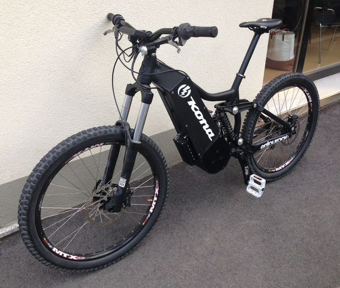

Here is Hannes' (izeman) custom build. The 12-FET controller is mounted to the front of the battery box for air-cooling. Notice there are no wires coming out of it? He slid a 9-FET into the housing for a 12-FET, so that there would be some internal room for routing the wires straight into the battery box. He may have done this partially for a more uncluttered look, but the waterproofing is what caught my attention, and easy to do. Maybe put a 12-FET inside an 18-FET case?
http://www.electricbike.com/hannes-crossbreak-style-mid-drive/
