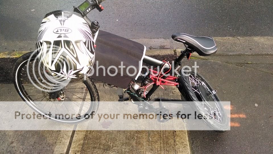

My first ebike project: CNEBikes Co, LTD 48V 1000w 26" rear wheel kit. 20Ah Lithium Ion battery in pvc jacket. PVC rigid side bags, headlight, taillights and other pieces to make bike look retro.

Re: How to get the proper advice, read before asking
I guess I am of the mindset that ALL frames, steel, Aluminum or otherwise need torque arms for any >1000W hub motor. That opens up numerous possibilities for lightweight Aluminum bike frames, and adds a safety factor.
This was the result from not having a clamping / enclosed torque arm on my Chromo Steel drop-outs of the Farfle Swing arm of my Genesis V2100 Build...
Granted, this resulted from testing a controller with an overly aggressive regen braking setting. (The Motor was ripped out of the steel drop-out as I braked.)
These Clamping drop-outs solved the problem:
I have since always used some kind of enclosed torque arm on every DD Hub bike I have built, with no subsequent problems.
A pair of these are cheap insurance: http://www.ebikes.ca/shop/electric-bicy ... rm-v4.html
