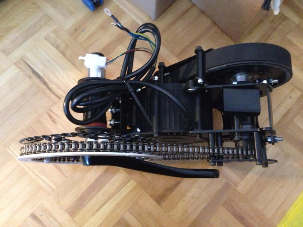

I've started piecing together the main motor and brackets.
So far, there have been some very slight figment issues arising from the coat of paint on the brackets, but so far nothing that's caused serious problems.
As a current gng1.1 user, this is like the ebike version of the movie 'Twins' with gng being Danny DiVito and the LR kit being Arnold Schwarzenegger. Everything is bigger, everything is beefier, everything is (unfortunately) heavier, everything is (so far) as expected!

I'm not sure how much more it weighs but I've dis-and-reassembled my gng so many times that I can tell there's a significant weight difference with the brackets, jack shaft and BB.
For moto seat, I was thinking fiberglass pan...not sure if staples would work or if I could just use glue to apholster. I don't think I'll work on a seat until the battery is attached...the seat may have to fit around the bat.
Here is the kit initially fitted together
Items you will need to get to this point:
- 4mm hex bit
- 5mm hex bit
- 8mm hex bit, socket, and wrench
- 10mm wrench
- No.2 Phillips bit

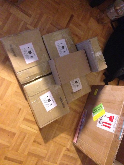

Battery shipment arrived today after a 24hr customs delay. Omg it's glorious!
About half the size and weight of my 48v15ah 26650 pack!
Packaging was excellent. Customs opened it and still very little indication of tampering. The only critique I have is that the small packs have their labels over top of the pack#.
Top left: BMS
Bottom: charger
Large packs: 6s6p
Small packs: 4s6p
So far, 100% satisfied! I would recommend to anyone and I would buy from ex-battery.com again without hesitation.
