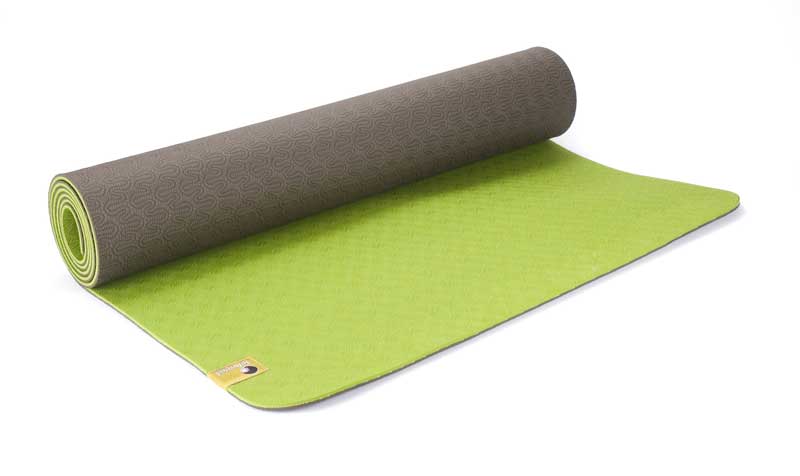

I have often used some cushy stuff on the bottom of the box as well, like a mouse pad or some yoga mat inside the bottom of the box. This is done when the battery will always ride in the bike oriented that way.
I agree with DanD214 above...YOGA PAD...available very cheap in volume at any large sporting-goods athletic-supplies store. Various thicknesses.
Yoga mat's good idea/improvisation. Combining Coroplast is good stuff too.

2 yoga mats, one kids flooring, and 2 pieces of Coroplast! One of the dangers of mentioning to my wife that I need some stuff - but she got it mostly at Good Sammy's, so all good. :D
