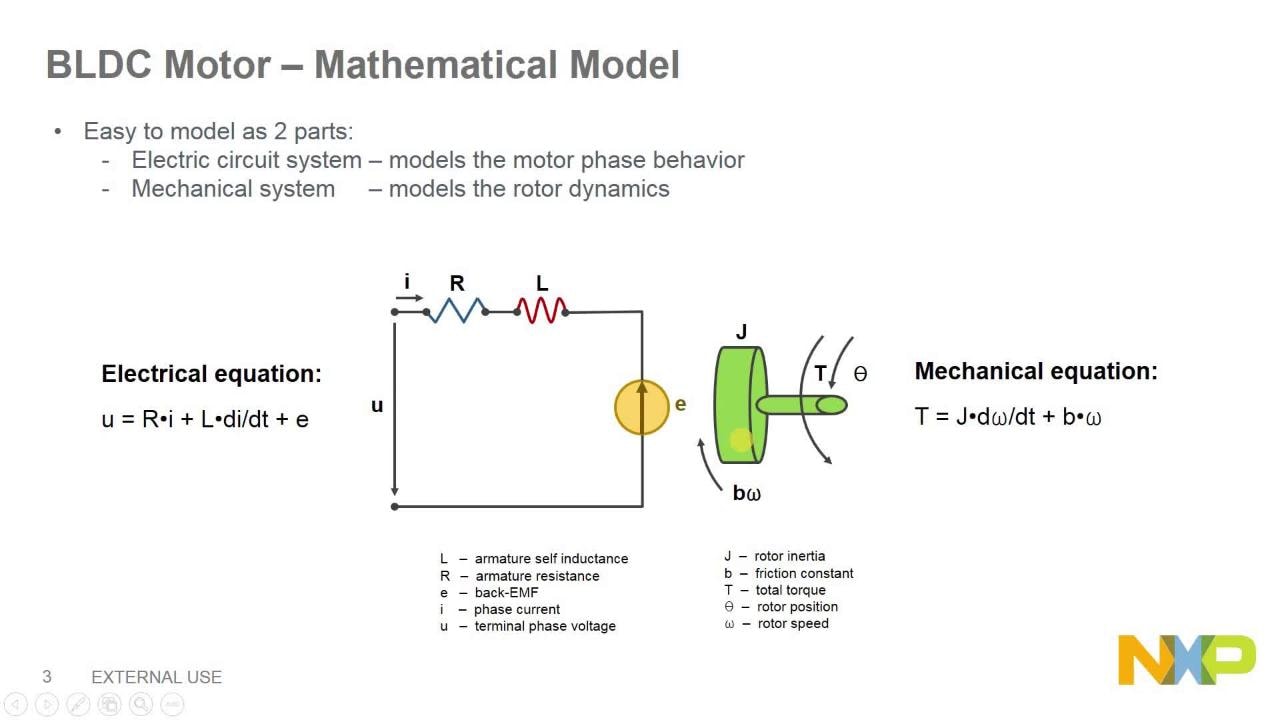

Had a good chance to do some coding recently. I made a few changes:
1) Ported it so I can now run it on F405 (VESC) based hardware
2) Removed all the magic numbers from the main FOC loop
3) Fixed up the sensorless algorithm.
Previously, I was running mainly with hall sensors, though I rode occasionally with the sensorless algorithm I made using a method where I simulated a hall sensor from the back EMF.
The new sensorless algorithm is what I want to write about today, wondering if anyone has any pertinent comments.
My concept (second concept) is as follows:
Vd and Vq are accurately controlled by the PID loops.
Va and Vb are, by necessity kept closely locked in with the rotor back EMF, and are the inverse park transform of the VdVq.
If you were to base the angle directly off the instantaneous back EMF, I think there would be serious stability problems because of rapid changes due to... noise, load... causing sudden back EMF jitter, pushing the angle wrong and then rapid runaway, BUT, if you low pass filter it, the noise and jitter goes away.
Low pass filtering is not desirable since it results in lag and error and slow response. However, we have a system that is strictly cyclical, and where it is therefore not necessary to have a decay time. Sinusoidal.
The integral of a sinusoid being a cosinusoid and so on, if you low pass with no decay, you introduce a phase shift of known magnitude - 90 degrees.
So, we perform the math:

I'll struggle to explain because there's really nothing to it.
It does indeed come from fundamental equations.
Imagine you spin the motor by hand and scope it... You get a3 phase sin wave. Clearly from this, given any snapshot in time you could calculate the rotor position.
If you made the Clark transform of this 3 phase wave, it would be even easier... You'd just take the arctangent and that would be your angle.
When you're driving the motor with pwm, the same still applies but you have to account for current. You can reconstruct the voltage from back EMF from the pwm, and of course it works out to be the Va and Vb of the PI loop and park transform output minus the IR and Ldi/dt.
But this is noisy. If you arctangent this, you get the angle but with horrendous instability and it will positively feed back error the next cycle.
If you integrate however, your sin waves remain sin waves but phase shifted 90 degrees and increased in amplitude with the same absolute noise.
Thus when you take the arctangent, you get a much more accurate estimation of the angle, only phase shifted 90 degrees. So you just shift it by that angle. (Note in the code that it's 180 degrees, this is because the voltage generated is of course in quadrature to the magnetic field so there's a 90+90 phase shift).
There's nothing more to it.
