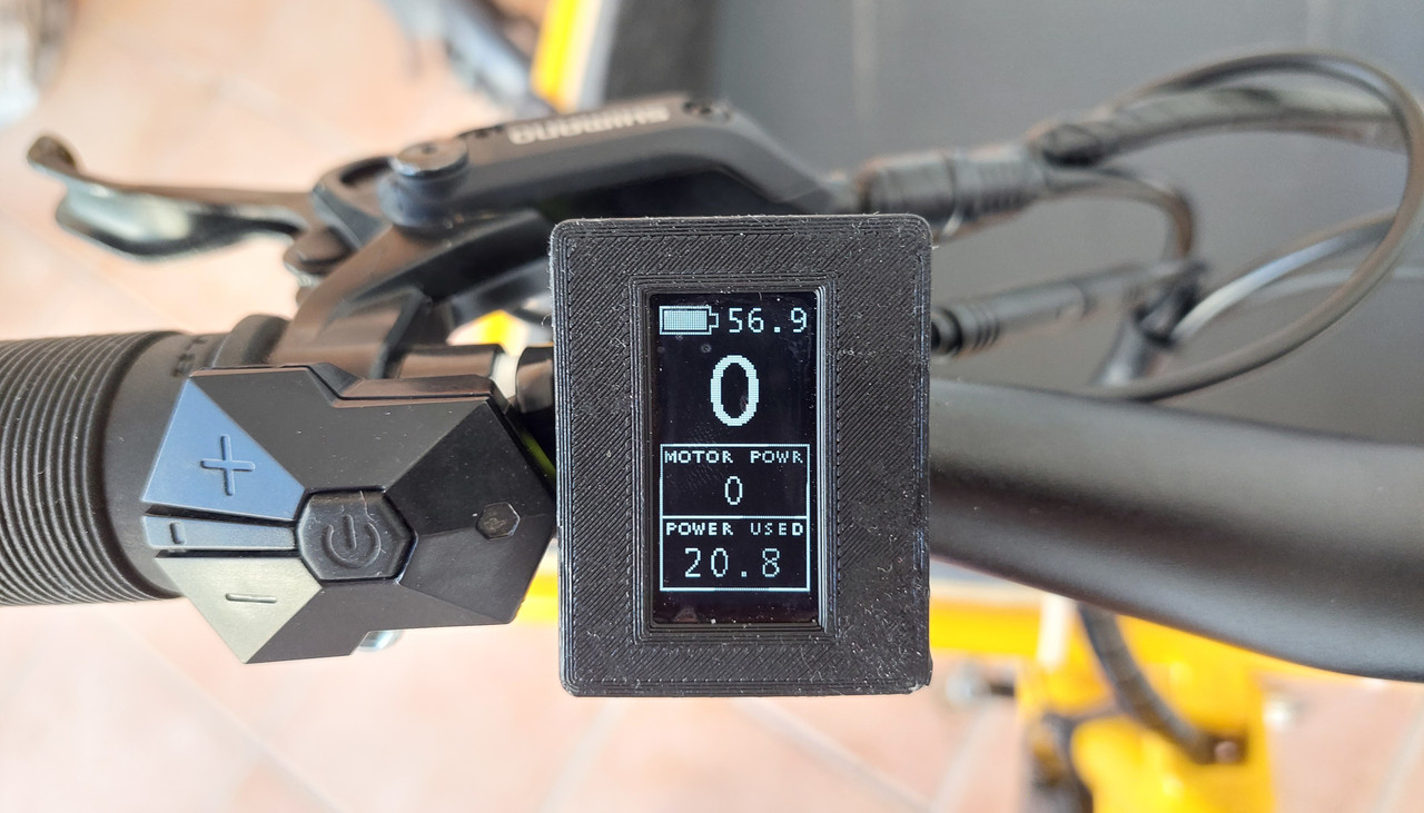

Attention: With v20.1C.3-NEW for stock displays, there is a potential risk of mosfet burn.
I understand that there are many improvements over v20.1C.1, including the deceleration ramp, but better not take the risk.
The calibration procedure is also better with v10.1C.3, but if you want to measure the torque value at multiple points with different weights, better to use another method(also with v20.1C.1).
Set in the configurator:
Data 1 = 6 (adc torque sensor)
Time to displayed data 1 = 0 (unlimited)
Number of data dispayed at lights on = 1
Turning on the lights you will have the adc torque sensor value on the display without time limits.
To get more stable values, it is best to take a short ride before doing the calibration.
Those who have more than one bike immediately realize that the torque sensors are all different, both in terms of range and curve, unfortunately it is well known.
Regarding the graphs you posted, the values to be used are not the measured ones, but those of the range (measured value - offset value), the curves must all start from zero.
Calibration is used to amplify the values of sensors with limited range, as you have assumed in the graph on the right. But the curves will always be different.
However, you can change the amplification by changing the value of "Pedal torque adc max", decreasing the value, the amplification increases, and vice versa.

That is what I did. But for measuring the ‘Pedal torque ADC step’ this does not work, or does it? It is a different procedure.mbrusa wrote: ↑Nov 18 2021 4:13amThe calibration procedure is also better with v10.1C.3, but if you want to measure the torque value at multiple points with different weights, better to use another method(also with v20.1C.1).
Time to displayed data 1 = 0 (unlimited) ...
Sure, but I wanted to show the raw data. The graphs show what is really going on with the sensors when you pedal with different thrust (torque).mbrusa wrote: ↑Nov 18 2021 4:13amThose who have more than one bike immediately realize that the torque sensors are all different, both in terms of range and curve, unfortunately it is well known.
And the zero point can be chosen by calibration, so it is somewhat arbitrary.
Some of the stability problems might arise from the fact that the ADC values depend on angle. Together with temperature drift the zero point might not always actually produce 'zero.'
"Pedal torque adc max" decides the amplification? Or is it the difference "Pedal torque adc max" - "Pedal torque adc offset" ?mbrusa wrote: ↑Nov 18 2021 4:13amCalibration is used to amplify the values of sensors with limited range, as you have assumed in the graph on the right. But the curves will always be different.
What is the role of "Pedal torque adc step"? It has no influence on amplification?

For the calibration of "Pedal torque adc step" there is only the procedure described in the manual.That is what I did. But for measuring the ‘Pedal torque ADC step’ this does not work, or does it? It is a different procedure.
It is true, the zero point is the most delicate aspect of calibration.Sure, but I wanted to show the raw data. The graphs show what is really going on with the sensors when you pedal with different thrust (torque).
The adc value of the torque sensor is very unstable, not only due to the pedal position and the temperature, there can also be a mechanical drift in a short time (minutes), which is usually recovered after a pause (hours) and can be a mechanical drift in a long time (months) that is no longer recovered.
Furthermore, when switched on, some sensors reach a stable value quickly, while others very slowly, the expected initial time may not be enough.
For this reason, in the v20.1C * versions, with calibration enabled, I had foreseen a fixed zero point (offset value), while with calibration disabled the zero point is acquired at each power up.
Fixed zero point was not a good idea, periodic calibration is required.
With a motor, I found myself after six months, the "Pedal torque adc offset" and "Pedal torque adc max" values both higher of 30 points.
In the next version "Pedal torque adc offset" will always be acquired when switched on.
It is the difference between "Pedal torque adc max" - "Pedal torque adc offset" that decides the amplification."Pedal torque adc max" decides the amplification? Or is it the difference "Pedal torque adc max" - "Pedal torque adc offset" ?
Decreasing the value of "Pedal torque adc max" decreases the range and consequently increases the amplification.
While with "Pedal torque adc offset", you can change the sensitivity at the start, decreasing the value increases the sensitivity, increasing the value decreases the sensitivity.
I realized that these settings are not very intuitive, in the next version there will be two specific parameters for starting sensitivity and range amplification.
"Pedal torque adc step" also affects amplification, only in "Power assist" mode and partially "Hybrid assist" mode.
The value obtained from the calibration is used to calculate the correct ratio between the assistance factor% and the human power, and the value of the human power to be shown on the display.

Re: TSDZ2 OSF for all displays, VLCD5-VLCD6-XH18, LCD3, 860C-850C-SW102.
Sorry for took so many time to link this project on the wiki. Finally I did a relevant update to the project and so finally I added links to other projects - I removed from the wiki the references to SW102 and 850C/860C displays!
I were betting on TSDZ2 fully wireless (and I reused this project mobile app) using a wireless remote but I found it was very frustrating having only a LED to give feedback for user, like to see battery SOC user would need to count LED blinks.
I decided to move back again for very small display but reusing the TSDZ2 wireless hardware + using the SW102 display firmware we did developed, so the final result is a DIY simple display that still has Bluetooth and ANT communications, that works for tiny 0.96 and small 1.3 inches 128x64 OLED displays like SW102. It is easy to repair as also easy to customize with some extra electronics so it can be reused on other devices, like adding CANBUS communication so it can work with more recent Bafang motors or popular EScooters like Xiaomi M365: https://opensourceebike.github.io/
- TSDZ2 and OpenSource EV display: 128x64 OLED display, easy to build as DIY, Bluetooth and ANT, OTA wireless updates, easy to repair and customize for other EVs.
- TSDZ2 OpenSource firmware
Developer of OpenSource knowledge and technology for ebikes: OpenSource EV display, Wireless EBike standard ANT+ and Bluetooth, TSDZ2 OpenSource firmware, KT motor controllers and displays.
