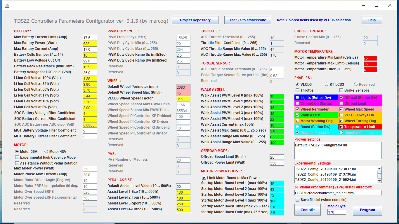

Ok i try...I have use java front-end and i have Done many experiment
Max battery current limit i have tried 15,17,20,30a
The same in max battery current
Max battery power 600,800,1200w
Even whith Low amp there is a Cut off when the motor reach max power
I try to ad a file of An exemple

You have error
0x004003 max is 18A you have 20A ( 14 exa ) soo max must be 12 in exa
may be somme other error i will check later
edit :
Sorry mistake from me .
0x004003 is : DEFAULT_VALUE_BATTERY_MAX_CURRENT
soo if your batterie can give 20A it s OK .
0x004021 you have 01 witch mean you enabled " default value temperature limit features " dont thinck could be the problem .
other parameters are ok
I m using marqoc data with a 36V motor and 11S battery and first test with 10S battery, never experimented problems .

thank you for your interest! i have traied whith 15a , bike it's very slow but the cut-off remain!

Hi guys.
Soon I will release a new version of the java configurator that should solve the problem of engine power loss. With the new configurator it will also be possible to enable a delay time when the walk assist button is released. The "offroad" mode will be enabled by default, by programming the lights key it will be possible to enable the "normal" mode and possibly set the speed and power limits.

Marcoq said that there is a small bug ... or rather two in the new java interface
As soon as possible marcoq will release a new version of the configurator with these fixed bug.
- Walk Assist Off Delay PWM (100%) is wrong write because the parameter is in seconds (0 ... 25.5sec) so you have to change it in Walk Assist Off Delay (Max 25.5sec).
- During the compilation in the .ini file saved a zero is added immediately after the parameter mentioned above (Walk Assist Off Delay PWM (100%), It's enought to edit the .ini file create (folder "experimental settings") and delete the zero to solve the problem. Otherwise you can not use the .ini file to program the engine.

Elem
Do you know of a document that explains the values that can be used for each Data Memory item and how to calculate?
Sorry, but I am new to programing.
Re: Tsdz2 firmware open souce adapted to vlcd5
https://drive.google.com/drive/folders/ ... ThYxbeIJ7b
here is the doc marcoq gave us to modify data memory .
some value are decimal, other hexadecimal ( must us a link like : http://sebastienguillon.com/test/javasc ... sseur.html to convert if you don t know )
especialy assist level are hexadecimal ...
here is the link in the open source tread where marcoq gave this text : viewtopic.php?f=30&t=93818&start=1425#p1432926
here is the link when he explained " how to " : viewtopic.php?f=30&t=93818&start=1400#p1432873
in my google drive all ancient prog and explanations if needed, as for now gift hub has changed i thinck it s not possible to find original archive ( may be in an other place !? ) all are in my google doc, all in the compressed file if needed .
