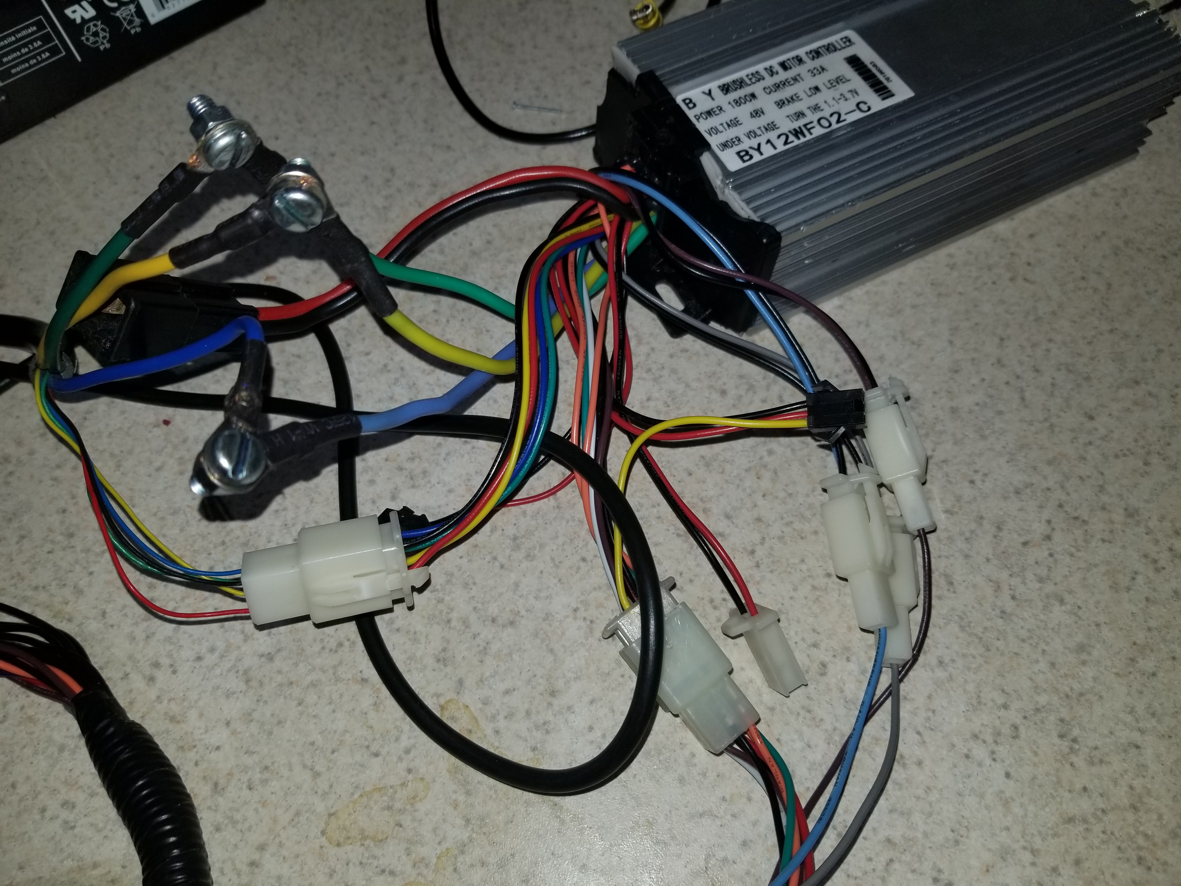

Hello everyone,
I am working on a go kart project that has been on hold because we cannot get the motor to run
The motor is an 1800W BLDC: MY 1020
While the controller included a wiring diagram, I am still unable to successfully run the motor.
I have connected the three phase wires for the motor (green, yellow, blue) and the hall sensor plug block of five wires from the speed controller to the motor. This system seems to have a harness that leads to a set of other wires which is why I have attached a second picture below.
The wiring diagram says the orange and red wire is the ignition switch, and so I tried connecting them together and plugging in the battery but still nothing happens
Please help me out
There is no second picture, and nothing is attached.
There is a single link to a site that gives me just a blank page except for thumbnails that couldn't be related to your post.
If you use the attachments tab below the text entry box when posting, and add files, you can upload your pictures directly to the forum so that anyone that can read your post can see your images. Without that, there are people that might have been able to help that will not be able to, because tehy will not have all the information.
You say there is a "system" that already has a set of wires.
What exactly are you starting out with, vehicle and all components, and what exactly are you adding, and what exactly are you removing? A complete list is necessary, including connections you have removed and connections you have made.

Did you end up getting it working, I just got the same one but I haven't tested it yet I did notice mine has a connection labeled electrical lock not sure if that's the ignition one you were referring too but if yours has it then this may be needs to be connected for it to power up.
What power source were you using to power it? If you have a multimeter it might be worth checking the voltage and make sure the big red and black wires are done up tight. image.jpeg
