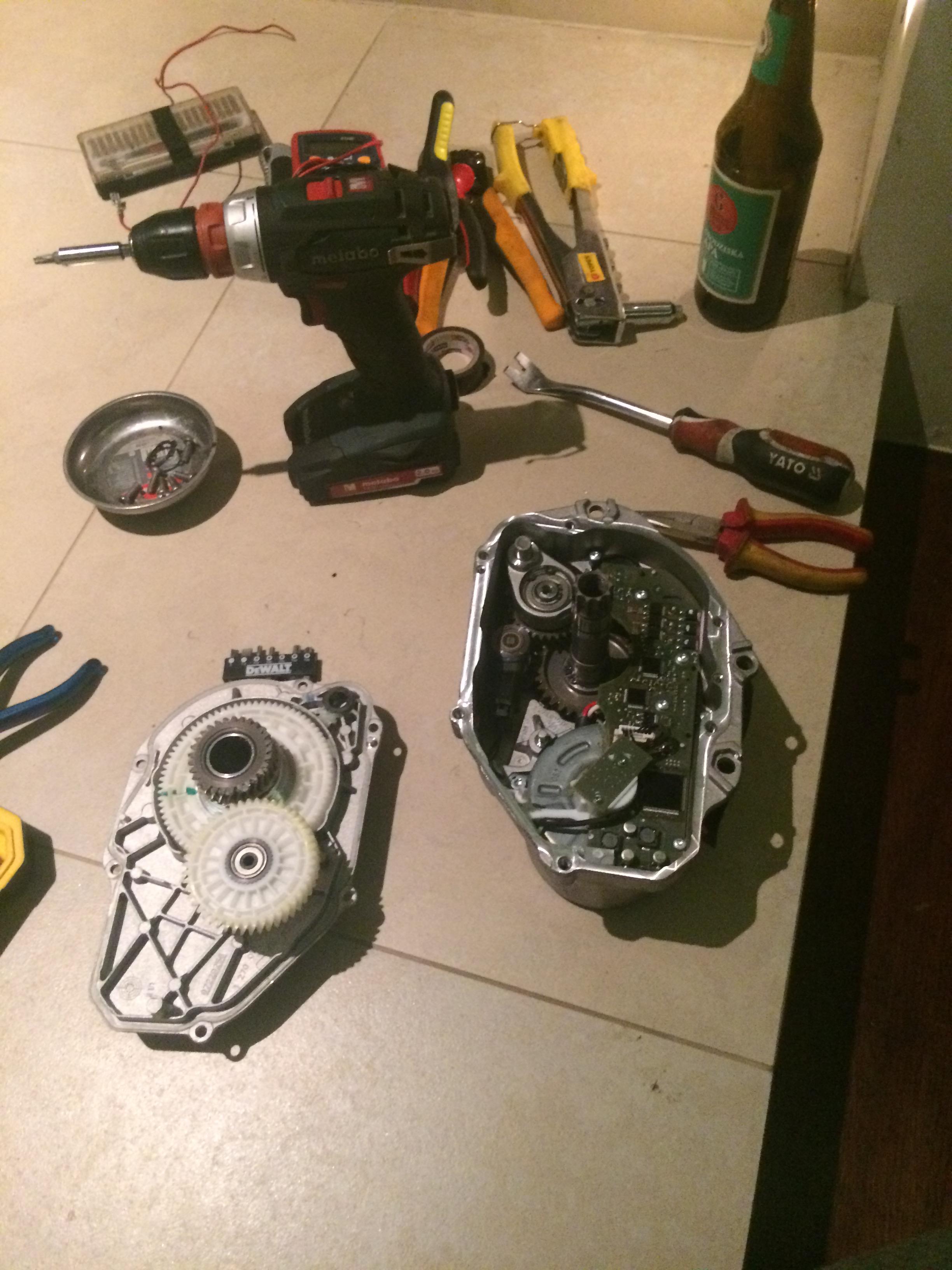

So i got this engine for cheap - scrap value almost. I disassembled it, removing the controller and one other PCB which to seemed to be the hall sensor (correct me if I'm wrong).

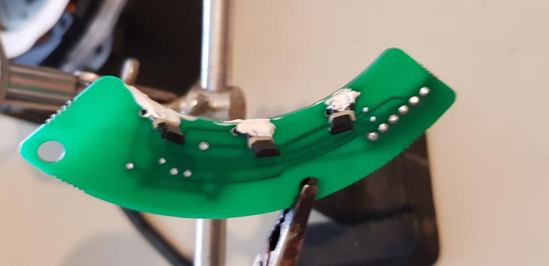

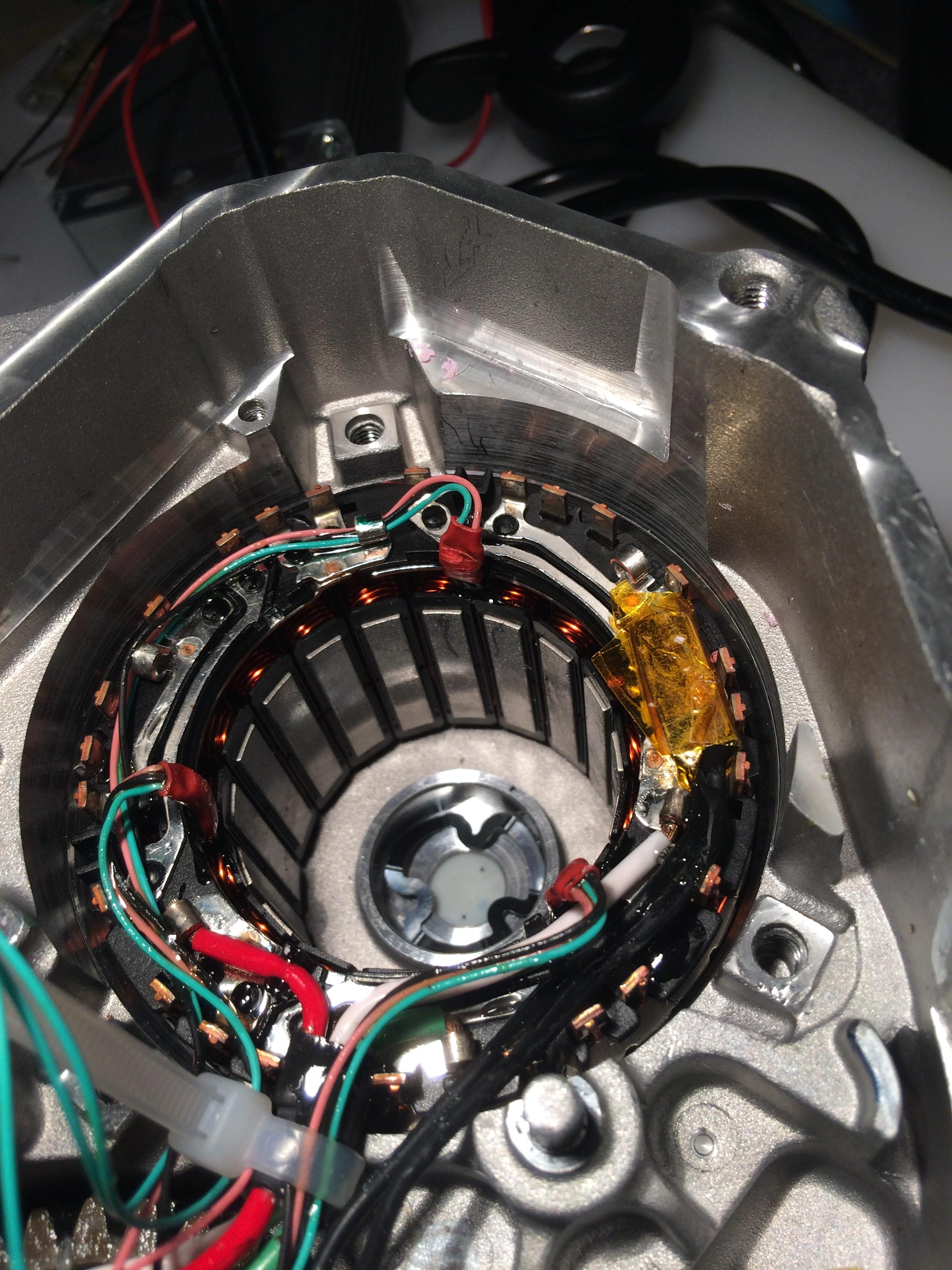

After disassembly my first obstacle seemed to be the lack of hall sensor in the motor itself (just three phase wires coming out of it), but it didn't stop me. I bought SS41 halls which I knew worked well with chinese controllers and placed them in the motor assembly:
Also in the picture you can see the 125deg.C termal protection that i glued with heat transfering glue.
Halls are placed 120 degrees apart form each other as the rotor has 14 poles (calculations based on this guide - http://mitrocketscience.blogspot.com/20 ... r.html?m=1).

@gazoo:Based on the pics your hall sensors are placed too deep? It just might me the pics but:
They should be on the surface of the stator laminations towards the magnets. Or facing the ends of the magnets
Revolt motors place the halls deep and the effect is that as soon as the current is increased the coil fields switch the hall sensor in the wrong time instead of the magnets switching the halls - you get a cutout due to hall error.
@andrea104kg: Sensored controllers are mostly useless for startup with load - not recommended. the halls should be fixed instead!
@leffex: Hall placement can either be 120 degrees mechanical apart or 120 degrees electrical apart. It does the same job. Electric degrees=(mech degrees)*(pole pairs no)
That this works is because it should be 120 degrees electrical between the sensors for almost all controllers, 120 mechanical is always same as 120 degrees electrical no matter how many magnet poles there are but the opposite is not true. There’s plenty of data here on ES or google it.
