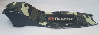

I got some camouflage grip tape for the deck and a decent set of grips but I'm still waiting for the 1600w nominal hub too clear postage on aliexpress then it's 20-40 days post so gonna be 2019 till this one sees some serious riding again.
I got my grip tape today so I got that fitted I don't think I needed to show a how to it's just a taredown handfile and a knife then reassemble.

Glued my razor grip tape on top of the cammo looks beast and hides the fold mark the seller of the cammo put on it in an envelope not a tube.
