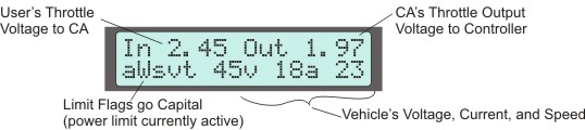

If you look at the Diagnostic screen on the CA, the first one to the "left" of the main screen (one push of the left button when on the main screen), what are all of the things you see there? Since it is all text you can type it in exactly as you see it, including any letters that are capitalized or lowercase exactly as the screen shows. See the end of the post for a quote of Grin's page and a picture of the screen.
You should also verify that the actual voltage at the controller's throttle input wire is indeed changing with the CA output readings, using a voltmeter or multimeter, so that you know it's not a simple connection or wire problem. ;)
Display #12 – Diagnostics
The final display screen is most useful when initially setting up the CA for various feedback and control modes. On the top line you can see both the input throttle voltage from the user, as well as the output voltage that the CA is sending to the motor controller.
CA Screen #12, Diagnostics with Throttle Input and Output Voltages
The bottom line has a row of limit flags showing which throttle limiting feedback loops are currently engaged. So if you are exceeding the speed limit, the ‘s’ becomes a large ‘S’, and similar flags for the current limit (a/A), power limit (w/W), low voltage rollback (v/V), and thermal rollback (t/T). If for instance you have the bike setup for proportional pedalec assist, then the commanded power limit of the CA is being set by your pedal effort, and so the power limit flag ‘W’ will be set showing that the CA is in a power limit control loop.

When I am on the main diagnostic screen this is what I see when my throttle is resting
In 0.85 Out 1.2
awsvt 76v 0A 0
and under full load the CA diagnostics screen reads
In 4.23 Out 4.39
awsvt 76V 0A 0

Those appear to be normal, except for the controller not drawing any current at full throttle. ;)
The all-lowercase awsvt indicates that no limiting is occuring inside the CA, as any active limits would be capitalized. Similarly, if the CA were limiting, it would be reducing the throttle voltage output, which it isn't doing since the Out value is at your max throttle out value.
