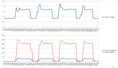

I had the Baserunner plugged into my laptop while doing the tests, and this last phase yielded data that looked like this:
The X-axis is time in seconds. Unfortunately the Baserunner logging tempo is less than once a second, so the data pictured here is just an indication, with a lot of variation that happens in fractions of a second missing (like the peaks for example).
Ignore the speed value - it's kph, plus the Baserunner has a very imprecise wheel setting parameter.
However, this is the closest I have ever been to the behaviour described in the CA manual, so I'm hopeful.
The settle time appears to be in the 8-10 second range. That may be the next thing to work on.

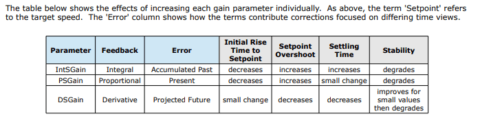

Going forward, I am going to be guided by this part of the CA Unofficial User Guide:
The chart suggests that increasing DS has the effect I seek (decreasing overshoot and decreasing settle time) so that is where I will start. Over the course of a ride I'll increase DS around 10% a time until I get a noticeable change. At that point I will know whether it's a change worth having - I'm hoping for the power roll off during acceleration that I could briefly see on the trainer.

Now for the meat:
PSGain: How on earth did I get to 4.87 V/MPH, I hear you ask. Well, it took a while. I figured that the default in a factory reset CA3 is 1.01 V/KPH. Now, if you change the units to miles, the PSGain stays at the default, i.e. 1.01 V/MPH. This is a much lower setting than 1.01 V/KPH. To get back on parity, the setting should be 1.62 V/MPH. With that as the default, I increase in multiples until I got to 3 times the default - as the CA3 manual suggests might be needed. (For some reason me setting 4.86 has turned into 4.87 - doesn't make a difference.)
ISGain: Starting at the default (50), I lowered the value until the speed limiting (flashing mph on the main display) was in effect from a low speed. I then stepped the value up in increments of 5 until I got a steady settle from just below the target speed. It's hard to describe - mainly reduced time to settle but also reduced overshoot. Higher than 70 yields too much overshoot. This value can still be fine tuned I think.
DSGain: (The value is actually 1000, the CA application only displays up to 3 digits - Setting on actual CA is 4 digits.) This setting comes from increasing DSGain from the default (300) until I could hear and feel the power getting skittish (sort of on/off cycle around the settle point). I then backed away until the skittishness stopped.

Here are some graphs from a stretch of road on my last ride with the settings I posted above. I'm afraid you need to zoom in with your browser to see what's going on.
This shows the elevation profile of the stretch, and my speed. At the start I come off a downhill section, turn a corner, and head off. The graph shows a rapid settle around 16 mph, and then holding 16 mph with a couple of down-up fluctuations. The first was caused by a combination of rough road and gradient increase. The second was where I turned off the main road onto a side road (and thus stopped pedalling for a short bit).
This graph shows the gradient, which is mostly around 0.8%. The bit of note is a short dip, followed by a short ramp of 5%. On the speed and cadence graphs there is almost no fluctuation at this point.
This graph shows my pedal cadence. Despite my assertion in the last post that I usually pedal in the 85-95 rpm range, I decided to do this stretch at around 80 rpm. Since I did not change gear after the start, fluctuations in my cadence are directly proportionate to the speed, except close to the end where I negotiated a turn off the main road onto a side road. PID control handled that well I think.
I think this shows a well functioning PID algorithm. Small overshoot at the start, then settle and hold. The feel in my legs was of a constant effort, supported at different places with just enough power to keep the speed stable. No surging.
This outcome was impossible when I started, so I could say I'm pleased.
