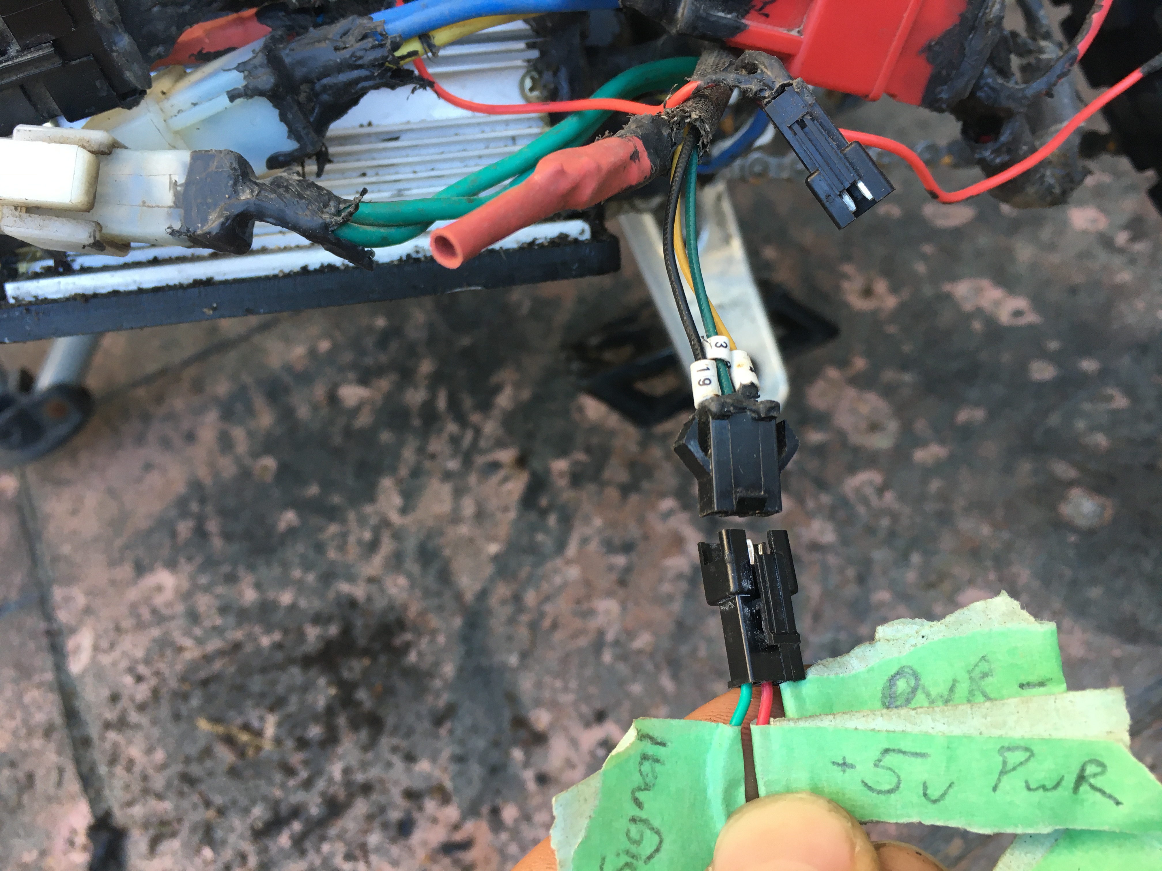

I have an older kit, Cyclone 1680w with a KBS48101L controller.
with a OBO twist throttle.
Recently the throttle no longer works and I cannot find a replacement with the same wiring. The controller gives me a Red LED and turns off with the old throttle wired up. Clearing an OK on the controller. :thumb:
This is what was coming from the old throttle.
It has a 3 pin and a two pin connector.
Which the 3pin is coming out of the controller.
The two pin. The battery + and - leads into a two pin connector on the Battery side. A third cable comes out of that connector which is one cable of the 2-pin. (Let me know if anything is unclear.) The second cable of the Two pin then leads into the Female connector on the controller side which then leads the the motor. I imagine this is simply the Switch 15?. But I am unsure I will wire it right.

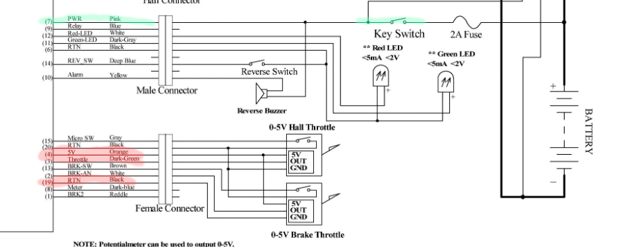

I was hoping I could get some clarification on the wiring layout. I have referenced the kelly controllers wiring schematic diagram but there is some things unclear when replacing the throttle.
I will attach some images to help explain what the wiring situation looks like.
Regarding the two pin connector it looks like it is the Micro Switch (15) ?
However, Now the three pin connector doesn't look like it matches with the three pin on the new throttle I purchased.

https://kellycontroller.com.ua/download/KBS-L/KellyKBS-LUserManual.pdf -- Kelly wiring.
On the three pin I have cables 19, 3 and 4.
The new throttle along with the three pin ( With masking Tape, has two power lines if you look at the tiny url amazon link. One with a switch and one without ) Would the Switch be the main from battery (Light blue on Schematic) then the other power power return into the controller? The way the ORO wired does not match at all to this new throttle. I saw a three pin on amazon and assumed it'd be a snap.
The two pin I am unsure I don't see number labels. Here is where I need help. I imagine with the new throttle it would be a switch first then power return? Can any one offer any assistance? I don't want to short anything out. I think one of the cables from the battery to the Controller would be 7 also a part of that two pin connector.. There is a risk I could short the battery's BMS if I don't know what I'm doing.
I am thinking just cutting out the Two pin. Wiring the switch first from battery then power return (see the new throttle). (the old ORO has a green wire in parallel on the two pin which I imagine is the switch referencing an Older post) Now I have two cables. So I think the yellow from new throttle from the Battery connector then the Blue towards the controller? The old had 3 cables into the two pin.
Then splicing the three pin into the appropriate cables. Which don't appear to match the old three pin in pin order.
But I imagine I take the 5v+ on throttle and wire it to 4 on Controller. The Negative to the RTN 19. And 'Signal to 3' which is throttle on the Controller schematic. Can anyone confirm?
Is there any drop in replacement for the ORO? So I don't need to splice wires? Any grey beards with some experience able to help a newb out would be appreciated.
