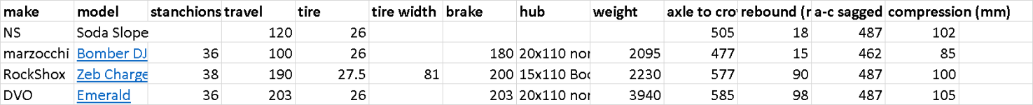

My short-travel frame with 107mm of rear travel is spec'd for 69deg headtube angle with 505mm axle-to-crown fork-- about 120mm travel.
However, I selected a fork based on characteristics: unobtrusive single-crown, modern stiff Boost spacing, robust tapered steerer and 38mm stanchions, 200mm direct-mount brake, bolt-on fender, low weight and cost. The resulting fork is offered in 150mm-190mm travel.
I made an Excel sheet to illustrate the differences.
At 15% sag, the spec'd fork would sag to 487mm axle-to-crown, have 18mm of rebound travel and 102mm of compression travel.
While I've included a 100mm fork similar to spec, as well as a double-crown USD fork, I would point to the 190mm travel RockShox Zeb.
I know the general concern with longer travel forks is greater pedal pump (not relevant on a throttle e-bike), and slackening the headtube angle and thus upseting the steering geometry. However, the spec'd 487mm axle-to-crown (and thus HTA) could be matched with the 190mm fork by sagging down 90mm, leaving 100mm of compression travel. However, the softer spring rate would give greater mechanical traction.
Yes, in rebound, the 190mm travel fork would still rebound out to 577mm instead of 505mm, and thus slacken the headtube angle. However, this would only seem to occur when (completely) unweighing the front end, as during hard acceleration (wheelie), in which case steering inputs are marginal to begin with. In fact, having greater rebound travel should allow the front end to maintain traction and steering with greater rearward weight transfer.
If I've already "paid the price" for long-travel in terms of weight and cost to order to satisfy other requirements, why limit that travel?
If you set sag to 47% (90mm/190mm) then your spring rate will be far too soft in the front and you'll blow through the remaining 100mm just by braking hard or leaning forwards. It'll be like riding a boat.

Thanks. I was worried about brake dive, but hoped it could be mitigated by using volume spacers to reduce air volume and thus ramp up spring rate under compression. I planned to start without any and work up to max, but perhaps I should start with the max and test down?

You could pack it out to reduce the volume, but it's kinda diminishing returns.
Another thing to consider, when you need to lift the front wheel while riding, for whatever reason, that added sag will make it a real pita. Say bye bye to hopping the bike over obstacles.

I'll start out with max volume spacers, drop the rear to 33% sag, and plan on lowering CG height.
Good point about hopping, but since the use profile will be that of a light moped/motorcycle, I'd expect to unweight the front end and use the long, soft suspension to ride over obstacles anyway, rather than hopping over them.

I know this is a self-induced problem, and I do appreciate the brainstorms, but raising the rear ride height just introduces other handling problems, it doesn't solve them. Not only do you sacrifice what little (10-15%?) rebound travel you had (= no dip compliance), but the increased CG height increases longitudinal load transfer, worsening brake dive. Assuming an air spring, the increased spring rate to raise the rear would also reduce compliance and mechanical traction. A coil spring to separate ride height and spring rate would only resolve that last disadvantage.
Good discussion, but I still think sagging the front to maintain steering geometry is the best approach, at least on paper...

I just realized that switching from 26" to 27.5" increases wheel+tire diameter by ~41mm, and thus ride height by ~21mm.
I think I need to add this 21mm to the axle-to-crown length, thus requiring even more sag to restore ride height.
Restricting sag to 50% raises effective a-c at ride height from 487mm to 503mm = 16mm, slackening HTA less than one degree.
