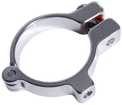

I don't think two bosses are enough to support any but the smallest frame mounted batteries. The last time I had one (shark pack, about 10 pounds), I used three clamp-on bosses of this kind:
https://www.chainreactioncycles.com/mobile/us/en/dmr-hinged-clamp/rp-prod745
prod745_Silver_NE_01
For a 15 pound pack, I'd want four mounting points, but two of them could be the existing frame bosses (built up with washers to the same height as the clamp-on bosses).
Those clamps look like a good inexpensive solution, especially with a bit of rubber between the frame and the clamp. For what it's worth I installed this: https://ebikes.ca/triple-bob.html on a customer's bike and it was solid as a rock with their small (10S4P) shark pack, I'm sure it would be good for nearly double the weight.

Thanks Chalo, those clamp bosses are very interesting!
This is a helpful discussion. For now I'm planning to put it in the bottle cage mounts first just to check out how it seems. I've ordered a triangle bag for actually riding. And now I think I will order a couple of those bosses to check out.
