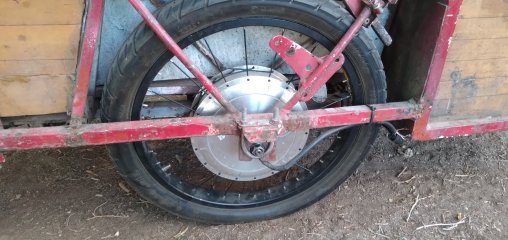

So...I get to test this Z-bend idea out way sooner than I wanted to:
https://endless-sphere.com/forums/viewtopic.php?f=2&t=67833&p=1736417#p1736417
https://endless-sphere.com/forums/download/file.php?id=324880

What happened? Foreign object damage?
I don't know exactly what happened, everything was normal, then it wasn't. Nothing in the road, so nothing to have gotten into the spokes, just BANG and...that. (see the link in the post above for more details).
The only time I've seen spokes break at the thread ends the spoke and the nipple were not collinear.
Or to say it in a different way ... the spoke exited the nipple at an angle.
From your picture it doesn't look to be the case here.
Larger spoke gauge, more spokes or change of spoke brand ?
Link to homemade or purchased "Z" bend tools are in post 1 and 3 of this thread.
That's a messed up wheel failure AW! I'd probably rebuild the whole wheel with new or different spokes.
The spoke angle looks pretty close to 90 degrees in your wheel. Is it better to use slightly longer spokes to have a more acute angle where they enter the rim? Somewhere between radial and 1 cross pattern. Ive never done this but seems like others have.

Interesting to note that it was the "inside" spokes that broke ... perhaps a clue to the reason ?
This creative vehicle looks to be rather weighty for the spoke count in the wheel.
Low spoke count combined with some sort of side load likely contributed to the failure.
FWIW, none of the other hubmotor wheels I've used (built by me, unlike this one) on this trike have had this kind of problem, even when I've been unable to avoid some serious potholes that damaged the rim (completely crushing the rim wall down to the inner rim surface (where the rim tape covers the spoke nipple holes), and even one impact that broke the motor axle itself (separate from the times the axles were broken by motor torque).
So it's something specific about this OEM A2B Metro rear wheel itself, either the length of the spokes (threads not fully into nipples) or the quality of them (manufacturing problem?) or even some prior stress the wheel experienced before I got it. Perhaps it's even the rim itself, though I doubt it: this is an Alex DM32, while the ones I built my wheels on are some unmarked 50mm eyeletted doublewall rims that were NOS ex-Zero rims from back when the Zero started out kinda more like a high-powered electric bike vs a motorcycle.
I think these broken spokes are 12g, maybe 13g. Don't know what brand.
They're all 36-spoke wheels. I've used the Sapim 13/14 butted from Grin Tech for some of my builds, and the straight 13g from them for a couple of others. I have had a couple of broken spokes (three? four?) one at a time over the last several years on different wheels, which is normal in my experiences for the kind of heavy cargo hauling I do and the road conditions and whatnot (back before I electrimotorificated my stuff, even my regular bike wheels broke the occasional spoke with this kind of loading).
There is definitely sideloading during turns, but as noted before , it hasn't been a problem with other wheels that I've run much much longer than this one (this has only been on there since the end of April this year... the other one I built with the same kind of motor on the ex-zero rim has been used since June of 2019 (and is presently back on there now as it's my only functioning spare motor wheel that fits the trike. Some pics from back when I built it
https://endless-sphere.com/forums/viewtopic.php?f=2&t=67833&p=1477114&hilit=stromer#p1477114 ; note the damaged rim I used to build it (not really by choice, had to change the motor because of motor problems but didn't have a rim for this new motor); I have a new rim to replace that with...eventually. :oops:
And while I'm very glad that none of the outboard spokes broke, I am surprised that it was only the inboard ones (all of them except four around the valve stem area).
Also...I've never experienced a simultaneous failure of more than a handful of spokes, and that was from (IIRC) a stick in a regular bike wheel, ages ago (and all the spokes involved were seriously bent, where all of these are straight except for one that has jammed itself between the rim and the flange and the load on it bent it).

This is a wierd one.....
What is the weight of your creation ?
Too much--it's a few hundred pounds. I don't have a current measurement, but with my almost 200lbs on it, and my tools/daily work stuff, etc., it's probably getting up around 600lbs, and most of that is on the rear end, and just in front of it at the seatbox area. Not much is on the front wheel.
(A future version will use much larger pedicab rear wheels moved farther back to more evenly distribute the load and give a better ride, but the present version is what I have to work with for the foreseeable future).
No where near enough spoke density for the task.
Either increase the spoke diameter or spoke count.
With radial lacing it's super easy to hand drill the hub and rim to double the volume of spokes.
Curious: Why does it work for the other wheels then, with no even remotely similar failure? I have a difficult time believing it would be blind luck, not for this long.
It's much more likely to be something insufficient about these specific spokes, or the wheel build itself, or it's prior stresses before I got it.
Increasing the spoke diameter (assuming these are already 12 or 13g) would be a problem because the rim would not handle the tension required, and I'd be right back to the same problems of the too-thick spokes of OEM hubmotor wheels that did fail easily (where the thinner spokes don't).
Increasing the number of spokes wouldn't be too tough if it becomes necessary, but it has not been so in the past with any other similar wheel--just this one has had this problem, for no "obvious" reason. It has not even seen anywhere near the amount of stress any other similar wheel used on here has seen; not the same loading, distance, torque, impacts, etc--the four primary differences I can think of ATM are that it used a bigger softer tire for almost all of my usage of it, it uses a narrower rim, it uses different spokes, and it wasn't built by me.
I would need to get a new spoke nipple tool, as the one I have couldn't be used properly in a double-density-spoke wheel (at least, not with my hands).
I still need to disassemble the rest of the wheel to see how the stuff that didnt' fail was setup, and examine the broken remains of the rest to see if they are different; I'll post pics in the previously-linked SB Cruiser thread along with my speculations and conclusions.
For now, unless something in the failure analysis leads me elsewhere, I think I will just respoke it as-is, but into one of the two new ex-Zero rims Chalo sent me (because they're a little wider than the Alex and easier to get the Shinko tires on and off of without worrying about pinching the tube), ensuring the threading is fully in the nipple body as it should be, etc.
