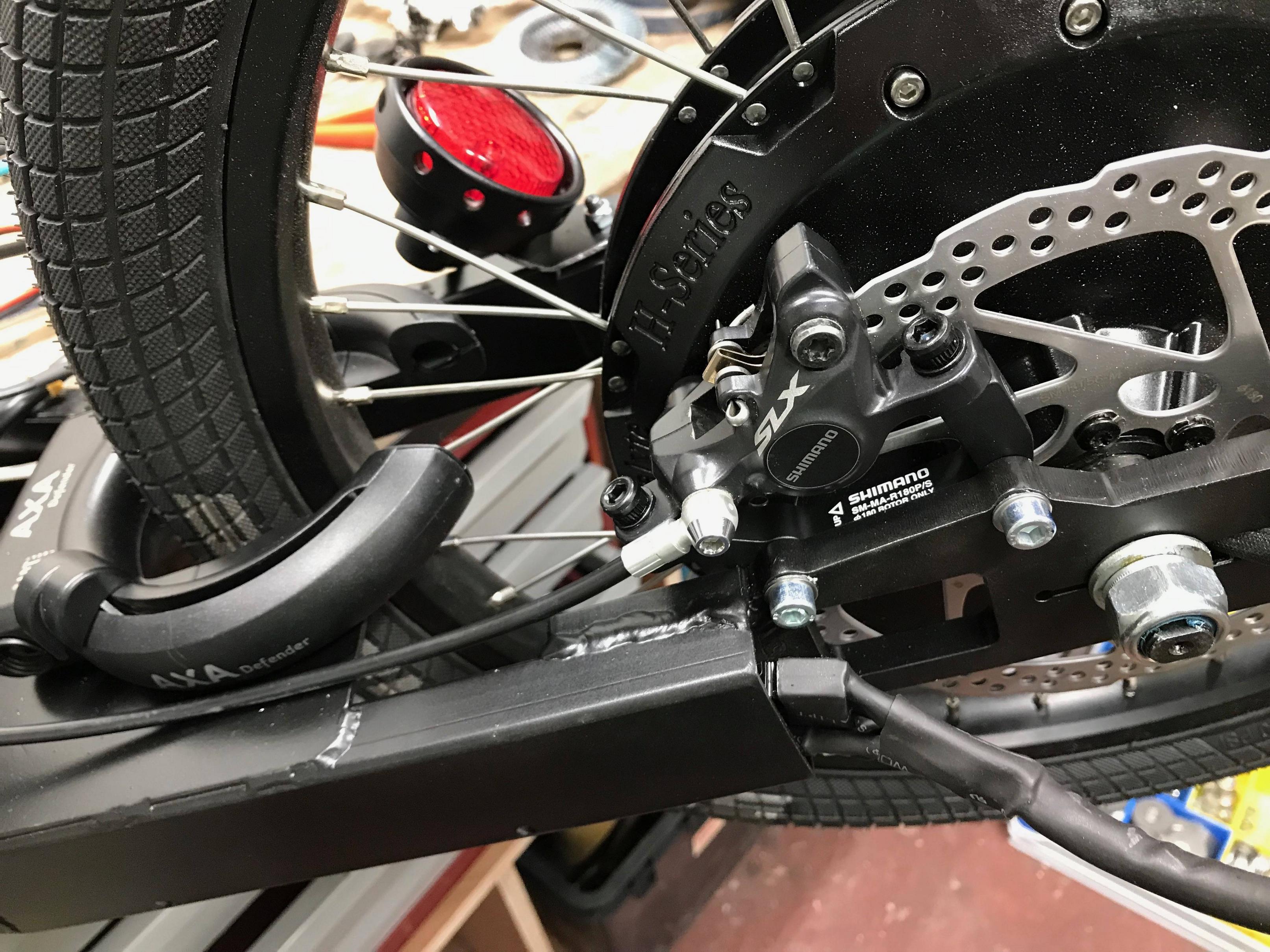

Finished painting,
wel could use another coat or two, but can't wait anymore to start assembly.
The pinch-plates work wonders. They axle is a snug fit on its own. Tightening the clampd own on the axle makes it rock solid. And adding the bolts on the axle makes it even more solid. This motor is only 3.000W, but I'm confident this mount can handle up to 10x times the power with no issue.
The mount for the hydraulic disc brake is a standard ISO mount, I'm happy that it goes together perfectly. It is my first time designing a part like this and am really happy with how it turned out and that it works perfectly.

Thanks for your feedback.
Having the bolts a bit further helps to have leverage on the clamp. It closes it a bit behind. But I'm sure it would work just as well having them closer to the axle.
It is rock solid this way, but I'm sure that would work just as well. Main thing is to have a large clamping area (here 10mm plate) and a way to tighten it down with force. Here the opening is already tight and you can tight it down hard with an M10 bolt on one side. The slight cut is to allow a bit more flex in the part without bending.
The bolts are on the outside, so no issue fitting a chain with this type of mount should you wish. But yes, indeed I don't have chain on this build.

Got everything together. It was a tight fit with all the electronics and large (14S7P) battery, but it worked out. Need to finish some little things, like bleeding the brakes and putting some skateboard tape on the plywood and securing it someway. But was able to take it for a spin. Acceleration is great and everything works as expected.
The clamp on the hub axle is great and really holds it firmly. This can take some serious abuse.
