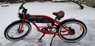

I was looking for a mode of transportation that would work for me and that was available for me to try before buying. This led me to purchasing a 350W Michael Blast Greaser from a local power sport shop in July and when the weather was good enough for me to ride it was a great first electric. I want to boost it's abilities and make a fun commuter for inner-city as well as being able to ride to neighbouring towns and cities. Here is an overview of my project, all input is appreciated.
Requirements:
-Abide by Canadian Laws- rated 500W, >120kg bike weight
-Ability to reach 50km/h with 170lb driver
-Carry a passenger at 30km/h
-Minimum 50km range, would like to double or triple
Wants:
-Regenerative braking
-Integrated brake and signal lights, horn(s) (quiet for paths and loud for road)
-Improve suspension
Front fork suspension worth it?
Custom plunger shock unit attached to rear? (BMW R25)
Seat suspension?
-Improved aesthetics
Cafe racer seat attached with custom seat post
Custom fibreglass shells+faux tank for electronics/storage
Wiring a different display unit into existing electronics, such as: https://www.aliexpress.com/item/32851537129.html
Current Bike Specs:
Motor: BAFANG 350W Geared Brushless Rear Hub Electric Motor
Battery: Samsung Lithium Ion 36Volt13Ah
Propulsion: Pedal assist via 12 magnet cadence sensors with twist throttle
Gears: 5 speed motor assist with 7 speed Shimano Acera
Brakes: Tektro Hydraulic Auriga (180 mm front / 160 mm rear)
Controller: Control freak 18Ah
Trip Computer: LCD 5 speed display
Frame: A6061 Aluminum Tig welded
Fork: Double Down Chromolly / CNC Alu Made crown set
Stem and Handle bar: Promax Aluminium
Tires: Duro, Beach Bum 26’x 3.00, 15-36PSI
Weight capacity: 260 lbs (118 kg)
Product Weight: 63 lbs (28.6 kg)
Pictures:
Other Notes:
I bought this bike because I was diagnosed with a disease similar to MS and didn't feel safe driving a car anymore. Originally I was looking for a scooter with a motorcycle aesthetic but the Greaser was a better fit and in my price range at the time, it's been great to ride around town. I can't do the metal work so I'll be talking to local fabricators, however I do enjoy making and I will try my hand at the fibreglass. I also own a 3d printer for producing plastic parts up to 200mm³.
Update 29/12/19:
I'm going to break up this project into three parts: integrated signals/headlight, seat+shell, and system upgrade. Working through these in order will let me budget for the motor and battery while still making progress on the looks, storage, and safety.
Update 03/01/20:
Really liked the simple spring suspension for the seat from: https://endless-sphere.com/forums/viewtopic.php?f=6&t=92640, implemented it into my own plan.
Planned System Upgrade:
Motor: GMAC10T
Controller: Baserunner
Batteries: Hailong jumbo case 14S6P, Hailong case 14S5P

I opened up the shell to see how things are setup inside:
There seems to be a lot of unused space and the shell is twice as wide as the battery. I wasn't able to figure out how to remove the battery itself, I have a key for it to unlock and I see what looks like a button to depress but nothing seemed to be working. As for overheating I've seen thermal fins added to hubs before, is that a practical way to manage heat?
The bafang controller has an unused cable for regenerative breaking, would adding these brake levers and splitter make it work?

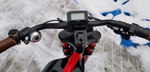

Thank you for all the information. I want to keep things simple as this is my only current independent mode of transportation. I've figured out the wiring harness for thecontroller:
From the controller the thinnest wire leads to the pedal sensor, while one wire leads to the motor and the other leads to a splitter.
The three wires at the top go to the lcd, throttle and the unused brake sensor. The wire leading right powers the front LED headlight and is probably the best way for me to power integrated signal lights. I can't find any information about the specs of the LED so I don't know how much power I have to work with for a signalling circuit.
Is it possible to add more battery to a controller/battery setup like this safely without opening it up?
After a lot of gusto I was able to get the connection to the LED off and found a red 2-pin connector, I'm assuming to find available voltage for a circuit I would just use a multimeter with those two pins? (edit: found out that it is not possible) I'm also looking online for another 2-pin cable so I do as little damage to the existing electronics as possible.
edit: I was only able to find one website with the 2-pin connectors
https://hilleater.ca/2-pin-higo-style-e-bike-headlight-y-splitter-cable/

The cafe racer seat arrived today:
My initial plan is to have posts fabricated like the ones on the saddle seat, and then use the clamp on the seat post. This will let me adjust it's positioning to test the best fit. The fenders on the bike are too small compared to the seat. I've been looking for where the best place to buy fenders that provide more coverage and have only found hollandbikeshop.com other than amazon, but everything seems too small for a 3" cruiser tire.
edit: found these http://store.ruff-cycles.com/ruff-cycles-bicycle-parts/wheels-tires/fenders/ruff-cycles-fender-set-26-inch-black.html
