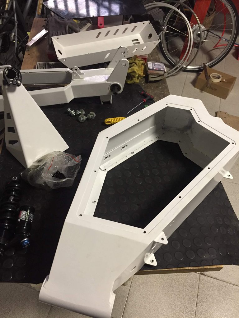

Hi everyone!
I've been working on a 3000W e-bike build for the past months and I found lots of useful information and tips here on ES.
So, I decided to share my build so far and get some tips hopefully :D
Using a chinese copy of an ebb frame that I got here in Portugal for 200€ + rear shock (crazy price, the guy was desperate) and MXUS 3K-Turbo.
Frame and shock.

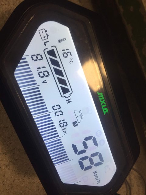

Display that came with the motor kit on full throttle

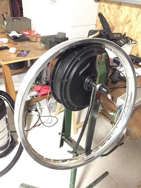

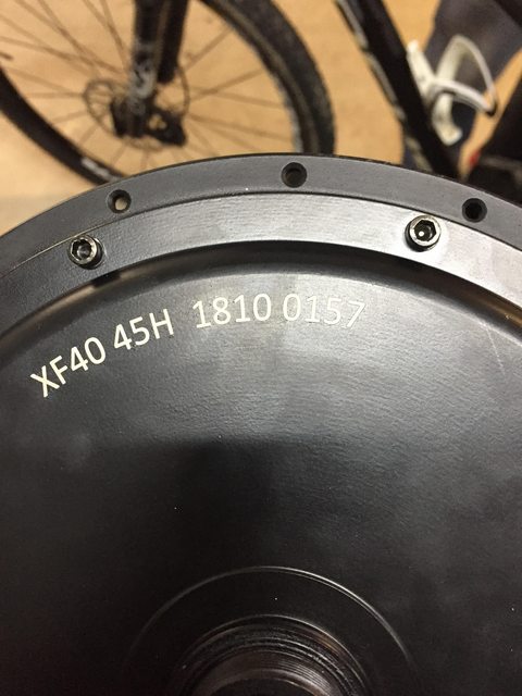

Right now I'm trying to figure out which winding the motor has, because there is no visible markings on the motor it self.
On 82V the motor seams to run at about 590RPM, that concluded from my calculations using the iPhones slow-mo :lol:
It pulls about 1A at that voltage which unfortunately seams to point that it is a 5T winding, I was looking for a 3-4T :cry:

PS: I also did a 3D drawing of the frame I have (not all dimensions are as they should) on Solidworks.
was it purchased new or used?
if new, you should have been able to specify which winding you wanted, or it should have said which one it was. (if you were looking for a specific winding, and it didn't say, and the seller couldn't tell you, then i do kinda wonder "why buy it?")
anyway, you can try to compare your test results with those from http://ebikes.ca/simulator using the same setup, to see if it matches any of the windings listed there. they are under mxus 4503 4504 4505 4506.
alternately, you can open the motor and see what the marking is on the stator--often they are marked with their winding (not always though).

A friend of mine bought 5 ebike motors to save on customs here to portugal, honestly I was ignorant at the time and didn't even know these could come in different windings..
I have looked on that simulator and it seams to be the 5T.

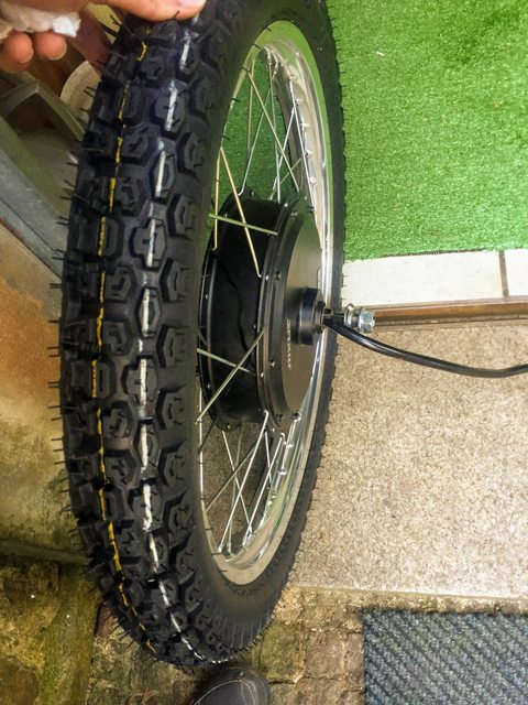

Today I bought the rear rim.
It's a 19" by 1.40 aluminum rim made here in Portugal and was about 60€
Will get the spokes tomorrow, still deciding on a one or two cross pattern...
since that rim has angled nipple holes, the cross pattern is determined by the angle the nipples will come out of them at.
if you don't follow that angle, the spokes are going to be bent where they enter the nipples, and since that part is prestressed by the threading, they'll eventually start breaking there.
if you have a spare nipple laying around of the right gauge for that rim, you can eyeball what the angle is going to be; even better if you also have a spoke (even if it's not the right length) to "draw a line" from the nipple thru the flange hole.
there's a number of sites with spoke calculators, but this particular motor is already in the database at http://ebikes.ca in their spoke calculator. the rim wont' be, so you will have to follow the instructions on the site to measure the specific dimensions the calculator will need from you to give you the right spoke length.
Yes, that was my guess in the beginning.
As a matter of fact I do have a 3mm spoke and nipple that was given to me kindly by the shop owner and I will do that!
I was using Sapim Spoke Calculator which is for bike wheels but would be close enough. I did not know about the spoke calculator on ebikes.ca, thank you!

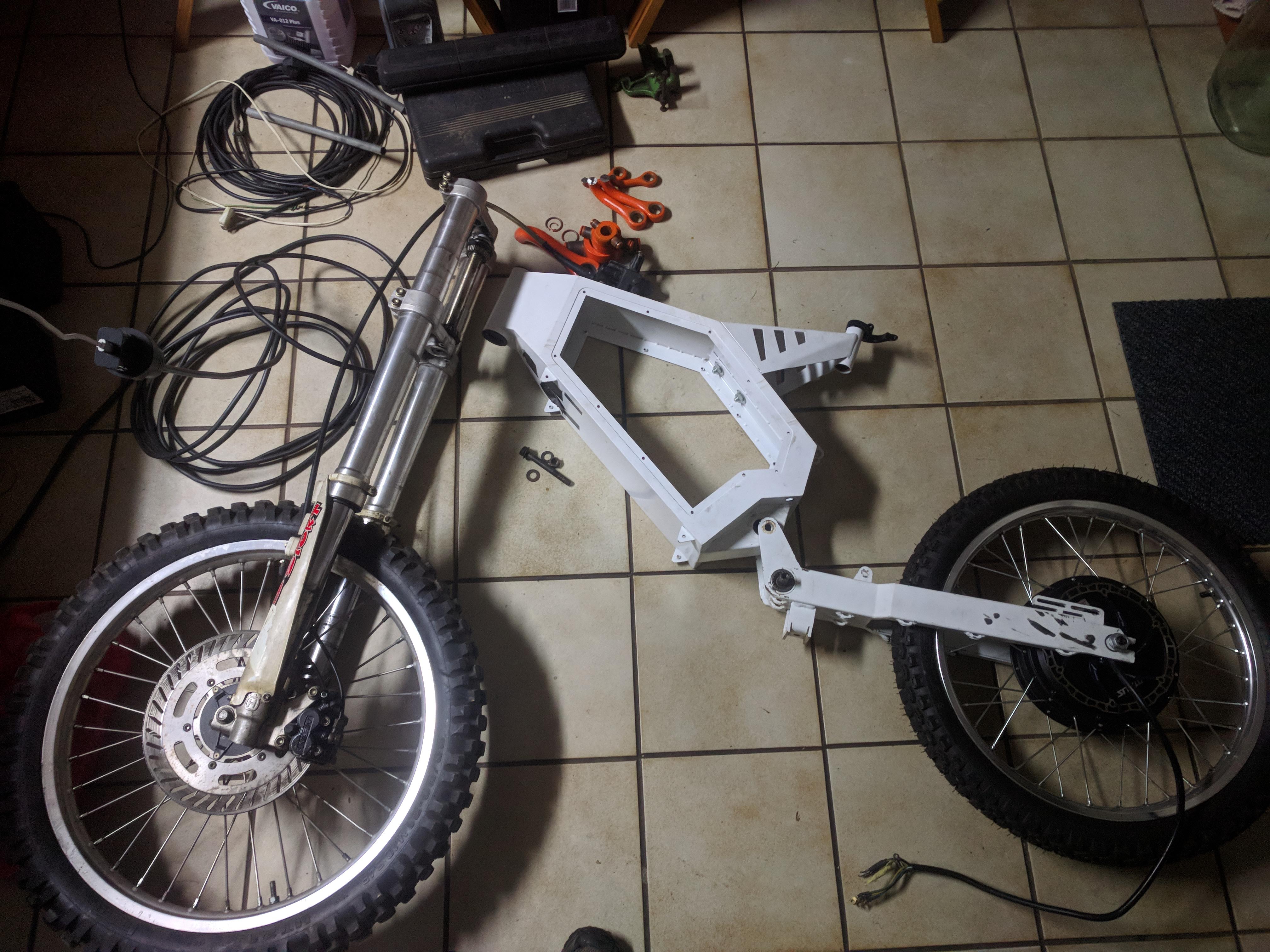

With all the difficulties due to the virus, progress as been going slow but fortunately I've been able to do some work.
Here is the back tire for now, it was really cheap but will do for now.
19" x 2.75
And right now I am truing the wheel, I've got the lacing well done but need a way to consistently tension the spokes correctly.
The rear wheel is complete! After a lot of effort putting the tire on and scratching the rim :cry: I was able to assemble it complete.
Here's how it looks:
Also, the bead would not seat properly after mounting, I used soapy water and inflated the tire almost up to 7 bar (100 psi) and it wouldn't pop. After lots of tries of inflating and deflating I just let it sit in 7 bar for 15 min and when I came back it was almost perfectly seated... :lol:
Hi everyone!
There has been progress on the build, after the rear wheel was assembled I mounted it in the frame, got an old fork and wheel from a bike and the rest of the components from the transmission and also bought a cheap shimano hidraulic brake kit for now.

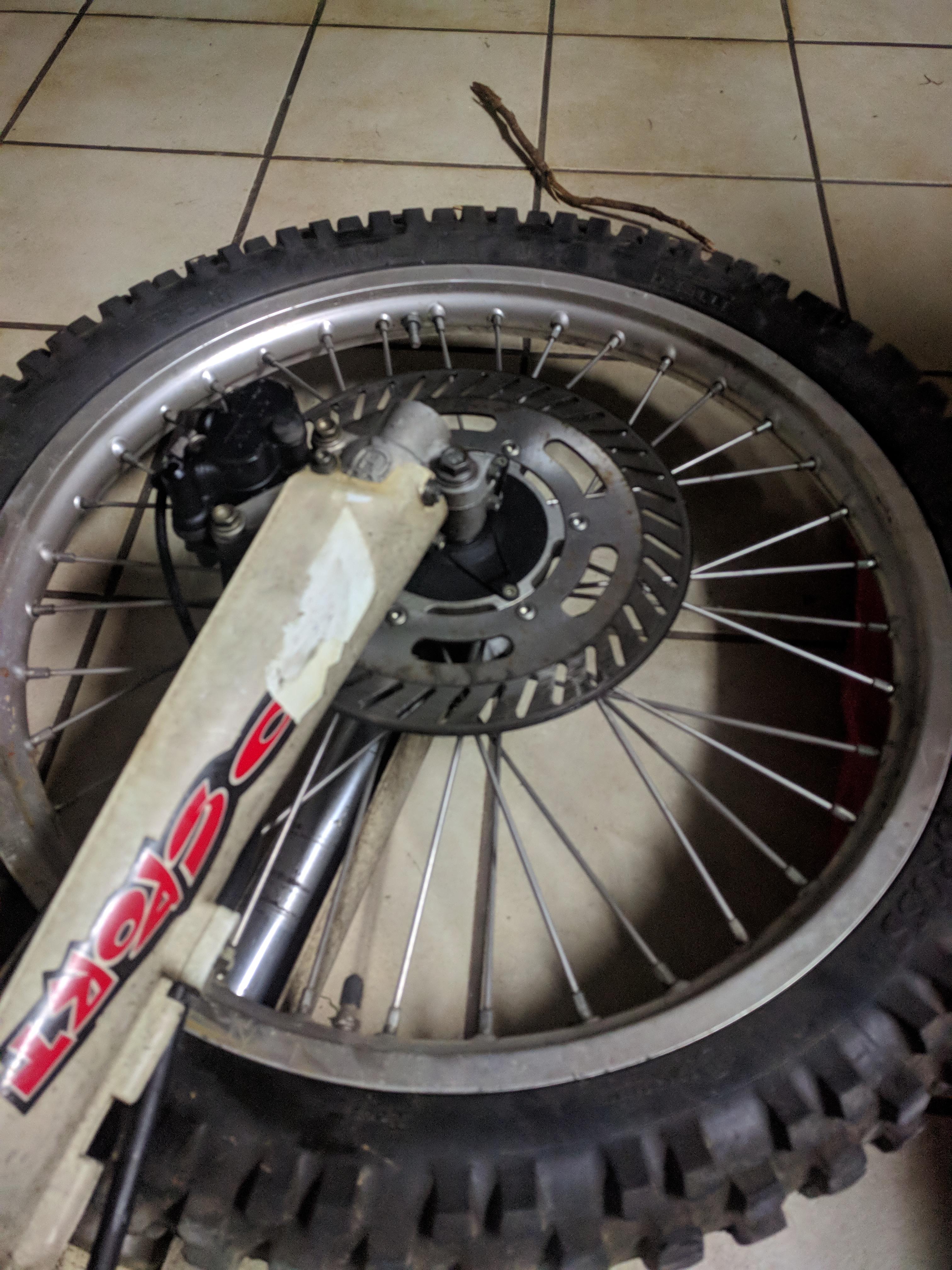

Last weekend I got a dirt bike suspension, front wheel and brakes for 150€.
It's gonna need some adaptation but in my opinion is way better brakes and suspension than I could get new for the value.

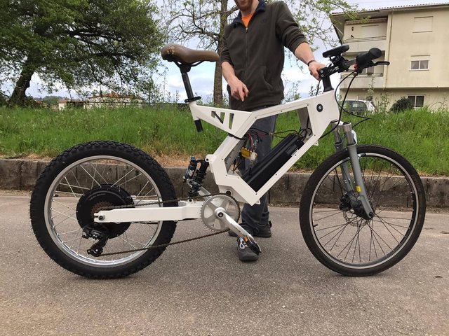

Hi how's it going? I have the same frame :)
I had to modify that little section underneath to allow space for my controller (100a sabvoton)
Currently waiting on my rear wheel (motor) then it will be just about finished :)
Are you sure a 26" wheel won't fit in the swing arm? as the advert stated it would
Nice controller! :flame:
It does fit but I am using motorcicle wheels on my bike.
My rear wheel is a 19'' x 1.40 with 2.5'' tyres
My front is 21''x1.40 with 2''
