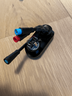

Hey, the original anti spark switch I used blew, I swapped it out with this one:
https://flipsky.net/products/anti-spark-switch-smart-280a-for-electric-skateboard-ebike-scooter-robots?_pos=1&_sid=279ba950c&_ss=r
But because this was a bit larger that the first one, I wrapped the whole thing in insulating tape and did not use the 3D printed part anymore. (sadly, because the 3D printed part was way nicer to stuff into the tube)

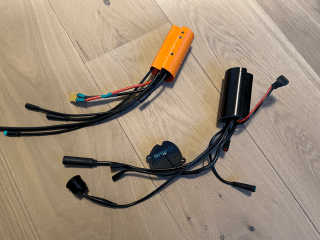

Here is a picture of all the connectors on the original ampler controller
I remember now, the 5 pin green one might be a "normal" Julet connector, not a Julet mini
This one:
https://nl.aliexpress.com/item/4001091169417.html?spm=a2g0s.12269583.0.0.20463c1eZzJOIv&gatewayAdapt=glo2nld
And of course don't forget the 9 pin motor connector and battery connector

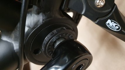

Question upfront: your bike was equipped with BBTS1.0 torque and speed sensor. Outer Geometry of my 2021 Curt seems to be same. Anybody able to confirm that 2021 Curt is also using BBTS1.0?
Maybe you can tell from the outside, here are some pictures of mine
Thanks a lot for your really quick response.
My Bike looks @ left side comparable to yours, @ right side (belt drive) different - see photos.

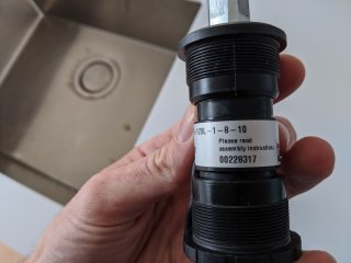

NCTE is absolutely matching to your photos
https://www.ebike-solutions.com/de/shop/teile-fuer-steuersysteme/tretsensoren/ncte-sensorisches-4-kant-tretlager.html?number=aepasnc128L-01
but different to mine.
Yes that's different from mine on the side of the sprocket
You can try e-mail the manufacturer for specifications

Torque Sensor: NCTE SBBRT - 120L - 1 -5 - 20 | 6 Pin Connector
Till this point of time it was unclear wether this Sensor will fit into my Amlper Curt.

- Integrate my NCTE Torque Sensor into the Ampler Bike (geometry was 100% compatible despite connector)
