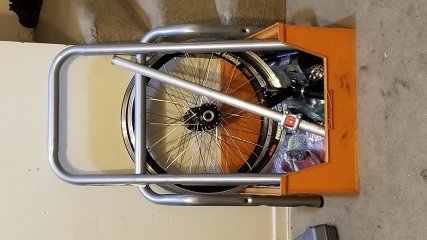

Of all things that have sparked inspiration, was a cast-off bicycle carrier sitting curbside a few months back, that i disassembled for hardware. Relative to tubing scale, a Perimeter frame setup would take care of both the decking and internal storage requirements for battery and electrics, that i have on my wants list. This will also allow me to build in a modular fashion the suspension setup, with built in flexibility for the overall setup by adjusting either perimeter frame, or suspension geometry.. I think the bicycle carrier being of mild thin wall steel is too light, but it does provide some inspiration. I don't need to go much heavier with a perimeter frame, with reinforced mounting points for sub assemblies.
I've got, or will get the materials within the next week to 'start playing' with some ideas. and this parts box will be joined by many others.

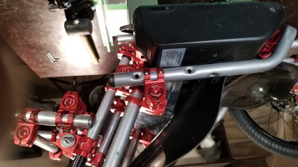

It's definitely going to be a battle of limited space, ambition, reality vs fantasy design. I rather suspect that i will dead-end on several aspects of my goals, or will need different approaches. I don't think i'll be using near as much bicycle components in fabrication, as i initially thought - but i will be using a lot.. i've also got that eMTB to play with to use up parts, in terms of the original Cain Hashimoto design being based on an eMTB, if i choose to go there after.
I will have some creative design input.. component matching, for no-weld solutions for example. There will also be plenty of time for hand fabrication of various aluminum plates to make things fit. This is above all, a creative design exercise to me.
I'm stuck behind several key orders not shown up yet. I've picked up a sample section of tubing i need to start experimenting with (1" and 1.25" by 3/32") but can't do much without proper tubing shims, or one of the key steering stem types needed.
That said, i've had enough show up, that i can start assembling computer desk Eye-Candy. Components potentially intended to use in rough configuration.
Plan here, is to use 90mm Steering head tube sets, with 45/45 BMX Bearing sets (inbound), mounted within 45mm billet aluminum clamps, originally intended for steering stabilizers. I would need to do additional machining work/tapping to nut-stop the clamp assembly fasteners, and an addition of a sub-bracket on top of these clamps to connect to the Helm joints i will be using. This will make for a 4 point extended steering bracket knuckle assembly.
I'm already having some regrets in some components being used - i realize now, this method of spindle and pivot is ideal for rigid trikes - not what i am working towards. I'll make it work with additional work/aggravation since i have got that much cost into it already, but i really should have looked at 20mm MTB wheel spindle based options using a billet fabricated knuckle, instead. That's the fault of my impatience to get things going, as well as general aversion to the garage in the winter months.

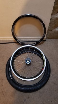

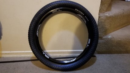

Parts have come in for the wheelset upgrade - i just need to order spokes at this point - i should have just bought hubs and gone from there, at this rate.. live and learn at some expense. I will be running 'Odyssey Aitken' semi-block BMX 20"x2.45 tires on them.
When i am speaking of 'perimeter frame', i am speaking of this general plan-form of a Modified KMX setup - perhaps - minus the center section deleted entirely. Depends on how rigid that i can make things, in terms of frame setup. My boxed in section would be structural, rather than secondary storage in nature, as in the KMX. Again, comes down to space being worked with.. i'll know where i'm going when pipe and components start hitting the carpet. I've got a hard-shell seat inbound, to work with in terms of overall dimensions, in experimenting with all this. I guess in some ways, i'm trying to combine 'kart' with 'Recumbent' in terms of design.

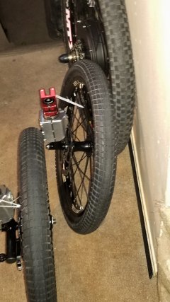

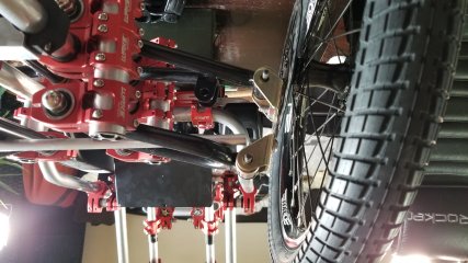

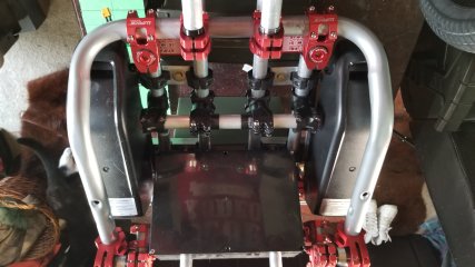

Well, plans are definitely fluid, in terms of shifting goals. I've got lots of Pie in the Sky ideas - but the more i look at things, i am fighting multiple issues - complexity, dimensional vs material limitations, and my own over-ambition. I need to look a this in terms of a modular approach. I'm working with materials that can be reconfigured to a certain extent (no weld principle) so i can experiment with setup whenever i bloody well want to, once i get an actual base-goal of a fully suspended eTrike actualized. Everything else is secondary.. including keeping to a simplified, low-cost drive train for now.. rather than stepping up to a QS motor and 72 Volts right away.
48V 1000/1500w will do fine for now, so i ordered the simple, economical solution to my needs.
I picked up a CSC 26" rear hub setup, with the upgraded 30mm rim. Went over the Spokes for tightness, and put a 26"x2.40 Maxxis Holy Roller tire on it. Should be good for Traction on the Trails.
I received all of my first round of the major parts orders this past weekend .. and in very short order, built up the Wheel-sets to be used. T2 Halo 32mm BMX rims, mated to the original hubs. 180mm rotors. Front tires are Odyssey Aitkens at 20" x 2.45".
The observant can see my steering methodology has already changed - i am essentially 'blocking' the Steerer Tube into a clamp bracket - I will then devise a methodology of suspension mounting, involving a plate bracket onto this. These were originally Jeep YJ (i think) Steering arm damper mounts that i have reprofiled on the backside already, to clear the brake rotor behind it. Red Steerer stems are just placeholders at the moment, to keep things tight and together.
I wanted to go the Cain Hashimoto way, with his methodology of 1" tubing and steering tube stems, but i simply will not have the room available in this design to implement.. i will need to be closer to the KMX suspension design, than the adaptive trike methodology he uses. His construction method will be used in other aspects of my build... but i will have left-over parts.
Basically, now that i got the three corners of the triangle realized, it's a matter of filling in the middle. Research on Suspension methodology and implementation, continues.

Starting to play with the Chassis Ideas... strictly exploration to see fabrication potential.
Built in Roll-bar!
The bottom and top compound curve pieces are the main parts of a automotive bicycle rack, that i had found curb-side last summer.
Reduce, reuse, repurpose! I like the idea of protection, given environment expected to be used on. It's theoretical at this point in terms of implementation.. but has potential in terms of incorporation into the final project.

This is actually a hard-shell recumbent seat that i'm utilizing.
I've already got one on my rigid Terra Trike - and it's mounting method was relatively involved, requiring significant metal fabrication of seat mounts to adapt to the Terra Trike method of seat mounting. Using this fabrication method of tubing, including integrated 'roll cage', i can be rid of the complexity of fabricating complicated mounts required on an adapted setup, relying on a few tabbed mounts (ie roll-bar clamps) to tubing, instead.
I've low-speed flipped my first e-trike already in the first season - it pissed me off to no end that i shredded the seat cover fabric up by the head, inside of a few weeks.. :(
Above photo does not show the rigid trike in present form - it had a HD rack and top-box added onto it, some time later, as shown below. In effect, the top box works as an effective roll bar. The other aspect - rather than 'add-on', as with an analog Trike adaption to an e-Trike as with my first go at a conversion, i'd like such features as a rear rack integral in the build, formed out of similar tubing, as part of the overall structure, in effect, a mutually supporting and integrated structure.
I found this hard-shell seat to be a literal all-day affair - i spent a whole day in it at a Music Festival, anyway.. makes for a heck of an outdoors rolling couch.
The previous post in no way is baked in, as final form.. just a generalized idea of where i might be going, with the potential of this fabrication method using the repurposed bicycle stem components and tubing, and it's potential for creative engineering.

The 'Project', such as it is, graduated from being a trip-hazard between kitchen and stairs, to being an official "Coffee Table" Imagineering Project this past week. Keep in mind, it's roughed in dimensionally - I plan to narrow up the 'spine' a bit more, and everything else needs to be played with and dialed in, in terms of positioning, length and geometry. I simply ran out of the 'Reds' for the steering stems, along with the required 28.6 - 25.4mm shim reducers, and am needing a resupply to start on front suspension, and finish rear suspension.
Initially, i was just taking a laugh at suitability of the repurposed bicycle carrier.. now, i'm running with it.
It works so well to needs, structurally and dimensionally. I will be repeating the under seat dual-pack method of battery carriage, as i did with my original Terratrike setup, but with less fabrication necessary.
Additional items ordered this week include an adjustable steering stem for the rear seat mount, 2 x 52v19.2ah battery packs (interchangeable with what i got now), a 200mm air shock with remote lock-out to complete the rear setup, as well as aforementioned 'reds' steering stem and shims re-order.
With the Chinese New Year, i expect these orders will take me into March. Lots of fabrication to get a start on, in the interim.

The parts continue to flow in, and the need for additional parts needing to be ordered continues... Fortunately, it's coming down to the cheaper parts and bits and pieces...
I received a Terratrike 18" crank boom today that I will work with into the setup.. there will be a bit of additional fabrication involved to make work, but will utilize 1.75" clamps as the basis to work with.
Chain path management is going to be a treat to work with... I have a bunch of chain idlers, snatch arms, and a chain gobbler coming in, to route the complex path taken by the chain.
Awaiting a bit more hardware for the front a-arms, and longer stems for the top a-arms to get correct geometry on the steering pivot points.
I've started to work on some of the minutiae of fabrication, putting together bearing spacer shims and fastener stacks as hardware comes in.

Closer, getting closer to final configuration - obviously, some of my plans are obsolete, some are being realized. It's an evolving design, definitely.
One thing is clear - it is going to be one heck of a chain-line involved, including the likely need for sprocket jack-shafts to abruptly change direction/distance from centerline and on back and up to the rear wheel.
The bottom seat support is the portion under the seat spanning side to side, with the black stem components. It will also integrate the battery supports (in part) for the dual battery packs. As such, both seat, and the support sliders i will continue fabricating, will allow for easy seat adjustment.
One of my major stumbling blocks was figuring out how to get my four frame rails in parallel, yet keep the frame from hinging, with all steering stems in same axis/same dimensions... solution was to find longer alloy stems, and 'bridge the distance to get 4 front suspension frame tubes in boxed-parallel. This also allows the front end a-arms pitch angle to be brought in and out of centerline, adjusting Camber angle. Front end won't be truncated, squared and structurally braced, until the final steps of finalizing frame geometry. In eyeballing things further, i was also able to compact the height of the suspension mount stack to a much more reasonable height, which won't interfere with boom/pedal integration.
Back portion of the frame is similarly close to final configuration - effectively i've fabricated a load bearing sub frame that is mutually supportive, and rigid/tied into the overall seat-forwards frame itself, related to the loading of suspension.
There will be plenty of stash room for electrics/electronics boxes necessary behind the seat, even with the battery packs in place - so in that sense, building into the frame as i desired, is definitely in play.

Starting to plan out for the Electronics. I insist on having my stuff encased. Can't handle the idea of electronics being exposed to elements/possible soaking, so am following my previous successful test of an enclosed electronics case, as with my Terratrike project.
I found an electronics case that was of proper dimensions to take the Controller module, and all associated wiring. This will involve active through-and-through fan cooling, using high velocity 12v PC cooling fans ducting air through the assembly. Just a slight whirr to be heard, at the base of the seat. This will have an internal temperature gauge to keep an eye on ambient temperature in there.
Initially i was going to case both the Controller, and the 100-12v down-converter in it, but that might not be enough air space to effectively cool, or prevent localized hot-spots. Being smaller, i can locate the down-converter and fuse block elsewhere higher up on the rear seat frame, in a smaller case.
Battery undertray is pretty much done in terms of configuration/finish. Just need to sort out at what adjustment point i set it at, along with a couple of other fitting factors in play, as its also the mount point for the seat base. Seat base mount dimensions and methodology of fixing to seat, will influence both. Ideally, i'd like to make it so i can hinge the front mount up, and forwards, out of the way, when needed to get under the seat for maintenance or whatnot. More fabrication to contemplate.
Since last photo series, i tightened the frame up fore and aft, to shorten it. Reduced space between frame top riser, to conform closely to installed batteries, while still removable.
It's all about refining the design, on the fly.. stare at something hard enough, and long enough, and it will improve..
Plenty of things going on in this photo - often waiting for small hardware bits to source, and proceed on with further fabrication. Always have the part in hand, before designing on the fly with it.. The start of steering knuckle adapter brackets awaiting bearings to size for, 1/4" plate cut out in rough dimensions, awaiting inspiration to proceed with hooking up the rear wheel with provision of a derailleur. "Steering knuckle" of the suspension setup, is a 1.75" Jeep TJ Steering Damper mount, cut down and adapted to clamp around the 1.75" OD steering tubes
In the end, this will hopefully come up with a viable steering knuckle for my setup. The existing bracket shown, is a throw-away - it'll be replaced by the adaptive bracketry that approximates it in terms of dimensions, but not quite so crudely as junk Chinese atv methodology.. Bearings are important.
I am now ordering stuff as i need it - as such, it slows me down between orders. It's coming down to the small bits that make the project progress ... can't really order the few remaining big bits (like front shocks) until other big bits are in place, or close to it.
No rush, the bicycle season has started anew.. and i'm already putting km's on the Terratrike.
