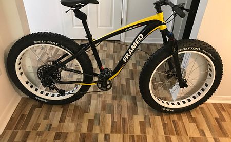

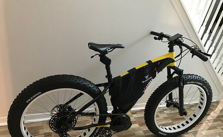

Framed Alaskan 26”
17” frame
Fat bike
BBSHD 46t (42t Lekkie being shipped)
Lekkie buzz bars 160mm with left crank offset to correct Bafang motor “Q factor”
Micah Tolls BMS 52v 14s 30amp continuous
Tesla Model 3 cells - 0.1mm copper 0.2mm nickel Kwelder
Moosetreks triangle bag
52v nominal 25ah 1.26kw
