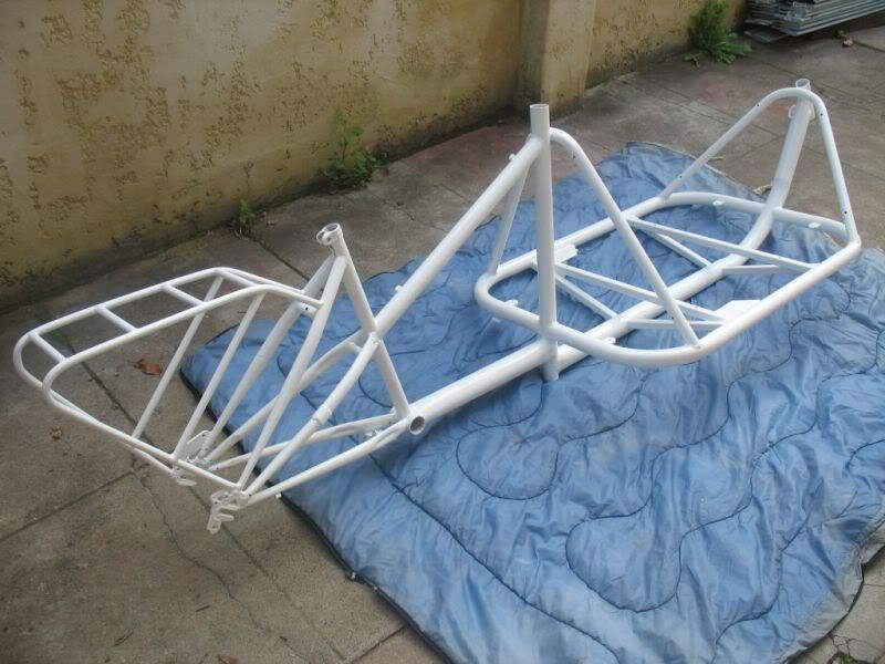

In the last week I have made some good progress with the frame fabrication, it is basically finished apart from the steering and the stand.
The frame feels very strong and not too heavy.
Here are the latest photos.

I purchased a sheet of 12mm marine ply and cut the deck sheet out.
I had to modify the front forks, these are BMX forks that had huge 14mm axle slots and I need 9mm for my axle.
I filled the slots then re cut them and added some retaining blocks for extra safety.
I also had to make and attach disc brake caliper mounts on the front and rear.
In this photo you can also see some panel beating on the rear stays that allows a 203mm disc to fit.
Note the black 12 turn Mac from the awesome vendor CellMan.

Since the last update I have made the double kickstand, rear rack and front box.
I did a rough install of the electrics and did some test rides and everything seems to work, powder coating is next and the final stain and oil of the box is needed.
The bike rides great and the kids loved it.
Hi, me planning to build one as well. What was the head tube angle you went for? What is overall length of the bike? So far i came out at 2.6meters and thought it might be too long?
This bike is 2.7m long and the head tube angle is 22deg from vertical.

Hey Kim, I'm going for a white frame, black wheels etc and dark stained box, like this one, http://cetmacargo.com/sa5.5.jpg
