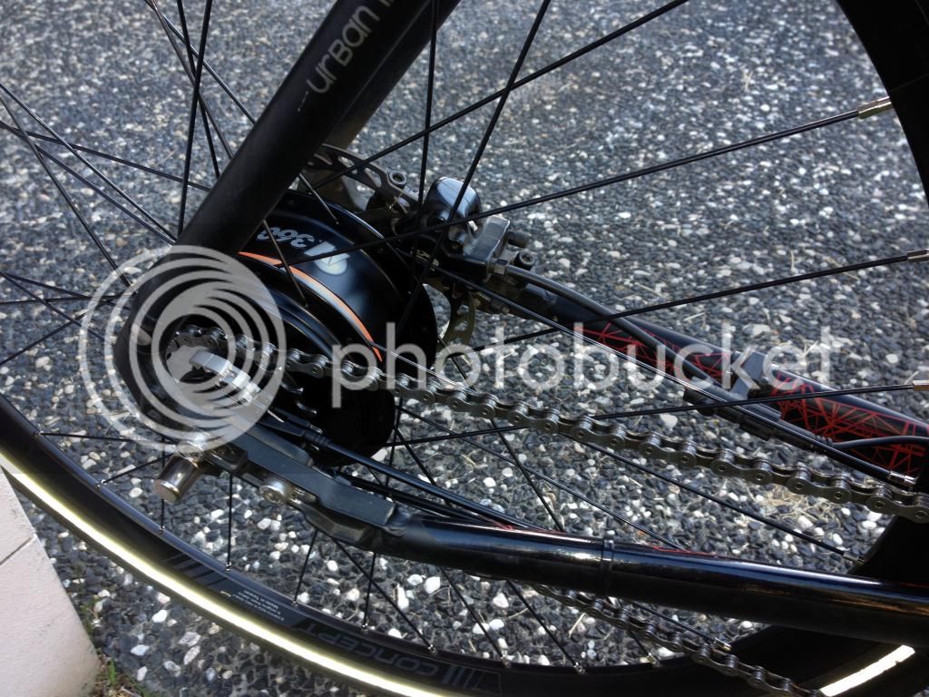

Hi all,
I have been commuting regularly on my Focus equipped with a BBS02 750w.
This original bike had an Alfine 8 IGH which has served me well for about 5000km.
However it has always not been quite right given that it can not change under load which meant a pedal stop or throttle dead band to change, both work fine but everyday commuting it does become a pain. After a couple of slipped gears under high load it was enough that I lost confidence as was reluctant to stand up a crank for the steeper hills.

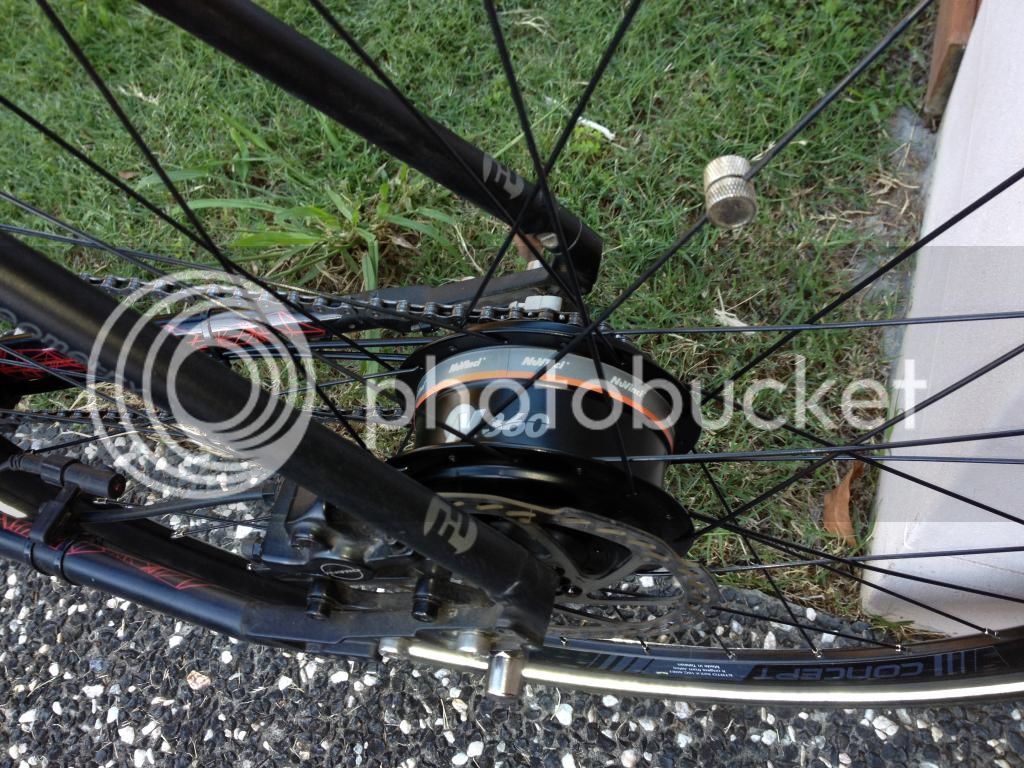

After finding out as much as I could about the Nuvinci 360, I now have this all set up and after a few test rides its ready for real commuting.
I chose to do this change over myself as I have never built my own wheel and I thought it would be a nice challenge plus I am on holidays so there is no urgency.
All up I had to change change quite a few things to get it set up ready to go.
Nuvinci 360 hub
New spokes
44T chain ring to correct the gearing for the Nuvinci
20T sprocket rather that the 18T that the hub came with.
New full length cable outers.
New chain

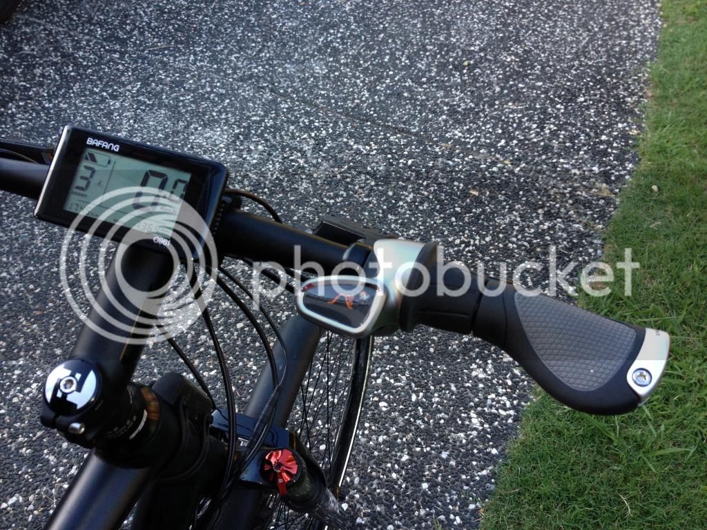

New grips to work with the different shifter
I also took the opportunity to remove the throttle altogether as I should no no longer need it.
Test rides feel good with the hub shifting easily under load however you do notice that the shift does get heavier the more you load it. That said it is when shifting up so not really an issue as generally when its loaded you are shifting down. I haven't managed to get it to slip or even give me a hint that it might.
Only time will tell how it goes with long term use but hopefully it will be the answer, it does at the moment feel like its the perfect match for a moderate powered mid drive.
I will follow up with my finding after I have a good amount of K's on it, for anyone else considering trying a Nuvinci 360.

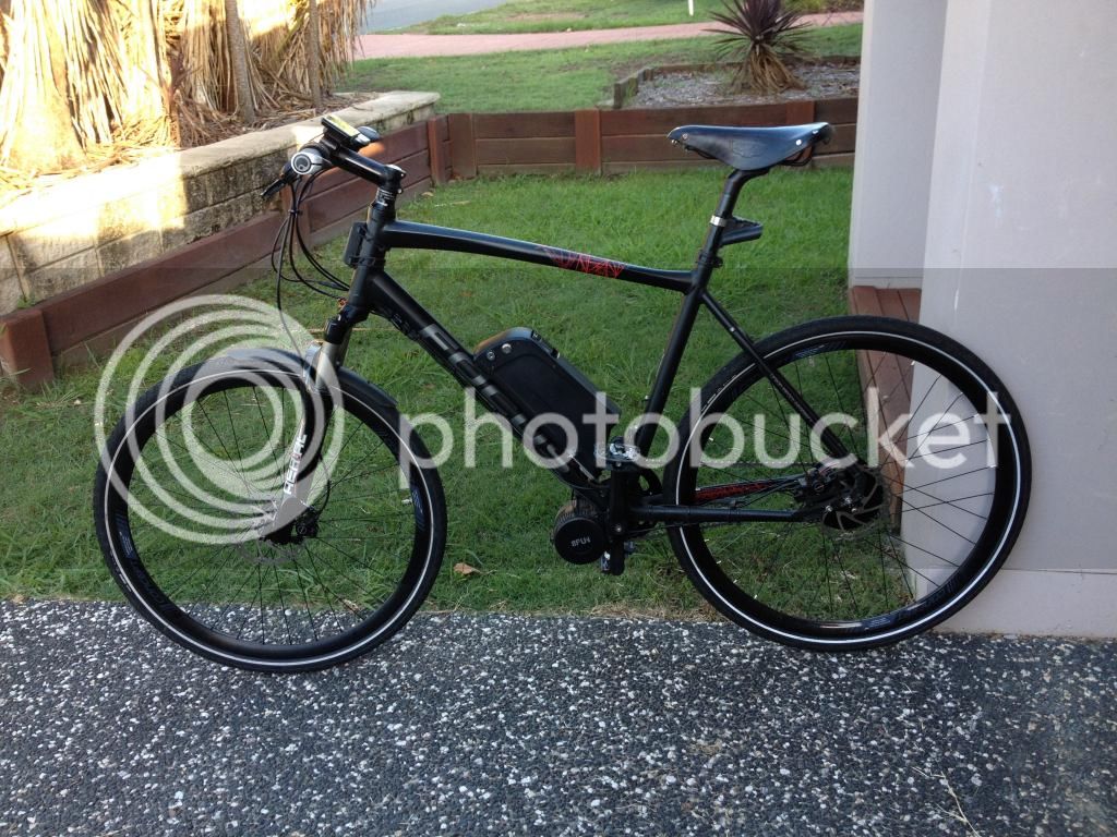

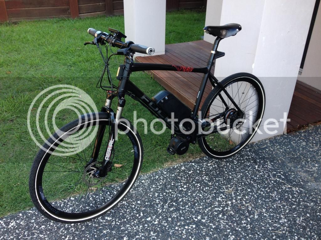

These are the pics of my bike.
cheers
Now that's a clean and tidy looking bike/installation. Congrats!
Very much interested in how the Nuvinci 360 works for you. So the Alfine never worked out?

I did over 5000 km with the Alfine so it does the job, the 2 problems with it are that it will not gear change with even a moderate amount of power.It will just grind until the power cuts then slip into gear. Also I had it slip out of gear a few times and never trusted it to stand on the pedals always had it in the back of my mind that it might slip.
So far so good with the Nuvinci but time will tell.

Very stealthy bike

The Alfine will do the job but you need to set up an electronic clutch, I used my throttle on my left hand and used the software to program it to just kill the power. There is less lag than using the bake cut off but there is still some. The other option is to just stop pedalling to change gear. On the plus side you can just change gears at full stop.
I'm pretty confidant that the Nuvinci will be the best set up but yes they are expensive. I had no problem with the wheel build, I used and online spoke length calculator and had the front wheel to copy the spoke pattern plus online guides. I also bought a cheap dial indicator to help true the wheel.
One thing I will say is starting from the lights with the nuvinci is a joy, just smooth acceleration.

Good luck with your install it is fairly easy but read the instructions carefully on the cable setup before you cut them to length. I got mine back to front and had to redo them luckily there was enough length to do so.
Mine did not come with the outer cable sleave so you might have to get that seperate. Also put some superglue on the cable before you cut to stop them fraying as you can not crimp on cable ends with the way it is set up.

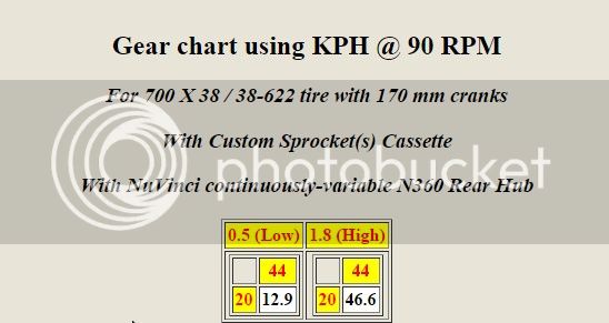

I am running a 20T sprocket and 44T chainring which is good for about 45-50 kph
I haven't noticed a top speed reduction, in fact the opposite. To be fair though the gearing span is grater with the Nuvinci 360% compared to the Alfine 307%. I geared it so that most of the extra range is on the low side but it still has slightly more top than the Alfine.
I have noticed that it feels lighter on the legs but that could be the 44T chainring instead of the 48T or just the fact that you can adjust it to the right load.

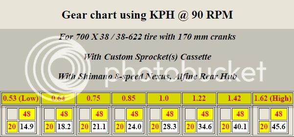

This is the gearing I had on the Alfine compared to the Nuvinci
Still I don't believe for a second that it is as efficient as a derailluer maybe close to an IGH though, at the end of the day for a 24kg electric bike the small amount of efficiency loss to me is not a big deal. Loosing a few more kilos of my mid section should more than make up for it.
