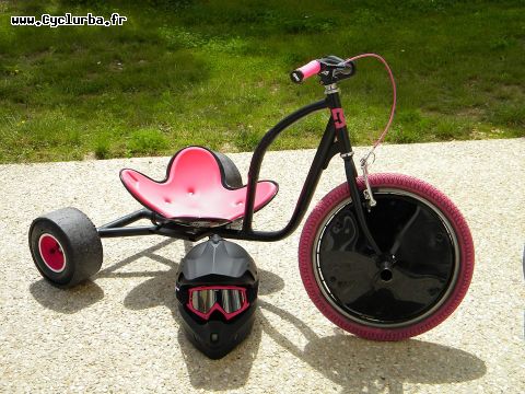

OK I think its time to start a build blog...
First, this is a project I wanted to take on, to learn more about electric vehicles / bikes and challenge my mechanical engineering abilities. (Super glad I found this forum!) So one of the goals is to do as much as possible myself, with-in reason, and sense I'm not out to bankrupt my family I also want to keep it economical...
When picking out a project I originally thought I would restore/rebuild my Grandfather's old 1950's go kart and convert it to electric. Then I came across this video...
[youtube]ZSXAEPdABtU[/youtube]
And a flood of memories of racing my brother down the cul-de-sac hill, avoiding certain death, skidding on a rickety plastic toy, and I thought, I MUST BUILD THIS!
So I borrowed my Mom's MIG welder and started sourcing a 20" BMX frame with the idea i wanted to build EVERYTHING from scratch. (Sadly I just junked my old childhood Challenger frame a few months ago) But after pricing out forks, wheels and a free wheel hub (I really want to keep the "Big Wheel" pedals) I found an open box Triad Notorious drift trike on Amazon for a screaming deal. So I pulled the trigger and was committed...
So here is what I've (mostly) decided for the project.
While the "All wheel drive" in the title is technically true its a bit misleading. I really want to keep the feel of a big wheel so the front will be pedal power and then plan is to drive the back wheels with the motor. I considered a front HUB motor but feel putting the power to the rear slicks will give a better "power-drift" experience. (It also forces me to use the welder :wink
[pre]
=== Electronics ===
Motor: QS 1000w 90 [peak ~4-5kW]
Controller: VOTOL EM 50
Battery: Custom 12s5p pack (Samsung 30Q) [later upgrade to 15-18s]
=== Mechanical ===
- 1" Aluminum axle [36" long]
- FYH RABP1 racing oil filled bearings
- 1/4" Steel bearing hanger and motor mount base
- 11x8.5x6 Burris slick racing tires
- 10x6 DWT aluminum wheels
- Aluminum 3 hole wheel hub
- Sprocket/Chain/Belt drive is TBD
[/pre]
More to come...
