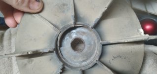

This one was relatively easy, though Jelly is a bit critical:
It's a brushed permanent magnet motor, so it works just as well on DC as AC. (it even uses a large full-wave bridge rectifier between the switch and the motor...I didn't bypass that solely because I left this whole thing setup so it can still easily be used with an AC cord as well, just in case).
I checked the pictures I could find of exploded views and such, and it looked like there would be plenty of room inside for a battery...even for a 28s1p EIG NMC pack, the same size as I use in the SB Cruiser trike (but a different configuration, as that is 14s2p). Unfortunately I don't have 1p busbars or enough ring terminals to make a 28s1p, only 2p busbars, so my only easy option was to use two 14s2p packs in series, for 116vDC full, 104V nominal, to run this nominally 115VAC-powered mower.
I considered unscrewing the top cover to put the packs inside, but there didn't seem to be enough room for two, though probably would be for one. It wouldn't run well enough on one (tested easily enough with an extension cord connected to the anderson SB50 on one pack) so two it would have to be. The whole deck is one big shell made of two halves, and taking that apart is not quite as easy as just unscrewing a cover, so I opted for cutting the top open instead, from just behind the motor to the very back wall above the bag cover. If I ever have to reclose that, it's not too difficult to make a new cover (I messed it up cutting it off, so it's not easy to simply reattach).
This leaves a space more than large enough for a single 28 cell pack laying with it's largest dimension down, or two stacked on top of each other that way...but it's difficult to get my hands in there to lift it back out, without putting handles on the pack, so I opted for putting one inside vertically instead, and then laying the other horizontally on top of it, and then cargo-strapping it down from the wheel wells on either side, for the initial test. I used the plastic cover piece between the strap and the pack to reduce stress on the pack itself.
It's a temporary arrangement for this test, but it worked fine and would probably work to do this each time I need to use it, and may not be worth any extra work to improve the mounting. (I'd guess a few hours to box in the area or otherwise modify it so I can get packs stacked horizontally out of there).
I only had one pack built up as a spare for SB Cruiser, so I used most of my remaining spare cells and 2p busbars to make a second one. I built it like the others, so it will also be a drop-in replacement for SB Cruiser in case it should be needed, as it won't be used on the mower very often (few times a year, typically--there's only enough grass to use a string trimmer on patches around trees most of the time, except after our few "rainy seasons" when we get a lot all at once, then nothing...rest of the time the dogs trample what grass does try to grow). Building this took about 3 or 4 hours, I'd guess, mostly trying to get my hands to not drop the screws and washers for the busbars down onto busbars or between them (which is generally bad :bolt: :flame: :kff: ). I picked cells that were all within a few hundredths of a volt of each other, and paralleled pairs that were different in opposite ways, to even it out where necessary. I forgot to take pics of the building process, but it's just stacking the cells and screwing down busbars to them. Easy peasy, which is why I like these cells so much. :)
After that, it was just charging the packs up, also easy using a Meanwell HLG600H-54A just like I use on SB Cruiser. I'd charged up the already built pack (left at storage voltage) while building the new one, and then topped off the new one once completed while figuring out the seriesing and connection to the AC plug on the mower.
That was simple enough, but complicated slightly by needing to leave the packs as ready-to-use drop-ins for SBC, so I couldn't simply directly wire them in series, bolted together, which would be the most efficient way to do it. That would also require putting one pack in, then the other, then bolting the wiring together, because I can't lift more than one at a time safely. So I used a jumper SB50 between the + of one pack's SB50 and the - of the other, and then wired just one wire from each of two other SB50 shells (+ on one, - on the other) to a round female AC plug that would fit into the hole / jack on the mower's AC inlet. Then each of those shells was plugged into the open contact of each of the packs' SB50s.
An old Turnigy Watt Meter was used on just one pack to monitor current draw, etc., since it can't handle the series voltage of both. So all the volts and watts on it's readings are half of what were really seen. The idle current of just blade spinning is around 2A, and average mowing regular grass is about 4-6A. High spots and thick spots went way up.

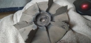

One thing to note is that since I wasn't using at least 50-100 feet (sometimes more for the street side outside the yard, nearing the alley) of extension cords on AC power, the mower didn't bog down like it would on those, and the wiring didnt' heat up at all. The bogging down usually slows me down quite a bit, sometimes adding an hour or more to the mowing, as I have to back off and go back in, etc. Not having to do that saved at least that much time. But the best part was not having the cord to tie me down and make me have to backtrack around all the trees, etc., or wind up the cords and move them and redeploy for front vs back vs sides vs sidewalk, etc.--all of which can take me at least another hour or two just to do, not coutning the mowing. So instead of taking half to an entire day to do, I think it only took about two hours to mow everything once I got started. :thumb:
If it just didnt' weigh so much, and stick up so high out of the casing, it would be much better.
Now I just have to do something for the string trimmer, which is a big Ryobi 137r (IIRC), that also runs on mains AC. I think a large-wheeled battery cart with a few feet of cord is probably the answer there. Has to be large wheels (like BMX 20" or so) so it easily rolls around on the uneven yard, etc., but the cart itself will need to be small and easy to pull (maybe something that hooks to a belt around me, so I have hands free to hold the trimmer). I'd rather have a more portable solution, but even just a 28s1p pack would still weigh 35lbs+, and I can't carry that around even in a backpack, and still do the trimming. Maybe if I can use a 14s1p pack, I could do *that* in a backpack. The trimmer has a switch on it that I almost always have in "turtle mode", which places a large diode in series with the power to the motor from the AC plug. That means it is running on half voltage anyway, so 14s may work well enough. I'll have to try it the next day off I have when it is still cool enough to do yard work. (these days, in summer I have to do it at night, or before dawn).

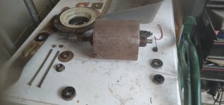

While I was finishing the front yard, I accidentally mowed over one of the drip-watering tips because i was (as usual) too tired to keep good control over my movements. Since the water was on at the time (for the first time since winter started) there was sufficient pressure to fountain up and over quite a ways...it was far past the mower, so I hobbled away to go turn off the water which took a few minutes, and by the time I came back i found that the fountain must have lost enough pressure (probably right after I turned away) to drown the mower...which is powered by my two spare EIG packs, that are just the cells in their trays and no cases, and no cover on the mower, since it lives in a shed and doesn't get used in the rain, etc. and thus doesn't need one.

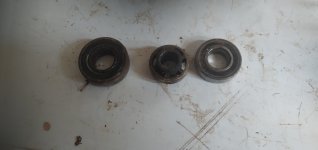

So the next few hours were spent disassembling both packs down to the bare cells, to be sure no water got into any of the trays (this will cause galvanic corrosion as happened with one cell some years back when I was riding home thru flashflood waters well over the base of the battery area in the trike, and I did not get it dried out quickly enough).
It takes a long time to work on these, because there are four clamping screws on each cell, two on each tab, and there's two parallel cells in each of the 14 series groups, so that's 4 x 2 x 14 = 112 screws per pack, which are tiny allen-head types and are over an inch long each, with a minimum of half an inch of engaged thread fed thru the captive nuts in the trays. That doesn't count the two short screws at the bottom of each cell tray securing it to the metal plate across the bottom of the pack.

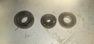

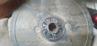

I was lucky in that it was only in the very end cell of one pack, and just at the edges, and a few end cells (all the same end) of the other pack, again only at the edges.
So i wiped them off and set them up to dry out in the stiff breezes still going on at sunset.
By the time I was sure they'd all be dry, I was way too tired to trust myself to reassembled them, so I set them in stacks in their original order in a safe place, with all the interconnects and screws and cabling for each next to the cell stack for that pack.
Even this was too much, as I dropped one cell onto another while stacking them, and destroyed it by ripping the outer jacket wide open, a triangle about an inch long and nearly that wide. :( I have spare cells in a few different voltage levels (I left them at the voltages they came to me at, however many years ago that was, and they're still at those voltages), so I picked the closest voltage 3.62v to the 3.65v the cells of that pack were at. (the cells of the other pack were at 3.62v, so of course it wasn't one of those that was damaged, and I'll have to manually charge the new one up to 3.65v before I bulk charge the packs again). To be sure i know which one was changed, for tracking over time, I put some tape "tabs" on either side of it, making it obvious in the stack which one it is.
This pack is the one I had swapped out of the trike to try one of the spares over winter to see if it worked better in the cold (it didn't; they're all just old)...I think when I get these reassembled, I'll put the other spare in the trike to test it out.
I taped the torn pouch and put it away in the "cell safe" (steel cabinet in one of the sheds) for later testing / tracking / etc., I won't be using it on the trike but perhaps it could see some outdoor-only usage if it remains operational and doesn't exhibit progressive failure / etc from the pouch tear.
The repalcement cell is from a different batch; even the printing method is a bit different. (the damaged cell can be distinguished by the tape on it's surface, though you can't see the tear in the image).
As a note, all the connections / tabs / etc were nice and shiny at their contact areas, *except* for one cell (of the pair) on the end of that pack (the one out of the trike), where there's obvious discoloration of the cell tab contact surface from some form of oxidation (black), as well as some obvious copper corrosion (green) on an edge. The tabs appear to be copper or a copper alloy, and the busbars are brass. There is matching corrosion on one of the two clamping nuts of that corroded contact.

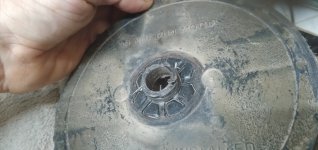

When disassembling the first (driest) pack, I found a LOT of dust and dirt in the trays for each cell, that had gotten into the "blocked off" pouch area, because this pack wasn't built with the bottom plate, just strapped together with gorilla tape, and that wasn't apparently done tightly enough to keep stuff flung up by the mower out from between the cell trays. (the other pack with the plate at the base, and gorilla tape and busbars securing the other end of the cells, did not have dust or dirt between them, but it had also not been used on the mower nearly as long or as much; I'll have to open up the pack presently on the trike once swapped out for the third pack to see how much dirt is inside it and clean it out. I don't remember if it has the base plate or not).
Some of the tray covers have signs of corrosion on them on the outside, but not on the inside, and not on the pouches themselves. So humidity or water has intruded on some previous occasion between the plastic of one tray and hte cover of the next in these cases, but didn't get into the actual cell area.

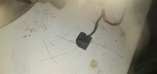

One cell has a damaged tab; appears to be arc damage at the screw hole, but there's no corresponding damage to the busbar or the screw that was in that spot, so it probably happened before it was assembled into this pack.

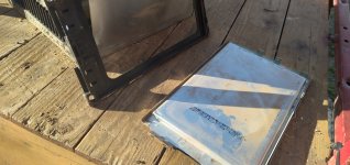

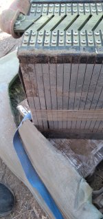

Well, it has taken me until the last several days to be able to reassemble them and recharge them; other than rebalancing the replacement cell to the rest of them, they're all still identical voltages (the replacement will probably act differently than the ohters, as it has been unused all these years while they have all been cycled, but I don't expect it will be much different).,
Some pics of the reassembly (didn't take as many as I'd intended to by far, kept forgetting to take them as I went.), also showing some parts I'm not using (like the bars intended to parallel two of these 2p packs), and adding threads to some long bolts to provide support and compression of the top end of the pack where the busbars are (teh bottom is secured with plates screwed to the bottom of each cell holder). Previously I had used gorilla tape and clear packing tape to secure the packs together, but I did not have enough to do them that way this time, and since that was only meant to be a temporary experiment at the time while I actually worked out the bolts/plates to do the securing properly, I just went ahead and did that.... (only took me several years to get around to it :oops: )
And yes, the metal plate on the bottom of the one pack is not continuous, I am saving the one full-length one I have for a higher voltage pack I would like to try out with the Phaserunners on the SB Cruiser trike. So i used one shorter one i had, and a piece from cutting one long plate down for the other pack. I have another short plate that will bolt over the two of these to connect them together, so the plate will secure teh whole pack at the base..
Last night I recharged them, and need to test them (by mowing the yards) tomorrow and/or monday. (only thing tested so far was balance at the mid-charge level, and at "full", which for my purposes is about 90% of their full voltage on their SoC curve, about 4v/cell IIRC).
