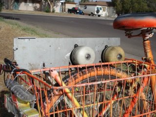

I just took a rackmount front panel blank and cut holes big enough for the pair of Toyota radiator fan motors (radial brushed) I had gotten from a junkyard, to fit thru it and line up with the rear wheel.
The batteries went in the rear rack. I shoudl've moved them forward, but that didn't happen till a lot later. They're just 12V12Ah SLA, used, from either a scooter or a UPS, I can't remmeber which. The 7Ah in the forward left basket corner is my lighting battery.

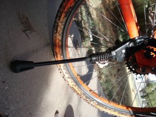

Dunno if you can tell, but that poor little kickstand is curving from the weight on it, which wasn't that much yet.
I used the controller out of a ScootNGo I'd gotten as a carcass. The controller had blown FETs and a melted relay, and the board was burned so bad I had to mount the replacement FETs externally.
Tension was controlled by a lever-type shifter pulling down on the rear end of the rack plate, with it's pivot being one of the rack mounting tab notches hooked into the front edge of the basket. No, it wasn't very good or stable.
I left the plastic hubs of the fans on, just cutting off the blades and roughening the surfaces a lot (it wasn't enough).

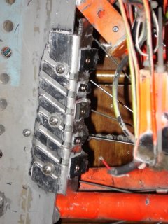

Then I blew up some (a lot, actually) MOSFETs, not surprising since I salvaged all of them from various old UPSs, motherboards, and so on, and I don't think I even checked the specs on most before throwing them on there.

This is the replacement stand, which worked better, but not for very long. I'm just glad it was a donation and not out of my pocket.
The plastic you see above the spring is surrounding a VERY thin aluminum tube that's riveted up at that silver rivet head for a pivot. The plastic cracked and then the aluminum just sheared thru, after not a lot of use but with lots of heavy groceries/etc.

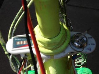

Since I had them, I used the scooter's power meter and keylock.
as well as it's turn signal switch and horn button. The horn sucked so I took it off. It wasn't loud enough to help but was annoying to me.
Also visible is the red-cabled tension adjuster for the drive.

Changed to some 123A 100V MOSFETS actually intended for stuff like this, instead of the wimpy ones I'd salvaged before. Mounted them to a nifty heatsink out of a donated fried car audio amp. Mounted that to the main motor mount panel, in a place where air from the rear wheel spinning would cool them off (along with the motors).
Controller itself bolted to the back of the plate, between the motors.

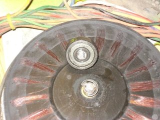

The broken motor shaft kind of made the whole thing useless, because one motor by itself was not powerful enough to help, and would quickly overheat even if I pedaled to speed first. With both motors, if I pedalled up to around 15MPH, I could then turn on the motors and get up to 30MPH on a long straight flat stretch of paved path. :) Of course, the batteries would be flat by the end of that, and it took a long long run to get there, but it did.
Under normal use, it could last for several miles as just an assist to get going and keep going, minimally, but the batteries were already used when I got them and they wore out quickly. They were down to barely working to get me to work, then requiring recharge there to get me home, when the motor shaft finally broke.
The shaft broke at the circlip groove that held the bearings out against the housing.
There isn't anything I can do to fix the motor, and I don't even know where I could get another one to match it to use with the first, as I don't know what car or truck it came from. They were already removed (still on the radiator) when I found them in the junkyard. No p/ns or anything recognizable on them that I recall, either.
As I said before, they're 4-pole brushed motors, and are ironless axial flux.
The rotor is some type of molded plastic with the coils embedded in it. The plastic must be a very high temperature type, as these things got hotter than boiling water on the OUTSIDE when I ran them really hard during tests. (pouring cold water on them turned to steam instantly).

The headlight/keyswitch/battery meter unit:
The switch actually carries the whole power of the system thru it, and has a very satsifying ker-chunk when you turn the key in it. Feels like the Honda scooter ignition lock did (except it was disintegrated electrically and this is not).
There is also a "horn" in here--it's just a piezo buzzer that beeps a single tone. It is actually funny to hear---it might get the attention of another cyclist or pedestrian, but it is not useful in any other way. No car could hear it, probably even with their windows down. ;)

First up was the motor itself, since I wanted to see if it's freewheel is easily disabled or not.
and see what the axle/stator connection was like, magnets, halls, windings, etc. First hubmotor I ever had open in my hands. :)
Looks nice and nea. No signs that 800 miles of riding it's already had have done anything to it, either.
Then I pull out the whole motor assembly from the case to see the gears:
and they look nice and neat. I didn't see any issues at all, so far, though I would need to clean the grease off to see some things; didn't want to do that just yet. The freewheel looks similar enough to the one Russell un-freewheeled that it is probably the same inside, too. I'll check it out later, after I know what it does in it's original form. :)
The inside of the casing, including the ring gear.
Closeup of ring gear

The board is quite neat, and the workmanship of adding the wires in is pretty good.
Not entirely obvious in that pic is the extra copper bar they've soldered to the top of the traces behind the MOSFETs. There is also an added wire along the trace at the right.
It's easier to see it on the bottom of the board, where they did the same thing.
The MOSFETs are not screwed down to any heatsinks. Instead that vertical thin plate attached to the top cover presses the plastic bodies so that they seat fully against the inner part of the side wall of the main case.
There is heatsink paste on the back of all of them, that appears to have all made good contact with the case so far.

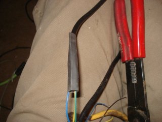

Since Hachi the borg dog (7th of 9 puppies :lol:) has been assimilating a lot of technology, it was easy to find some cables to use for inserting between controller and motor.
That used to be a PS/2 keyboard/mouse extension cable, now neatly bitten right in half. That's ok, since I needed something with at least five wires in it and a male/female connector for the hall cable. Being shielded is a bonus.
She also has done in a few regular power cords and an extension cable--fortunately none was plugged in at the time. :roll: I used one of the power cords to extend the phase wires. However, I didn't have any heatshrink small enough and didn't want to waste what little electrical tape I have left that's any good, so I found some house-AC-rated wire with insulation big enough to barely fit over the wires plus solder joints, and stripped it off in inch-and-a-half pieces.
Lap-soldered the power cord to the phase wires from the controller (braiding the strands together a little),
slipped the insulation over the connections,
placed the heatshrink over them (since this insulation could slip around, in theory, though I doubt it will),
and then a bigger piece of h/s to hold them all together.
The same thing was done for the hall wires, except only the big h/s was used, not the little per-wire pieces. Just the red stuff for per-wire. Then the same again at the other end, for the motor.
