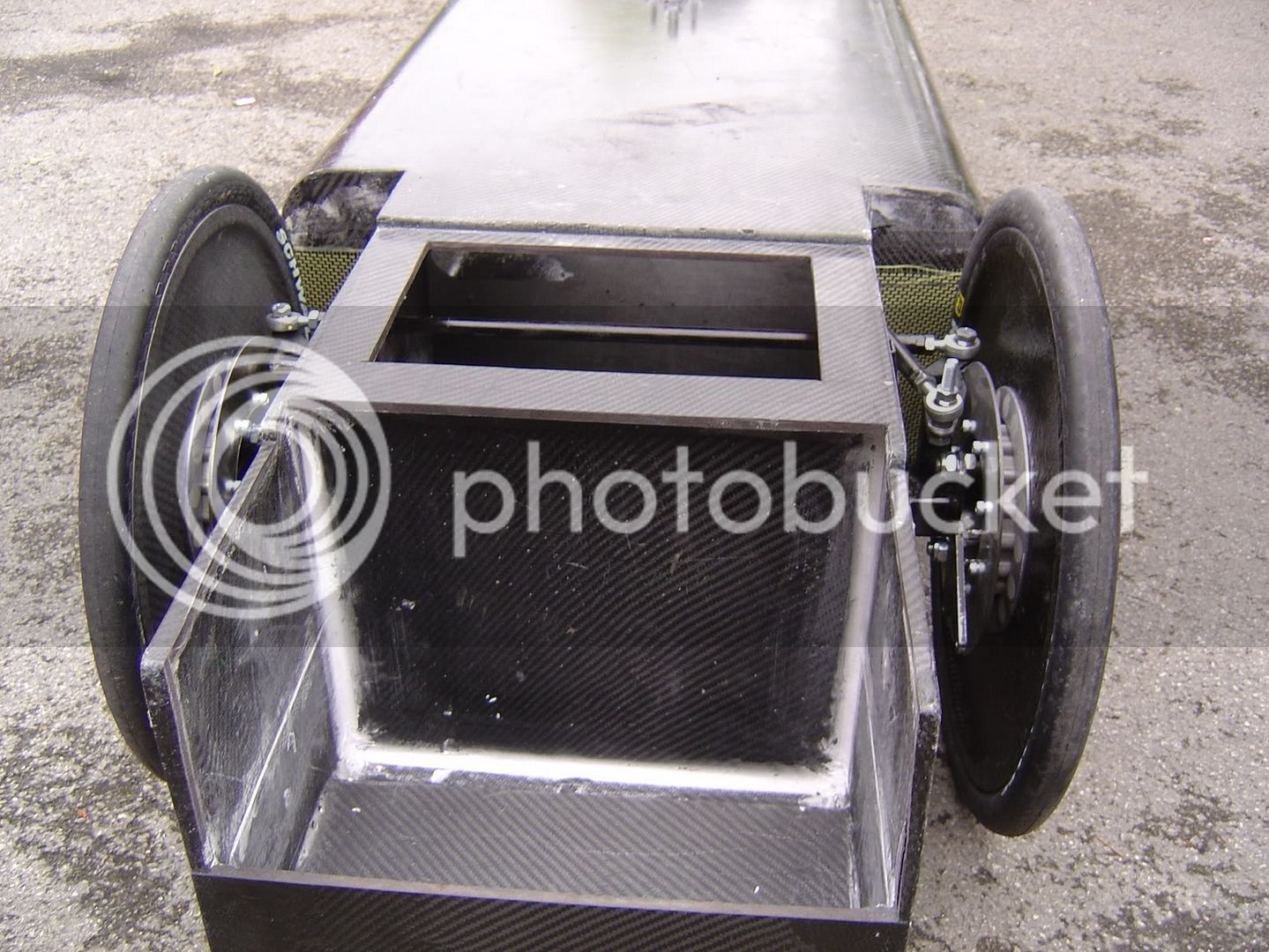

we used hub- centre steering on our last year greenpower racer. Reasons for: no body roll when steering, allows wheel change to fix punctures in a race, compact side to side. We used a single large diameter deep groove bearing (being large diameter there's no need for 2 bearings) 80/100/10 mm size. Reasons against: - just one, excessive friction compared to smaller bearings. To be competitive we had to remove the bearing seals & use oil instead of grease (BTW we've now found some thixotropic chain lube that's excellent)

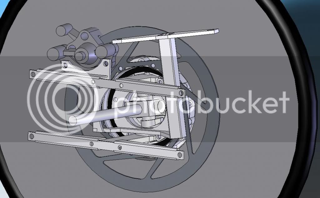

For next year's car we're using the same design adapted for front wheel drive (using steering column UJs) Here's a 3D CAD design, I've made quite a lot of the bits already...
last years car hubs
next years car hubs
Probably not much use - just the idea of using a single large diameter bearing. BTW last year's car did very well, unklucky to come 2nd in the nationals.
Thanks for the info. What width of the hub you chose? What steering angle are you getting? Perhaps you would not mind sharing few rendering without frame and brake system? I am using same bearings on my design skf 100:80:10. Do you heave a website on your car? Looks interesting to read about.
Hi the hub is just 20mm wide - the wheel is carbon fibre over foam composite - might suit you actually, it has proved its strength on some very rough tracks. We have about 25 to 27 degrees steering angle. The website is http://www.cauc-f24.org/ but there is probably lots more useful info in my greenpower photobucket album http://s543.beta.photobucket.com/user/bobc0/library/greenpower

PS last year's car steering pivot was 10mm rose joints - convenient for adjustment of track & camber & tiny bit of stiction wasn't a problem ina car. Next yr's car will steer on angular contact ball bearings because they're lower profile (need the room for the drive UJs)
PPS I didn't realise your wheel bearings were so big, you'll have the same problem as us with bearing drag; you'll half it if you just use one bearing......
This some professional work you are doing. That much of carbon fiber must cost a fortune :) Were you talking about rolling bearing? As far as i can see from the photos and drawings you have something different from center hub steering. Your steering is in the center of the wheel but this is achieved by using con caved wheel rather than steering in the center of the hub. My concern with one beating is that forces are supported by that one bearing rather than two on the two front wheel setup. I wander if using two same size rolling bearings instead of ball bearings would help on friction.

Got it - the structural foam we used is called DIAB - we happened to be given enough to make the monocoque and the wheels ;^) (the greenpower game is largely about making best use of things like this which are donated...). I think there are quite a few suitable materials, they have to be closed cell, not dissolve in expoxy resin & not collapse under vacuum.... Rohacell, Airex etc. etc. Yes we spent over £1000 on carbon fibre weave on that build. It is just SO nice to use though - here's the finished car at the national finals
It is pukka hub-centre steering, the steering pivots are inside the big bearing, some of the photobucket album pictures lower down make it a lot clearer. Also, this being a car there are significant bending forces on the wheel, yet the single bearing is perfectly adequate because the top & bottom are 90mm apart - that's as good as having 2 axle bearings 90mm apart. I really would go single bearing - it makes your hub so much smaller and lighter. Also you'll note that I separated the steering pivots (king pin) as much as possible because this has to withstand brake torque - by far the biggest repetitive stress on any bike wheel.
Have you considered how you will mount the brake caliper yet? that needs to be attatched to the steering part of the inner hub.
